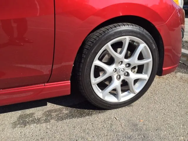

Well at 30K, I swapped my original wheels/tires for my MS3 wheels with Hankook Ventus tires on it. (previous pics)
http://www.mazdas247.com/forum/show...-and-30K-bday-PRESENT-FOR-FREE!!!!&highlight=
Car just turned 45K now.

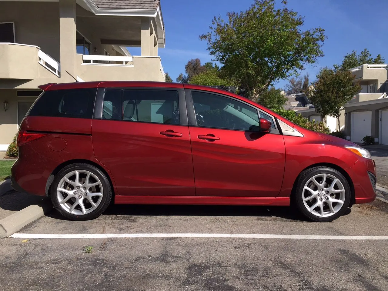

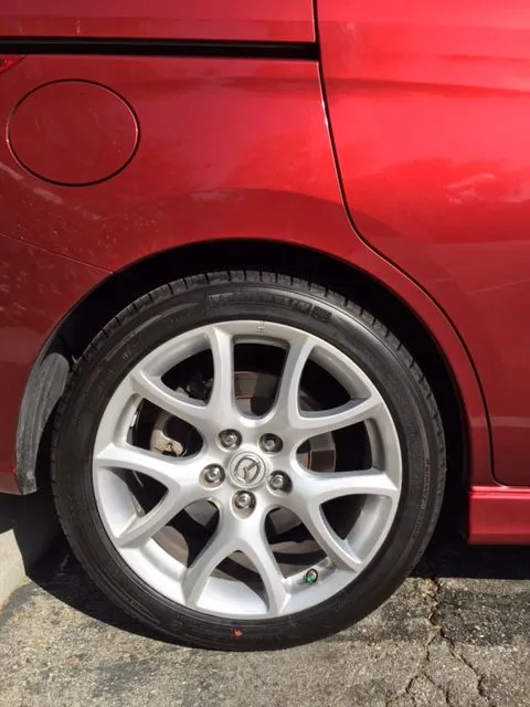

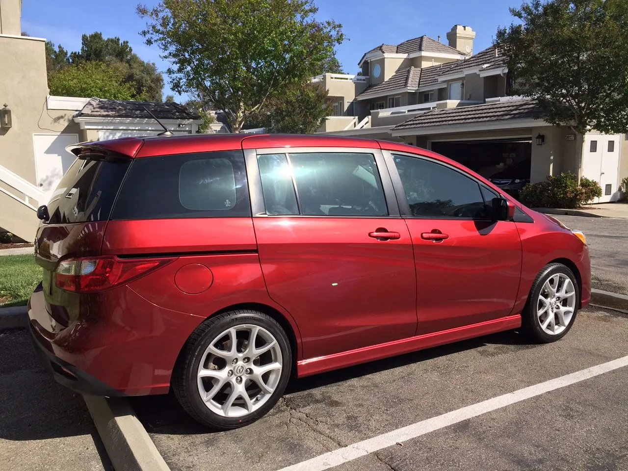

Needed new set of tires, and given the roadtrips we do it, wanted to go with more all season grand touring. Didn't need the handling of my Elise, but needed more of a cushy ride that my Lexus hybrid has.
Upsized the tires from 225/40/18 to 225/45/18
Mopho (member here) was my build inspiration. I even rode in his car and bought the lowering springs. But it will be a no go with how the wife drives. So going to return the springs
So figured some meatier tires.
So far handles great, rides great, and suits our current needs.
Car is higher by 0.9 inches, and we are happy with it.
Michelin Primacy MXM4

Had 6 people in it, for a 200 mile roundtrip, absolutely no rub.
With 4 people no rub in daily driving.
Put 550 miles since installation.
Thus the "lift" in title :)
