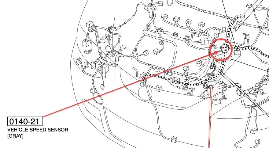

It's actually page 54 and 55 but I couldn't locate the plug/wire that I needed. That speed sensor that I thought was on the back right corner of the engine was not there, or if it was it didn't have the wires I expected coming out of it. I was looking for a B, G and W/R going into a grey plug, but just couldn't see it... for all I know it's back down on the other side of the transmission or something. Anyway, it's still work without it connected -- it just won't be as accurate.
I haven't even gotten to running that VSS wire to the engine bay yet, but I found the rubber boot on the footwell side so I'll just run a fish-wire up through it.
Otherwise, it has all been installed except for that VSS wire, the reversing camera and the video output to the Clarion rear-seat entertainment unit. All things that can wait until a warmer spring day. ;)
So has anyone ever seen this plug and can direct me to where it is on the engine?
Okay, looked a bit further into the manual and found that the VSS needs to have the battery covers and battery removed to access it. This certainly looks like it will be job to be done in the spring.

That pin is listed as unused in the North American wiring diagram. Although when I pull the radio again to make this connection I will certainly look to see if I can find a wire in this spot.
thanks for the heads-up!
Yes the speedsensor can be taken from the instrument cluster harness by inserting a pin and wire into the harness. The output signal is present at this location and there would be a wire going from that pin, to the factory GPS system if you had one. The install kit I ordered several years ago actually came with the wire and correct pin to insert to the harness at the location noted above.
