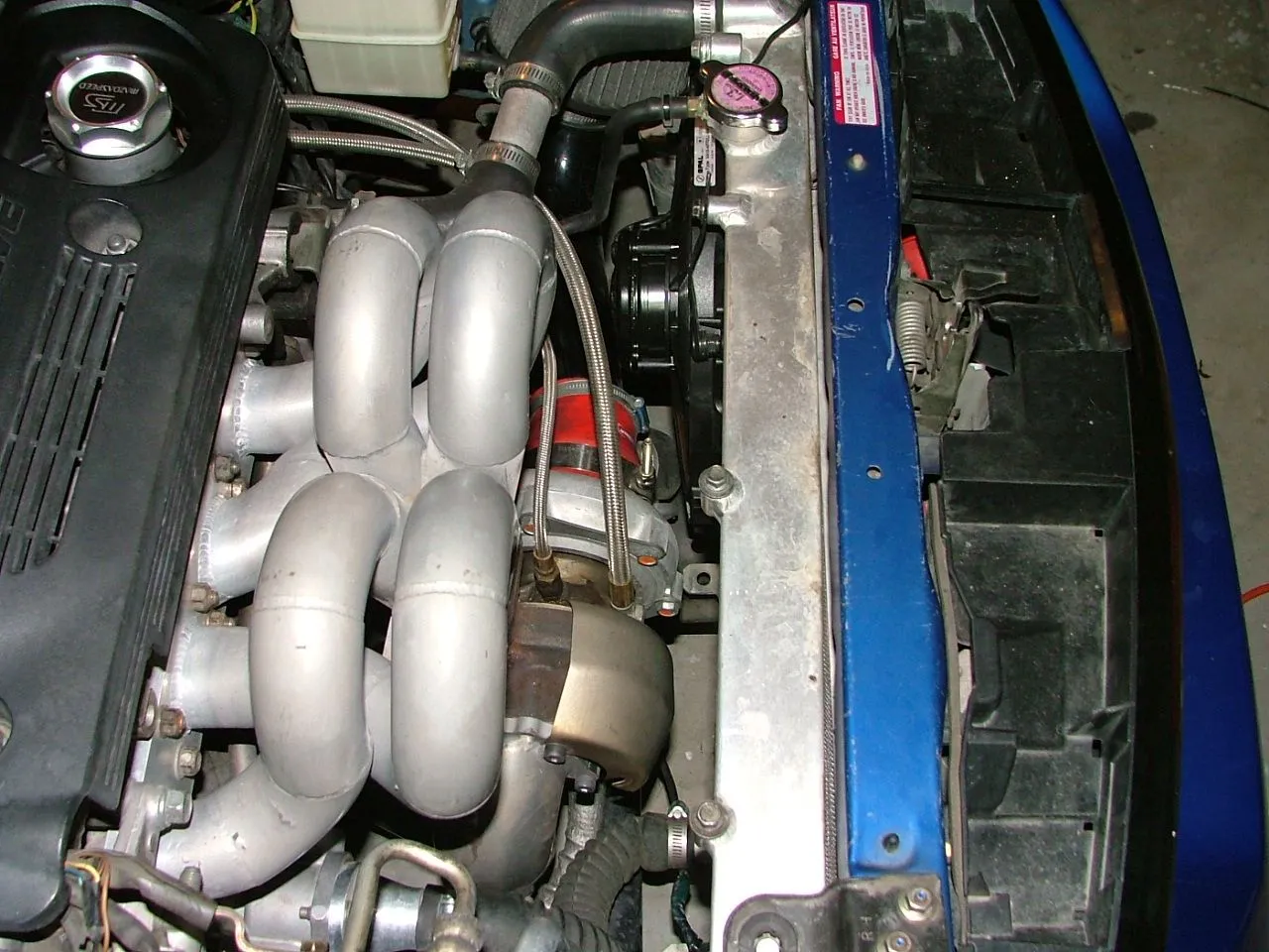

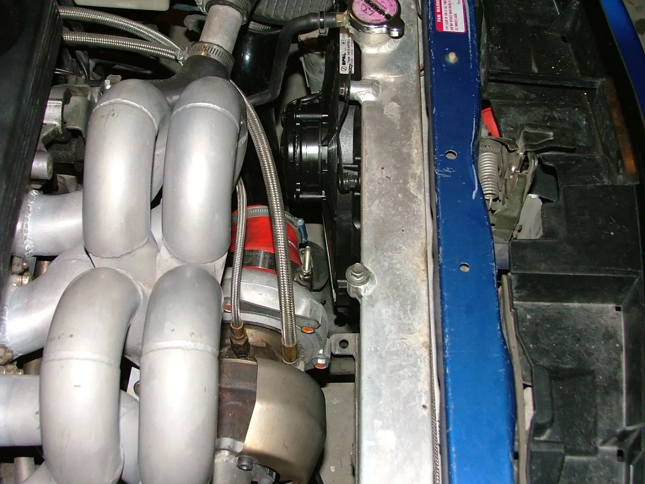

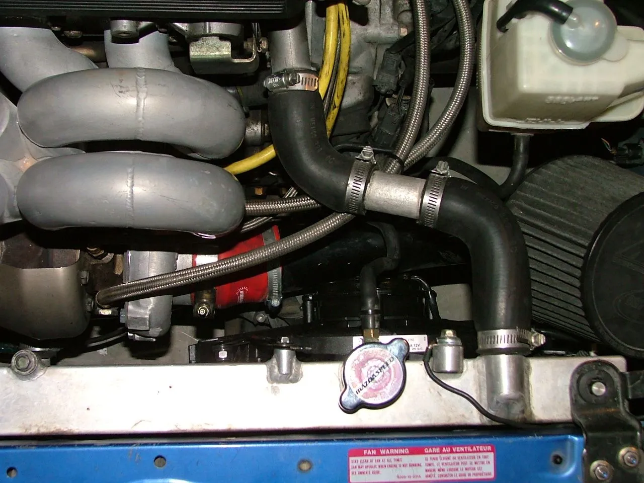

I've had an overheating issue every since I installed the MAM kit, and the FMIC. I'm determined to fix it for good, and here are a couple of things I did yesterday:
I added the MSP heat sheild to my turbo, and got a new radiator fan.
I had recently bought a SPAL 11 inch, but took that back, and exchanged it for a nice 12 inch Spal High Performance, curved blade (that sucker is 3.39 inches in depth) to replace the 12 inch Maradyne fan I had on the driver's side. Wasn't going to be able to fit the 11 incher on the passenger side with that MSP heat shield in there. I had to re-angle my intake to the turbo to fit the new fan. This sucker really blows!! 1360 CFM!! It really has made a difference. I am still in the testing phase for this fan now. I did notice last night that it came on, dropped the coolant temps, and then kicked off, all while I was parked. For the last 2 years, I had only seen this happen in the winter. I also want to relocate my Haltech water temp sensor to the water neck, rather than the radiator hose (right in front of the fan flow). Another thing I want to do is hook up the cooling fan to my Haltech E6X, and have it come on sooner.
Stoplight, idleling, traffic.
I've noticed that on mine too. I have a similar set-up to yours Pat. I had an overflow and had to change it back to the stocker thinking that maybe it was the culprit since it kept dumping it out from there. It's not the overflow because I can still smell coolant - I just can't figure out why it keeps going into the now stock overflow - other than the fans that MAM gave me are a POS. Let me know how things work out for you - I was thinking that maybe I might need to either relocate the temp. sensor or the damn thing went bad. Keep me posted!
Try a new low temp thermostat. I know you have one but yours might be going out? Also, do you have any major blockages of air flow behind the FMIC? If the AC condenser and radiator fins are bent you need to straighten them out.
