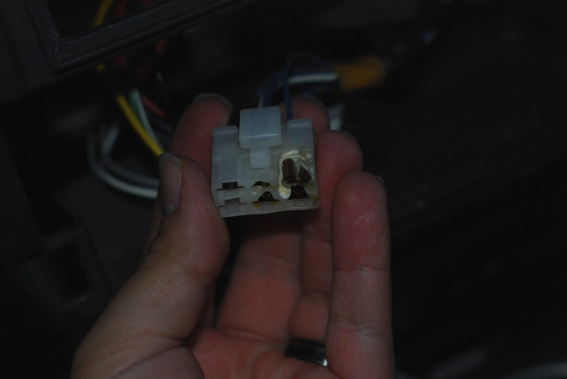

well to keep this thread going my speed plug was burnt up, i am going to look at teh wrecking yard for a similar one as i think i have seen them on some of the rx7's i have owned.
oh and Dawson, i jsut took my cd player and storage box out and was able to see the problem was my plug, do that first before taking apart your dash.

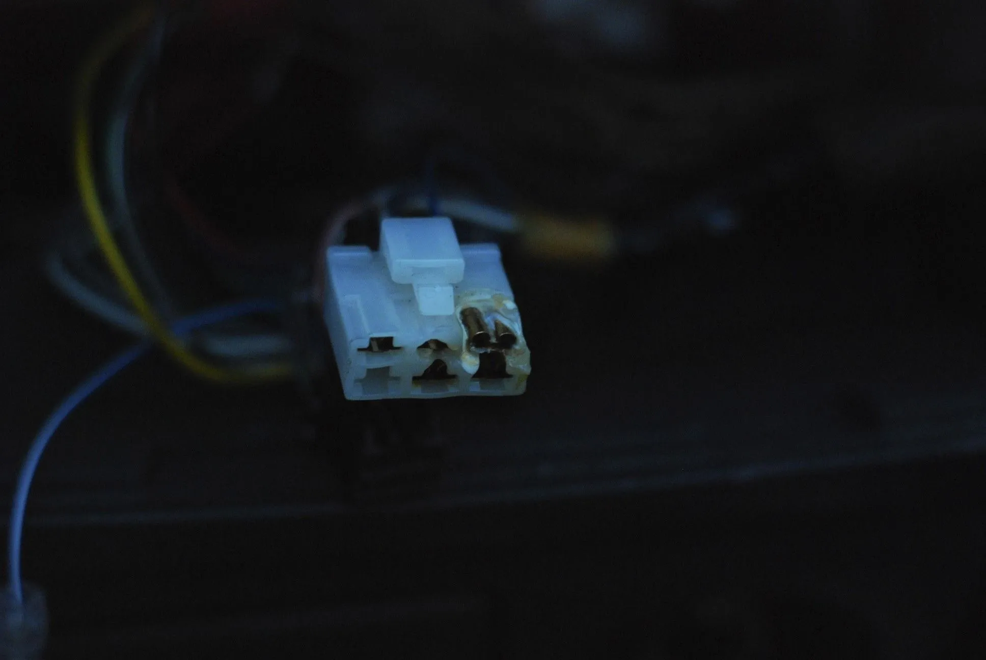

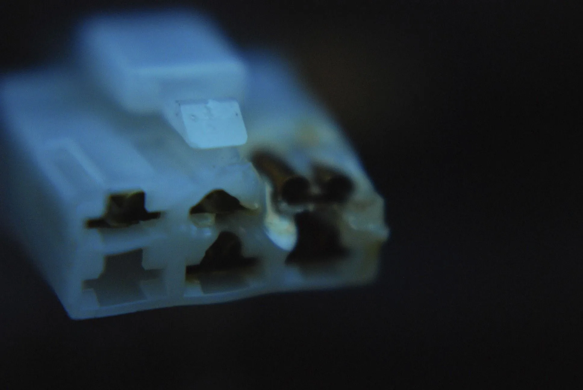

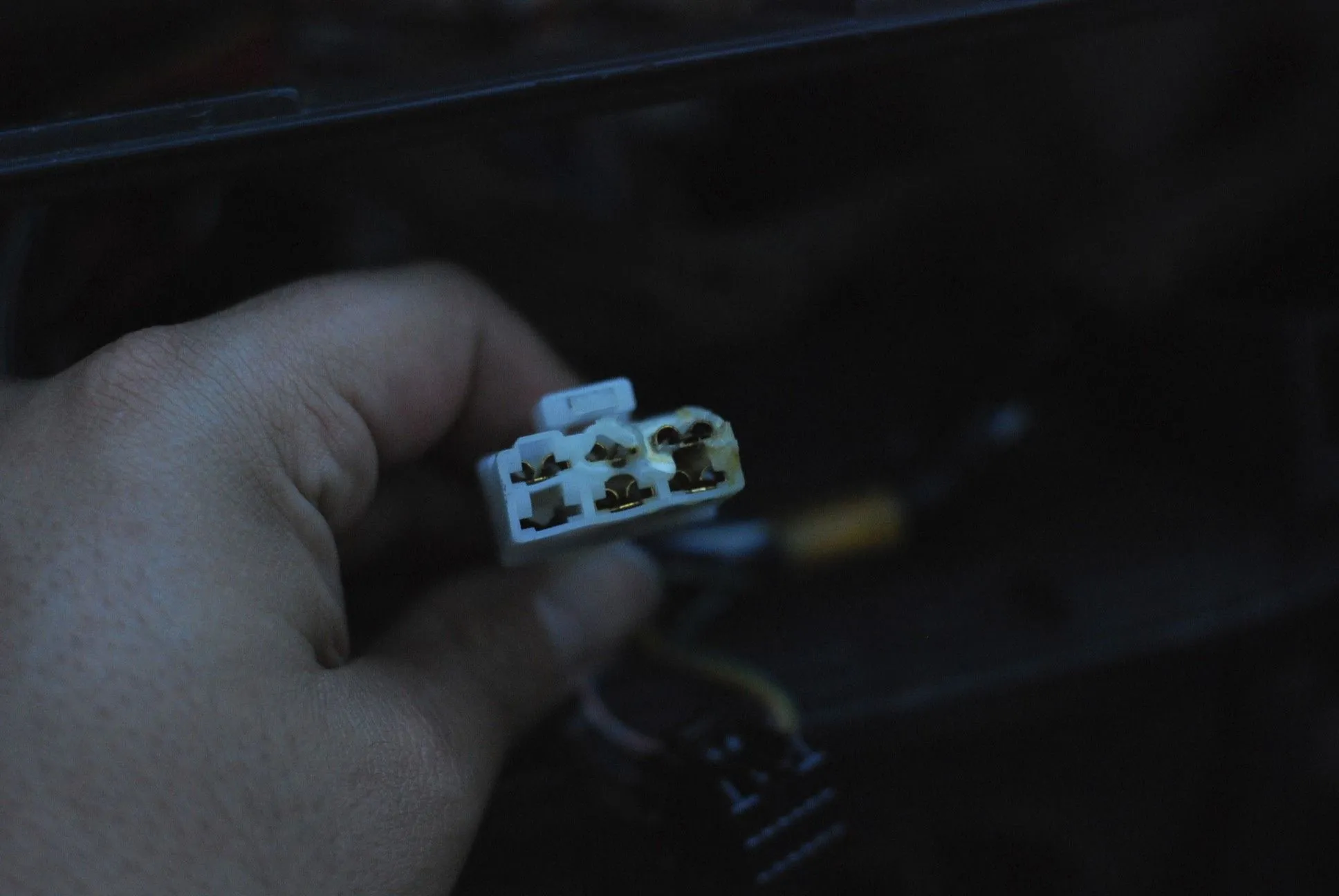

With melted connectors like that, isn't it a fire hazard? Wouldn't that warrant a recall to replace the faulty part(s)?
I had the same thing happen to mine over 5 yrs ago. I got a used a/c control unit from an 03 (car-parts.com) $35 and cut up the connector a bit to slide some teflon shrink tubing over both of the terminals to isolate them and it's been better than new ever since.
I'm sure the problem is within the a/c control unit board which may not be allowing a good ground or something causing this to happen.
