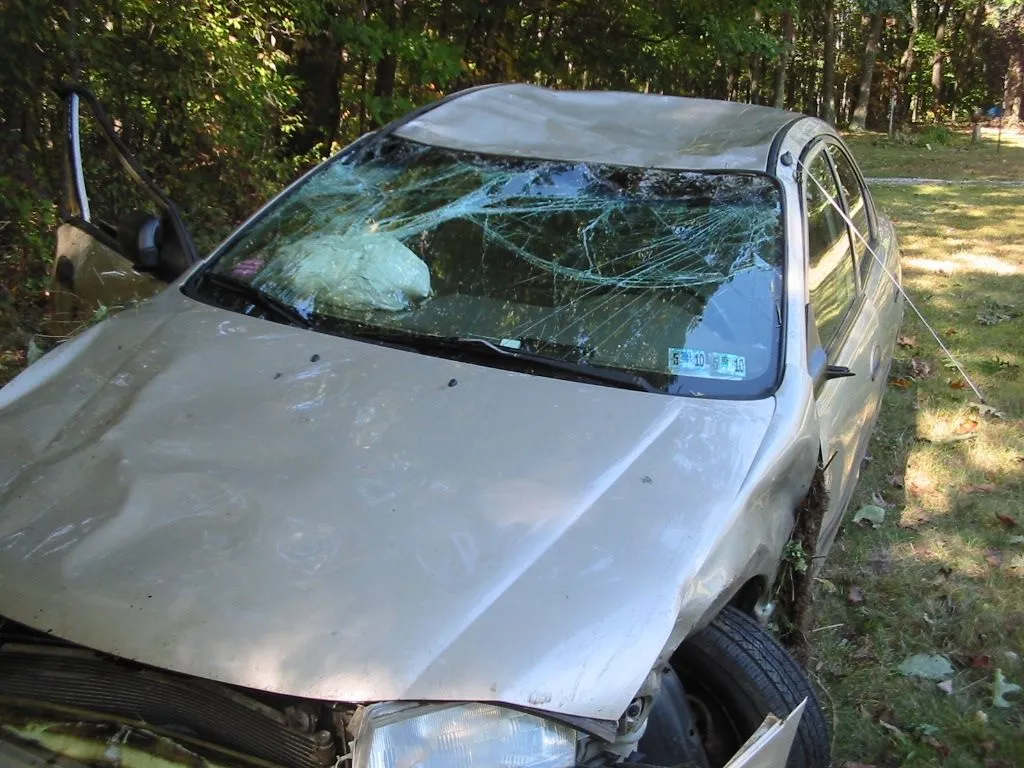

Here's a pic of the totaled car. It survived a rollover pretty well.
