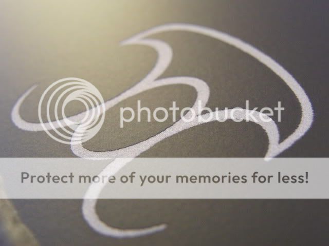

I'd love to see some up close shots of the etching and production markings. Who's good with a DSLR.
I don't have a SLR, but my new Casio takes some pretty decent macro shots. :)

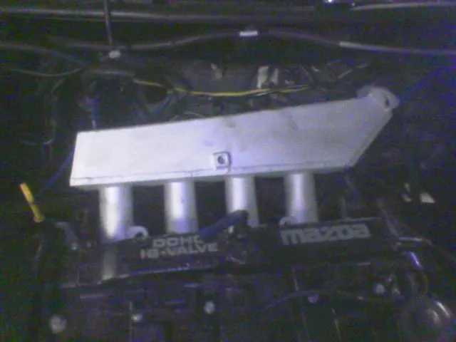

Test fitted the manifold this weekend before it was sent to the machine shop to get extra injectors welded into it.Rich the manifold looks great thanks!!
