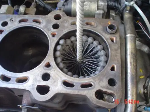

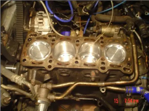

... cracked ring lands* on the stock pistons on the fourth run. Will now install forged CP 8.5:1 and bigger injectors.

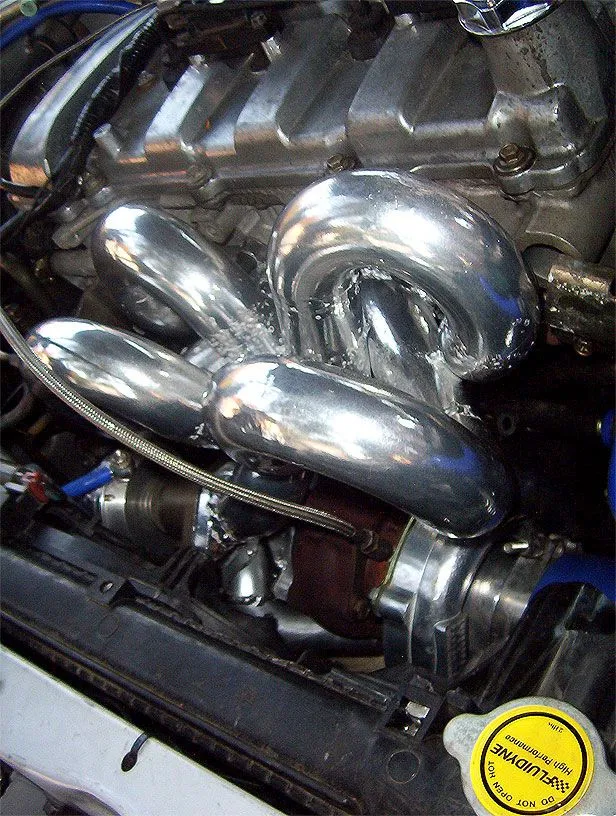

Custom cast tubular manifold
XS power 4psi spring wastegate

The P&P on the head was done by a machine shop in Caguas, PR. Pictures doesnt do justice, it looks really nice, no headflow measurements.

The boost is screwed because he's using a XS Power wastegate. Get something decent and then try to tune it. Those pistons are still stock compression, they just had the pin bore enlarged to 19mm right? With a better WG and manifold you'll see some nice numbers.

Manifold? whats wrong with it? its a cast iron full tubular.
The wastegate is cheap, but its ok, will put a stiffer spring then we will see. Even the turbo is the chinese turbocharger, but its working!

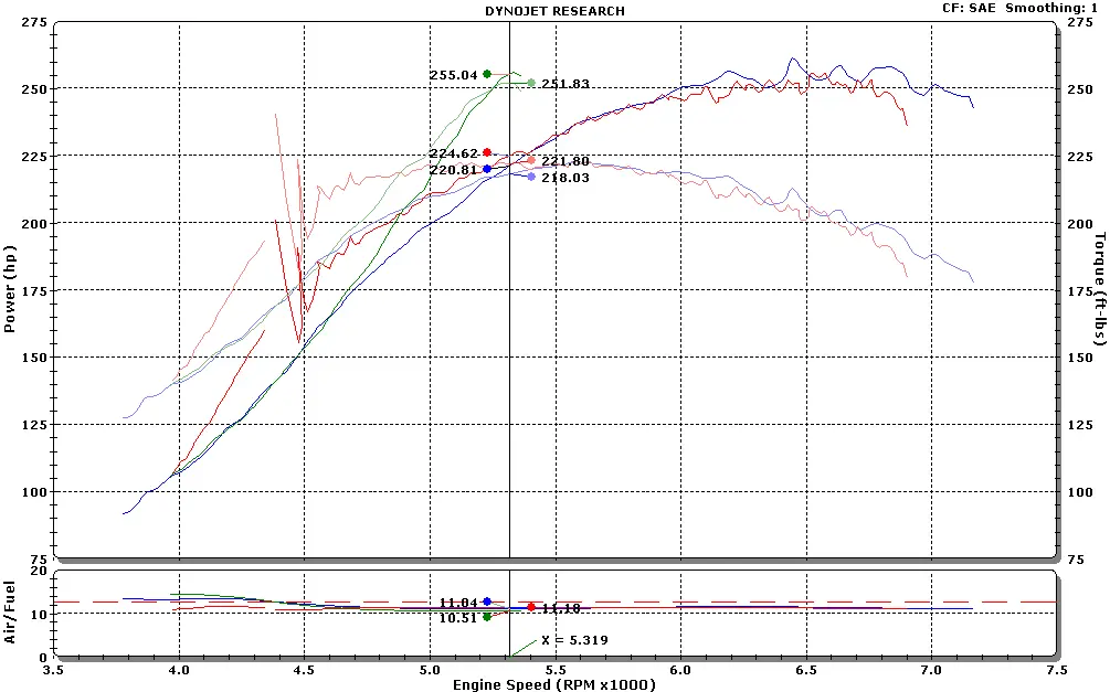

I don't see 297 hp on any of those dyno sheets? Spikes on a dyno are not caused by backfires. It looks to me like the ignition pickup for the dyno is set-up wrong.
A spike downward is usually missfire or detonation. I spike upward is feedback with the ignition pickup.
It looks to me on the red run that your peak hp is around 250 (at 75mph, of course mph is really useless) and you peak torque is around 210.
We already know that. the CTS signal is weak and shared. I dont have the 297whp because I left the dyno before he upped the boost and dynoe it. But I have the 1st dyno chart when we raised the boost and the tunner started tunning it. It only has a curve for the first few rpms and with a nice takeoff from the previous 11-12psi dyno.
It sounds right anyway, at 11-12psi it gave 263whp if i remember correctly, add 4psi with the 10hp/psi rule and will give 303whp.
Ill try to find it today. The tunner will have the car from the 29th to feb 11 to take those issues.
Here are the dynos, as you can see the greenline, it already had 255whp @ 5300rpms, it also has other plots showing the crankpickup issue.
Trying to upload another video clip showing the engine jerking a bit, and some wheelspin (stupid tires) on the dyno. For those, I dont have the sheets but had too many issues with starting the car and keeping a steady boost. Nothing could be done that day
