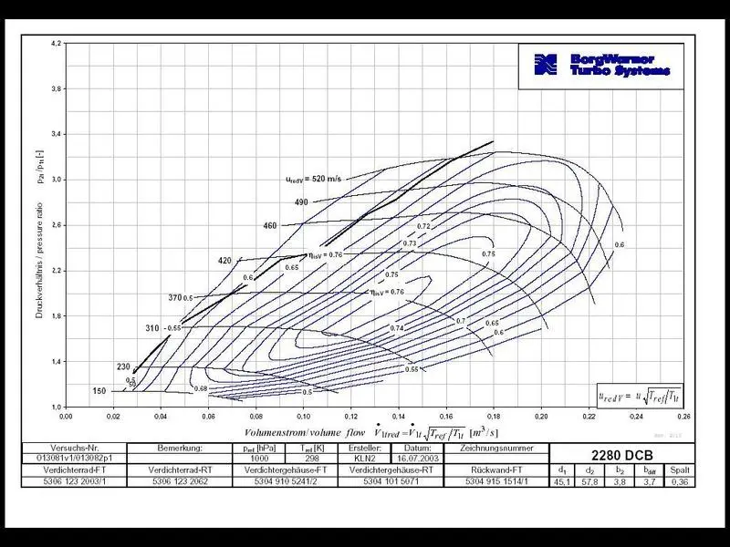

It should be noted, that raising the psi doesn't necessarily give a big power increase, and in fact, it can cause an overall horsepower decrease as charge temps skyrocket through the roof due to compressor inefficency.
Here's a post from another forum that explains why.
Hello here is the correct graph of the Speed 3 & Speed 6 turbo!!!
greetings from Germany
Can someone explain that graph? I don't have a degree in astrophysics. (FYI I know that has nothing to do with the graph)
