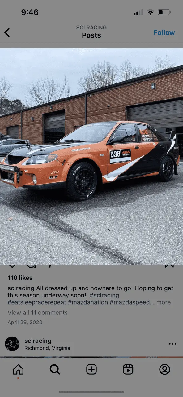

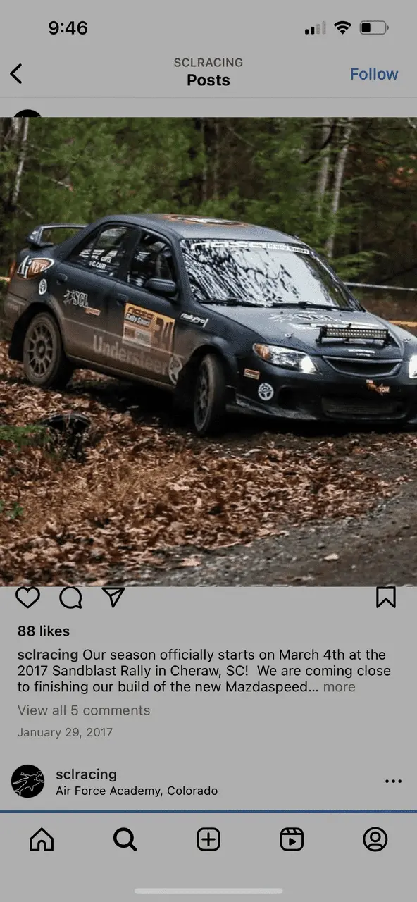

Anyone ever help you with this? I’m leaning the same way. Kinda rally ish / class11 build. Def prefer stock height or even slightly higher and more aggressive wheels
Sadly nope, but not unexpected since it's kinda niche question. Maybe with some activity now it'll get bumped and people will see the thread.
Those are some sick looking MSPs! I'm definitely not going that crazy but figured it's a more common size and would be nice for ride quality etc.
