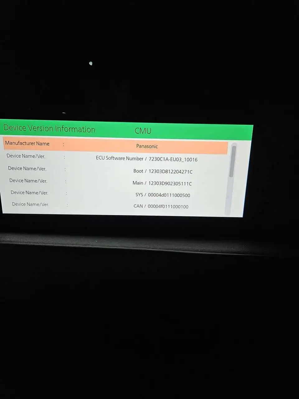

DEVICE VERSION INFORMATION CMU look up
ONLY send a PICTURE of all of your screen details Below in #8.
Plus also tell me (confirm) in what country is your Mazda NOW driven in.
1. Turn on ignition or ACC mode.
2. Press the Volume/Mute button and keep pressing it at same time press the Music and Favorite buttons at the same time for 3-5 seconds and the "Factory/Service Inspection" SCREEN will next appear.
3. Scroll UP or DOWN this list on screen by TURNING your Commander Knob up or down (see each Orange Highlighted Settings).
4. Select orange “Service Information” on the screen by ''Pressing Down'' on your Commander Knob once.
5. Select orange “Connected Device Information” on the screen.
6. Select orange “CMU” on the screen.
7. See "Device Version Information CMU" green banner screen.
* 8. See ECU Software Number like 7000C0A-NA01_10015.
All the Letters +Numbers from 70xxCxx-xxxx_xxxxx take a Picture and then Push 'Return' arrow BUTTON multiple times to return to the top page of the Factory/Service Inspection screen, then scroll select "End Diag Mode" to return to the normal screen.
* I Need to know #8, the FULL VERSION NUMBERS in a screen pic.

Hello, is there a new firmware for Mazda 3 Bp 2024, thanks?
