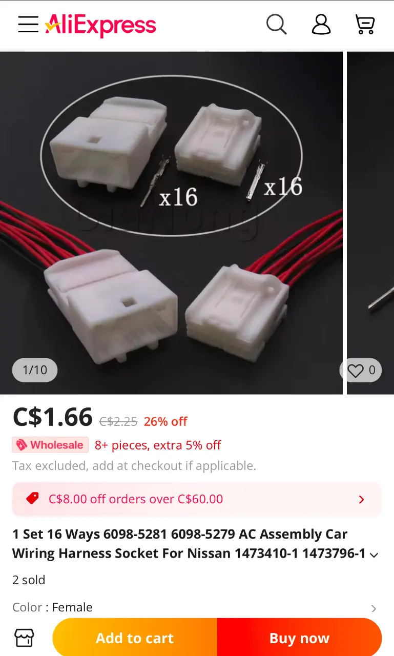

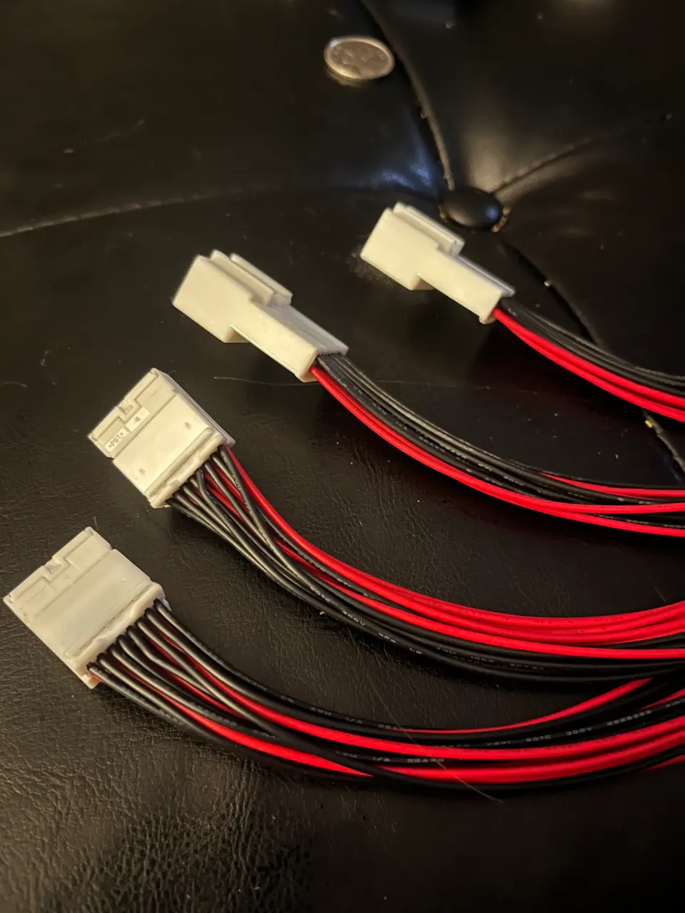

I have a 2024 with non Bose stereo and I’m installing a amp but didn’t want to cut the wiring for the speakers coming out of the amp , so with a afternoon of searching I came across a post in Reddit and a guy said he found the plugs that fit do I was able to find what he posted and ordered a ordered 2 sets from china , they arrived tonight and I can confirm that they plug into the amp.
So if you want to install without cutting these will work...

They plug into the amp but are these connections actually working as you want them to?
I used positap connectors to plug into the factory wiring. This would've been useful though because it was a really tight fit getting my hands under the seat. With that said mine is already installed so I'm not gonna worry about it.
