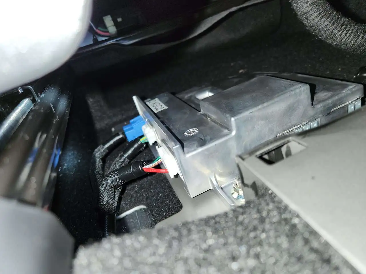

Wanted to post in this thread first before making a separate thread as this is related. Vehicle is a 2023 CX-5 non-Bose system.
I am wanting to keep the stereo upgrade simple and just add the JBL BassPro Hub Powered spare tire subwoofer to the system.
I am wanting to tap into the speaker outputs from the amp under the seat, but I do not want to cut or tap into the wires that may void the warranty. I have done a lot of searching and can not find the proper harnesses to purchase so I can make my own T harness to tap into the high level speaker outputs from the amp. From what I have read it would be the middle harness from the photo attached. I would need the male and female version of this harness (hopefully with wires attached) so I can make my own T harness.
Has anyone done this without cutting factory wires? Thoughts? Any other way of doing this to not void warranty? Appreciate any help.

Go to the junkyard to find the connectors.
I haven't been able to find the plug and ended up soldering on to the existing wiring coming from the plug. In my install (non-Bose) i replaced all speakers and added a sub so ran all my own wiring, and cut the oem wiring after the solder joint as i was getting some weird feedback coming through.

I found options for the speaker out connector with wires attached for non-bose 2023 and probably other models.
If you need the speaker connector with wires! I found a few sources for the part:
TH16FW-NH to TH16MF-NH Male to Female extension type (wire in between)
Aliexpress $7~ with shipping
The brand new original TH16FW-NH TH16MW-NH 16PIN is a connector plug for the navigation instrument host wiring harness of automo - AliExpress 34
Aliepxress both ends
Original TH24FW-NH TH24MW-NH automobile male and female 20cm harness connector plug - AliExpress
$30 has the option of male or male and female - includes wires
The brand original TH16FW-NH TH16MW-NH 16PIN is a connector plug for the navigation instrument host wiring harness of automo - Walmart.com
This is a way better option than just getting the connector and trying to sort wires.

I added a 4 channel Alpine KTP-445U and a Rockford R500X1D. Wasn't happy with the sub only setup.
What I did was cut the speaker out harness from the amp. I connected the harness end to the inline of the Alpine and connected the outline wires from the Alpine to the cut end of the factory speaker wires. For the Rockford, I tapped into the rear speaker wires before the connection to the 4ch. I also installed 4 Alpine S-S65 speakers. The KTP is set to 60hz HPF. For the sub I'm using is a down fire Pioneer 12".
Everything sounds fantastic! It wasn't as easy as I thought it was going to be. Some things to mention that might help.
*Again, take the seat out to work with the amp under the passenger front seat. Make sure to disconnect the neg side of the car battery before getting started. I had no trouble reconnecting the neg side from time to time for testing as long as you don't move the seat while doing it. I managed to work under the seat after removing the 4 bolts and keeping all the wires connected to the seat by tilting the seat back and propping the seat with a vacuum cleaner hose.
* I connected all the wires from the cut harness and the 4 ch amp to Nilight 2pin plug sockets. This will make it easy to switch it back to stock. I connected male and females to the cut factory harness and factory speaker wire side and connected male and females to the inline and outline of the amp.

That would only work for the male side of the connector if I could even find a 2023 in a junkyard. I would still need the female side in order to make a T harness.
I'm assuming you've sorted this out by now, but you gotta use posi-taps. Not t-taps or anything else.... posi-taps. They simply pierce the wire, and you tighten your other side inside the top cap that's running signal to your subwoofer.
Use your front speakers, no idea why people suggest the rear because they get sound slashed to bits and only uses for fill. The fronts get less bass rolloff and more wide range.
I used the actual branded posi-taps, this isn't something you want to skimp on here. You can get cheaper ones for much less, but it's not like a break the bank difference if you wanna do this right.
Doing it right includes a CLD layer, C.C.F layer, and should include an MLV layer if you can afford it.
And always always always use OFC wire kits with ANL fuses.
Mine was an absolute breeze to do on the cx5 compared to my Chevy Cruze...that thing was not meant to be customized AT ALL lol.
But getting under that seat is such a pain!
I suggest loosening the seat bolts, leaning it and propping it up out of the way with something...this way you do not need to disconnect and remove the whole thing. But then pull off the kick trim and the B pillar, there's a retaining clip pinning the carpet down under the B pillar. Pop that out, pull back the carpet as best you can, undo the ridiculous wire bundles they've got going on and pull the speaker wiring harness all the way out the other side of the carpet, into the door kick trim area.
And there you go, plenty of wire to work with, plenty of room to easily stuff it back under the carpet. Just make sure you wrap it up well, and without straining the wires. I've got a couple rolls of Tessa tape to make it all neat again, but it definitely doesn't all need to be neatly wrapped up right back together with the other bundles, especially if you need to repair it in the future
