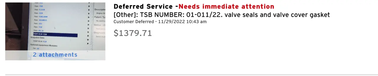

At the dealer now with my 2021 CX-9. Roughly 16K miles. Same symptoms of low oil light coming on after 4K miles into the oil change cycle. This is the second oil change that I've raised the issue. At dropoff, the dealer immediately asked to keep the car a week to do the valve seals. It looks like they can only process 2 of these repairs per week though.
I deferred to later in the month since I can't downsize to a CX-50 loaner this week, but you should plan to be without the car for a period of time at least early on as they get going on these repairs.

I, too, have a 2021 Turbo CX9. The oil light has come on every 2000 miles since I got the vehicle. It is the same story, top off until they had a fix. I got the fix. They changed all the valves and it did not fix it. This time THEY FIXED THE SENSOR. They said new valves can mess up a sensor (after they told me in person the sensor did not fail - the oil was LOW). The oil sensor did not fail. They said this should fix the problem. Now I wait for the next 2000 miles. I have 14076 miles. Any advice would be great.
Ok, you asked for advise here it is. I am advising you that your dealership is dishonest. Valve seals can't mess up a sensor that's preposterous. You need to drive in there when your oil light turns on and tell them to follow the tsb. If your car falls in the VIN range you're only requirement is to show up with a low oil light on and a code set. Then according to the TSB the dealer is instructed by Mazda corporation to replace your seals. It's pretty cut and dry. Get a copy of the TSB read it understand it and go into your dealership armed with that knowledge. There's your advice
