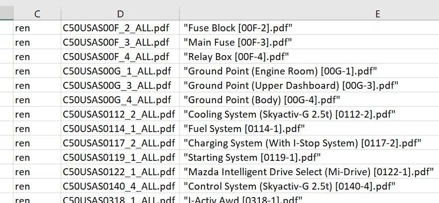

You know you can pay $30 for a 24hr subscription to the Mazda shop manual site and just download everything you can (or need) for your car and MY?
I did this for my CX-50... downloaded all the schematics and also all the interior disassembly and exterior panel stuff as well. It may take a couple of hours, but do it immediately after you pay, then check you have all you need so you can get anything that you missed or that didn't download correctly before your 24hrs expires. Note that the downloaded file names are not explanatory, so I downloaded them into different folders per section, then renamed the files to more explanatory file names afterwards. Here's an example for schematic files from my rename spreadsheet:

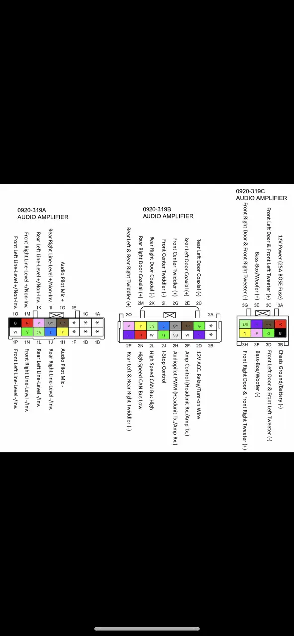

Hello sir, I just did a full install in my cx5 gt with bose. I can provide you with the diagram that took me ages to find as well

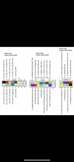

Add me. Id rather discuss here so I can talk to you at an added pace. I amped all my bose speakers with aftermarket amps. Added a dsp to tune how I want everything to sound and get more volume out of everything. I also added a sub ontop of the 5.25” stock sub. But run both of them for added bandwidth.
