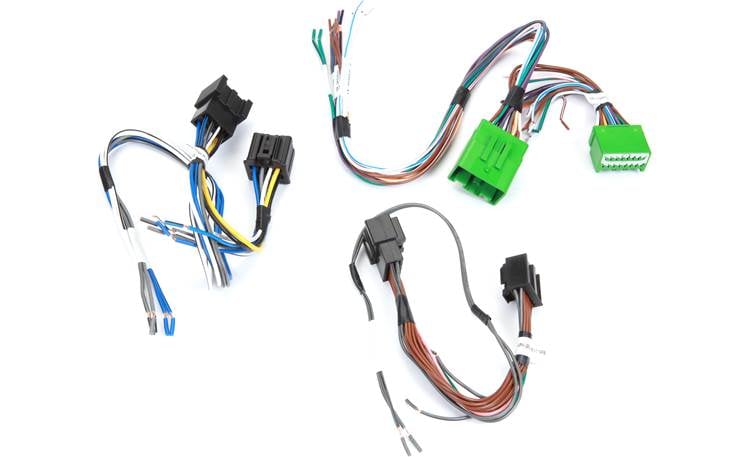

Wiring harnesses $34.99: you only need one of the harnesses (Black 16-pin) but if doing a broader install the others might be needed. The green 16-pin and black 16 pin connectors both fit the factory Bose amp but I didn't verify the other harness, will detail pin outs below:

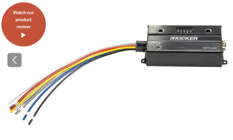

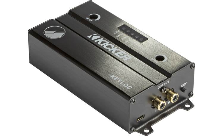

Kicker Keyloc $124.99: I used the Kicker Key 2 channel LOC in conjunction with an amp I already had. If you wanted to kill two birds with one stone, you could get the Kicker Key mono amp. The 2 channel LOC can be found here:

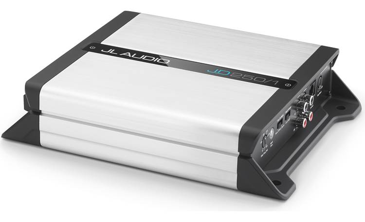

JL Audio JD 250/1 $229.99: I already had this amp from a previous install. Amp/Sub choice are personal preference. JD 250/1 here:

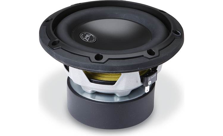

JL Audio 6w3v3 $299.99: Already had this sub from a previous install. Again, amp/sub combo are personal preference. These little 6.5" JL subs put out A TON of fairly accurate bass for their size. I used this because it fit perfectly in the wheel well. Sub here:

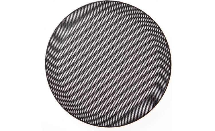

Sub Grill $34.99: self explanatory, here:

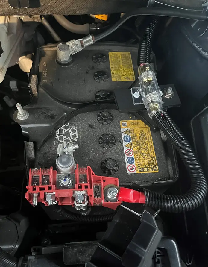

Step 1: Disconnect your battery. Leave it disconnected while plugging/unplugging anything. You'll need it connected to move your passenger seat to remove the amp cover. Run your power, ground and remote wire. Removing the rear seat bottom there are plenty of spots to ground to. I made a little fuse holder for the engine bay like this:

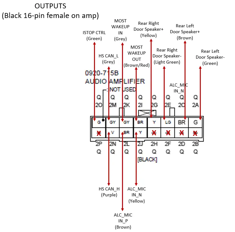

Step 2: Prepare your integration wiring harness. This will avoid cutting/splicing any factory wiring. Using the wiring harness linked above, you're going to want to grab the black 16-pin harness that looks like this:
After removing the amp cover under the passenger seat, you'll end up disconnecting the same black 16-pin plug from the factory Bose amp. It looks like this (ignore the disconnected green plug/leave that connected):
Ignore the wiring labels that come on the harnesses. With the plug disconnected if you are looking straight on at the Bose amps female port/slot, the pin outs look like this:

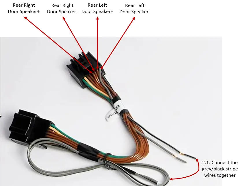

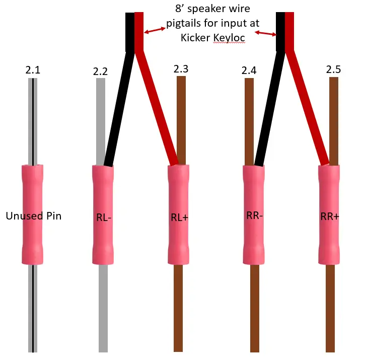

On the PAC harness above with all the brown wires, you'll end up connecting crimping together the grey and grey/black stripe wires, and then for the other 3 channels you'll cut them in the middle, and add ~8 foot wire pig tails onto them. Do the wires one at a time and label them as you go if it helps. Make sure you are working on the male end of the plugs below, not the female end otherwise the wires will be reversed and it won't work correctly.
2.1: Start by crimping a butt connector onto one end of the grey/black stripe wire, slide your heat shrink on, and then crimp the other end of the grey/black stripe wire into the butt connector. This pin is not actually used so you could skip this but doesn't hurt to connect it.
2.2: Next, grab ~8 feet of speaker wire and strip the ends. Grab one end of the solid grey wire (Rear Left Door Speaker - ) and twist a bare wire end from your 8' speaker wire to it, make sure you keep straight which are you positives and which are your negative wires for later on. Insert both/2 wires into one end of a butt connector and crimp them in place. Slide heat shrink over, and then insert the other single grey wire into the other end of the butt connector and crimp it down.
2.3-2.5: Do these one at a time working from right to left. Your Rear Left Door Speaker - is already done (solid grey wire). Cut the Rear Left Door Speaker + wire in the middle and strip both ends. Now take the other bare wire end from step 2.2 and again, twist it to one of the brown bare wire ends, insert into a butt splice and crimp them down. Slide on your heat shrink, and then slide in the other brown wire end and crimp it down. Repeat this process for the Rear Right Door Speaker - and Rear Right Door Speaker +.
After completing steps 2.1-2.5, you should end up with connections that look like this (minus the heat shrink) Label the far end of these wires so you know which is Rear Left + and - and which is Rear Right + and -.
Your solid grey wire and your brown wires will each have a pigtail coming off of them that you'll later route back to the trunk for input at your Kicker Keyloc or Kicker Key mono amp. Wrap everything in Tesa tape to keep it compact/tidy it up. Plug the male end of your new harness into the factory amp, and plug the factory male plug into the female plug on your new harness. You can do this next step now or after you run these wires to the trunk. If you do it now you'll likely have some extra wire to coil up. If you run the wires first you can get a more precise length. Either way is okay. Slide heat shrink over the far bare wire ends and crimp on insulated spade terminals. I do all male terminals on these wires to keep things uniform. Now is also a good time to loom your wires. This step is optional, but I prefer to do it. Once your wires are loomed, you're ready to move on.

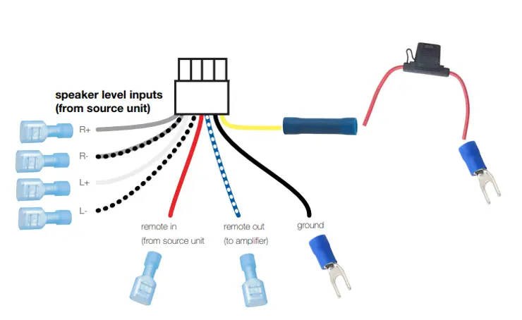

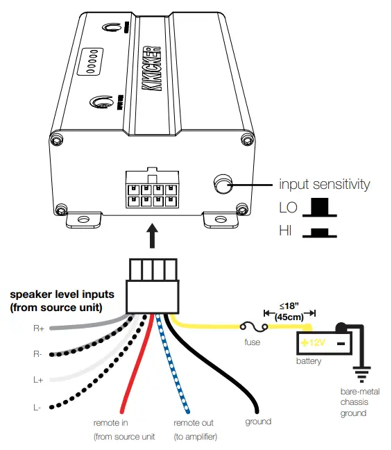

Step 3: Slide heat shrink over all the wires on the Kicker Keyloc harness, making sure to use red/black heat shrink for positive and negative wires accordingly. Once you've got your heat shrink slid on, start by grabbing 6 female insulated spade connectors and crimp them onto the bare wire ends for R+ , R- , L+ , L- , Remote In, and Remote Out. Grab your add a fuse and use a butt splice connector to connect it to the yellow power wire, and on the other bare wire end slide on heat shrink and crimp on a fork terminal. Crimp a fork terminal onto the end of the black ground wire. Once you're done with crimping/wiring the Kicker Keyloc harness, it should look like this (minus the heat shrink):

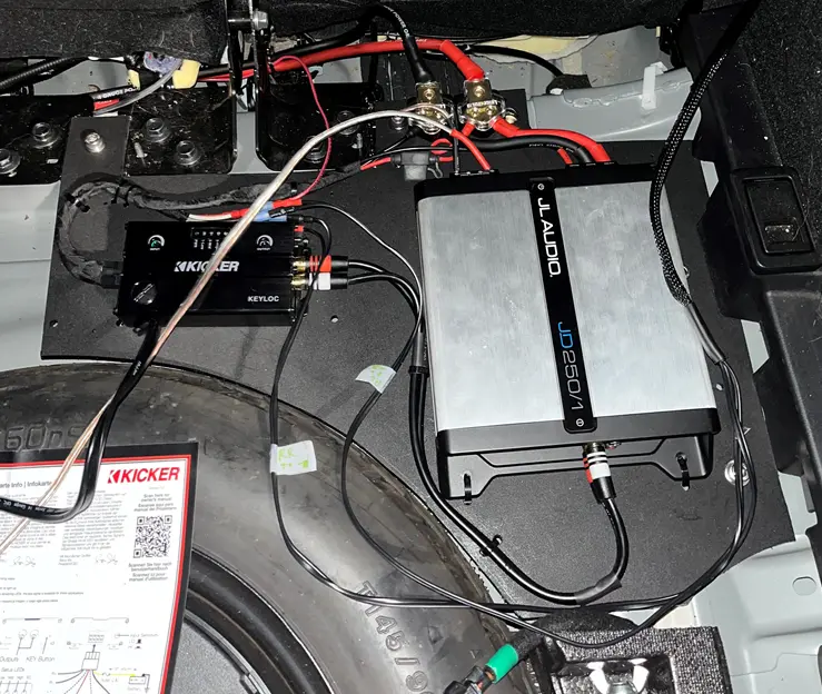

Step 4: Cut your ABS/HDPE plastic to the shape for your amp rack. I like to test fit shapes by first using cardboard and then trace them onto my ABS/HDPE before cutting that with a jigsaw. A simple rectangle will suffice but you can certainly get fancy with it. I ended up cutting/removing some of the styrofoam around the spare tire and making the shape below. This is looking into the trunk/amp rack on the right. I drilled 4 holes, inserted rivnuts, and attached my amp rack using hex head bolts at the marked spots in the pic below. The amp rack is secure and has room for a larger amp diagonally. If you we're just using the Kicker Key mono amp a smaller rack would suffice. Pic of my amp rack (ignore the wiring mess this was taken during testing phase):

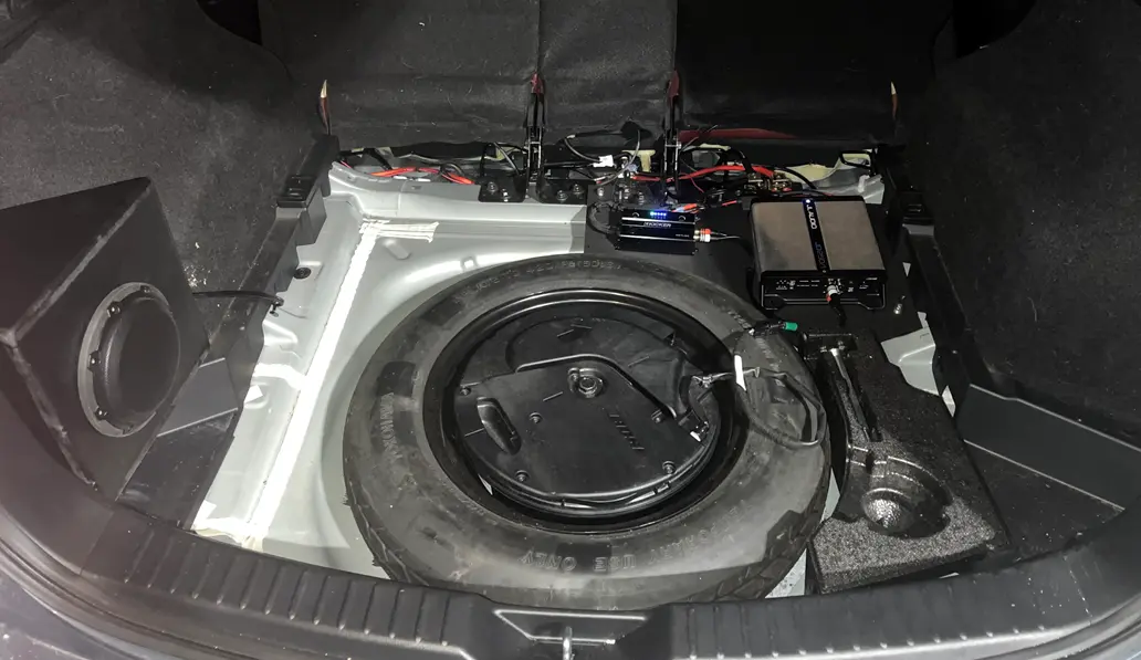

Step 5: After test fitting your amp rack, remove it and start laying out your amp and Kicker Keyloc. The location of your chosen amps power/ground/inputs/outputs will determine your own orientation. You can see above where I chose to put my distribution blocks, where my power and ground come in (driver side of vehicle) and where your input wires from the factory amp will come in on the passenger side. Once you've settled on a layout, attach your gear. I primarily drill two holes at each zip tie point, run my zip ties from the back and then snip them off to make them look tidy. Once you've got everything attached to your amp rack, you can start making connections.
5.1: Run your RCA from the Kicker Keyloc to your amps input. Connect your inline fuse coming off the Kicker Keyloc to one side of your positive distribution block, and run a power wire from the other side of the distribution block to your amps + terminal. Do the same for your negative connections, ground wire from Kicker Keyloc to ground distribution block and ground wire from amp to distribution block. Make a ~1 foot remote wire jumper with an insulated male spade terminal on one end and a fork terminal on the other end. Connect the male spade terminal to the female spade terminal of the remote out on the Kicker Keyloc and then insert the fork terminal into the remote in on your amp and tighten down.
5.2: Once you've made all the connections you can with the amp rack out of the vehicle, it's time for the final install. Install your pre-wired amp rack into the vehicle and make your final connections. Match up your newly ran ~8' pigtail wires to their appropriate counterparts on the Kicker Keyloc. If you already crimped on the male insulated spade connectors to these wires, just match them up and slide them together, otherwise cut your wires to length, crimp the male terminals on and make your connections. Attach your power and ground wires to your distribution blocks. Strip back, slide heat shrink on, and crimp on a male insulated spade terminal on the remote wire coming from your cabin fuse panel. Connect the remote wire from your fuse panel to the Remote In on the Kicker Keyloc. Make a length of speaker wire to go from your Amp Output to your sub box. Connect your subwoofer(s).

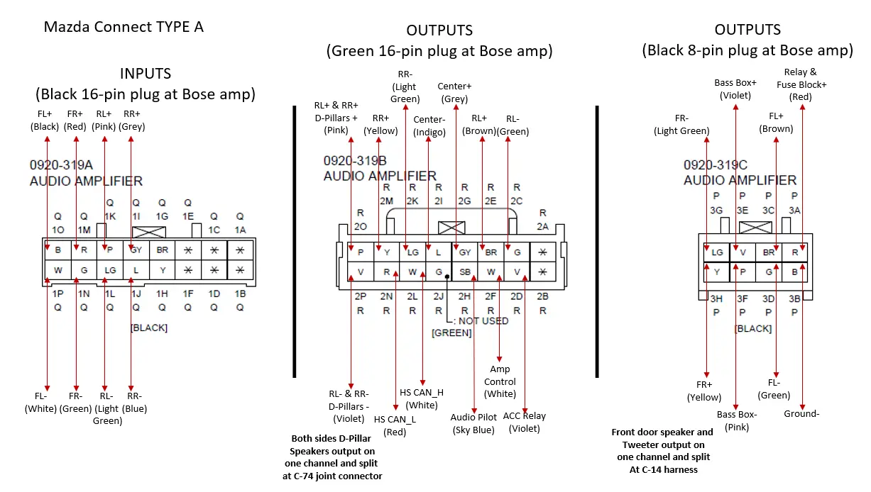

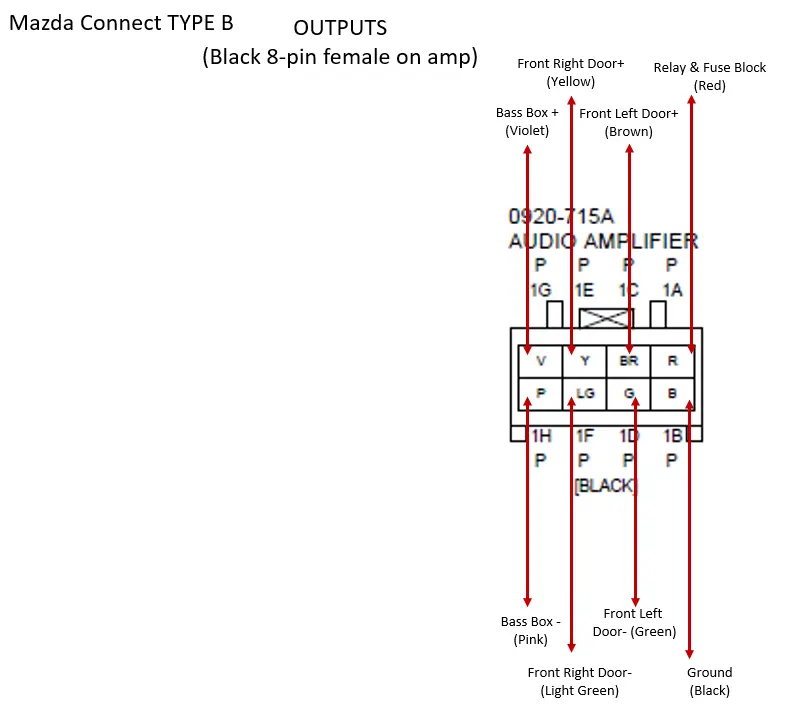

to OP or anyone - do you see a spot on one of the harnesses to tap for remote turn on? what is the "relay and fuse block" wire on the 8-pin harness? if i can tap at the amp, it will save me running a wire from the fuse block.
Sorry forgot to grab a pic and I’m traveling but I’m 99% certain I passed my power wire through that grommet, I know 100% I passed it through on the drivers side and routed it along the drivers side to the rear.
For the remote wire, on the Type A diagrams above the two that jump out to me are the ACC relay and Amp control, both on the green 16 pin, on Type B, that relay and fuse block pin on the black 8 pin connector you referenced might work, or on the black 16 pin connector you’d already be using for signal, possible the “Most wake up in/out” pins, and if one of those works, you’d just have one connector T’d in.
Whichever type you have, you can test with a multimeter or test light from an auto store, connect your negative to a ground, and positive probe or test light into those various pins to see if one gets power/lights the test light when the amp/radio kick on.
