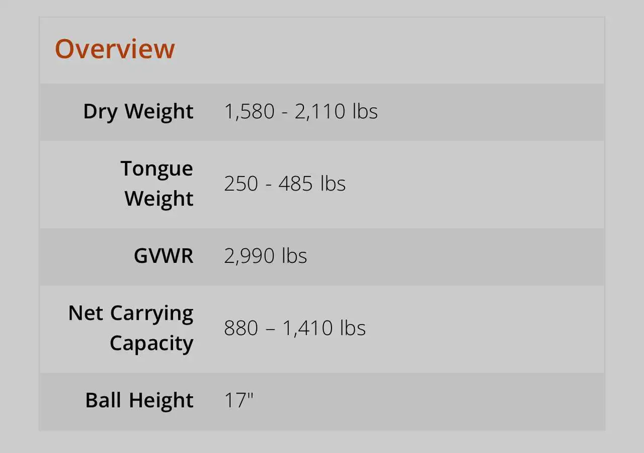

as far as exceeding the weight limit, the trailer walks right up to the 2000lbs limit but does not go over in the configuration I have. It is a toy hauler though so it is very tongue heavy. Here are the specs from the link I posted

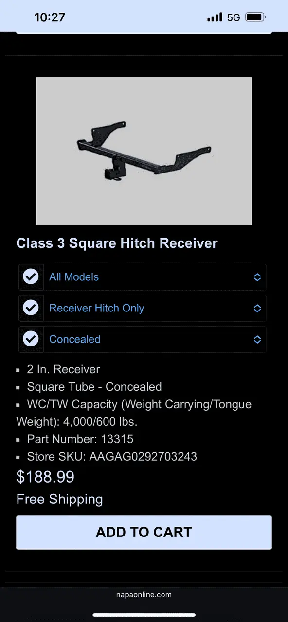

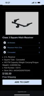

Problem solved, hopefully! Found this Curtis receiver on NAPA
Sadly .... "Excluding diesel"
https://www.curtmfg.com/part/13315
That's the problem you're going to run into at all these parts places. Their fitment guide is just going to say "all" models. I would strongly suggest that you contact the manufacturer of anything you come across to double check before pulling the trigger on it.

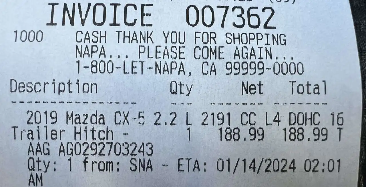

thanks for the heads up! heading back to NAPA now. I have my engine included on the receipt so this will be interesting to see what they say

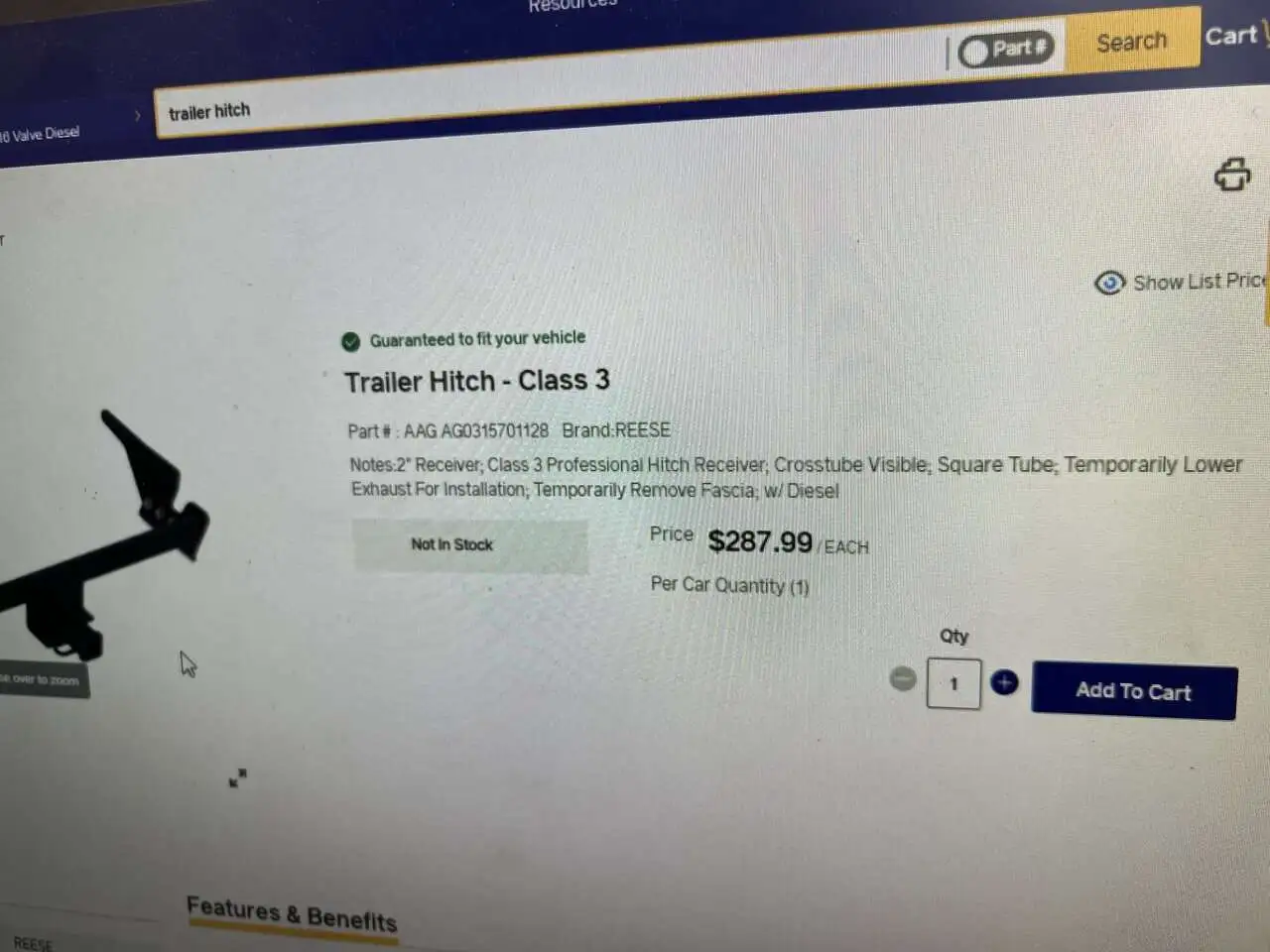

well the guy at NAPA thought it would still work. but they did find another hitch in their database that could be a better fit. they could not order it directly, however. it could be a couple days before I find out if I am able to order this receiver. it makes a compelling claim in its product description that it will work
Those numbers that you listed are un-loaded weights. What's the weight loaded with your 'toys"?
i have only towed it dry. i was planning on loading it with my mobility equipment (wheelchair, walker, prosthetics, maybe scooter). and probably some of my cat's "toys" too lol

"the trailer walks right up to the 2000lbs limit but does not go over in the configuration I have"
And after you load the trailer with all of your stuff, that 2k lbs limit will be exceeded.

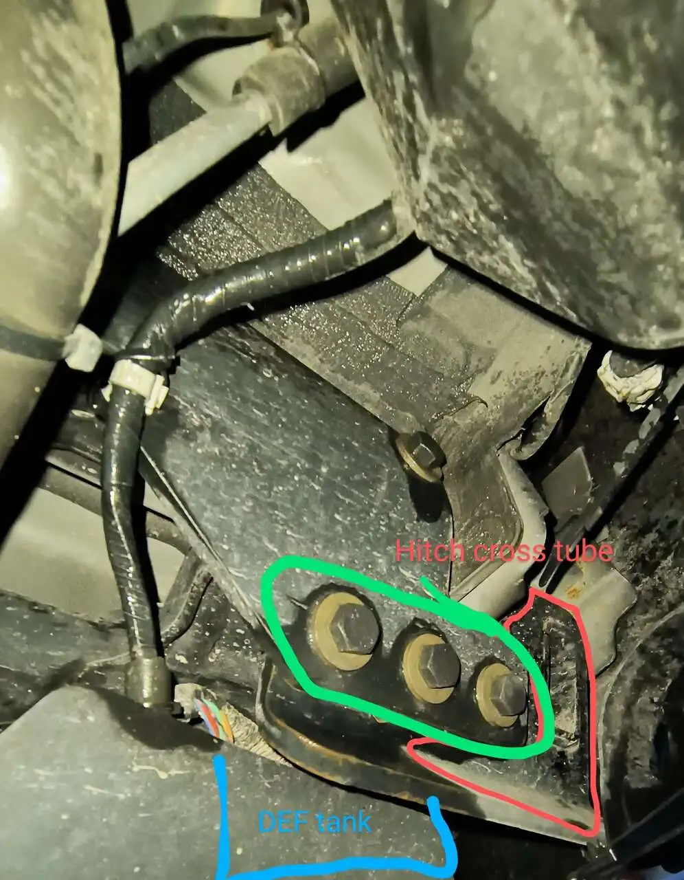

@blackmambo5 , I had a chance to snap a pic of our hitch on our diesel as a reference to the difference between the diesel hitch vs the gas model.
The diesel hitch has a two piece design that bolts together in order to accommodate the DEF tank. You can see in the photo (circled in green) where the bracket that mounts to the cx5 body on the driver side attached to the cross tube (in red) with three bolts.
The solid one-piece hitch that's all welded together is what you will find all of these other cx5 hitch designs are and I don't think they will install around the DEF tank.
The two piece bolt together design may also be the reason for the lower tongue loading rating.

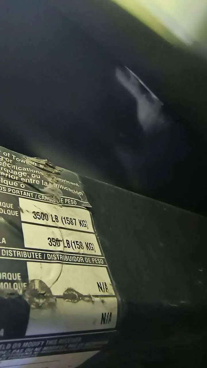

There's a label on my hitch but unfortunately the manufacturer info I think is on the top side and I can't see it.
