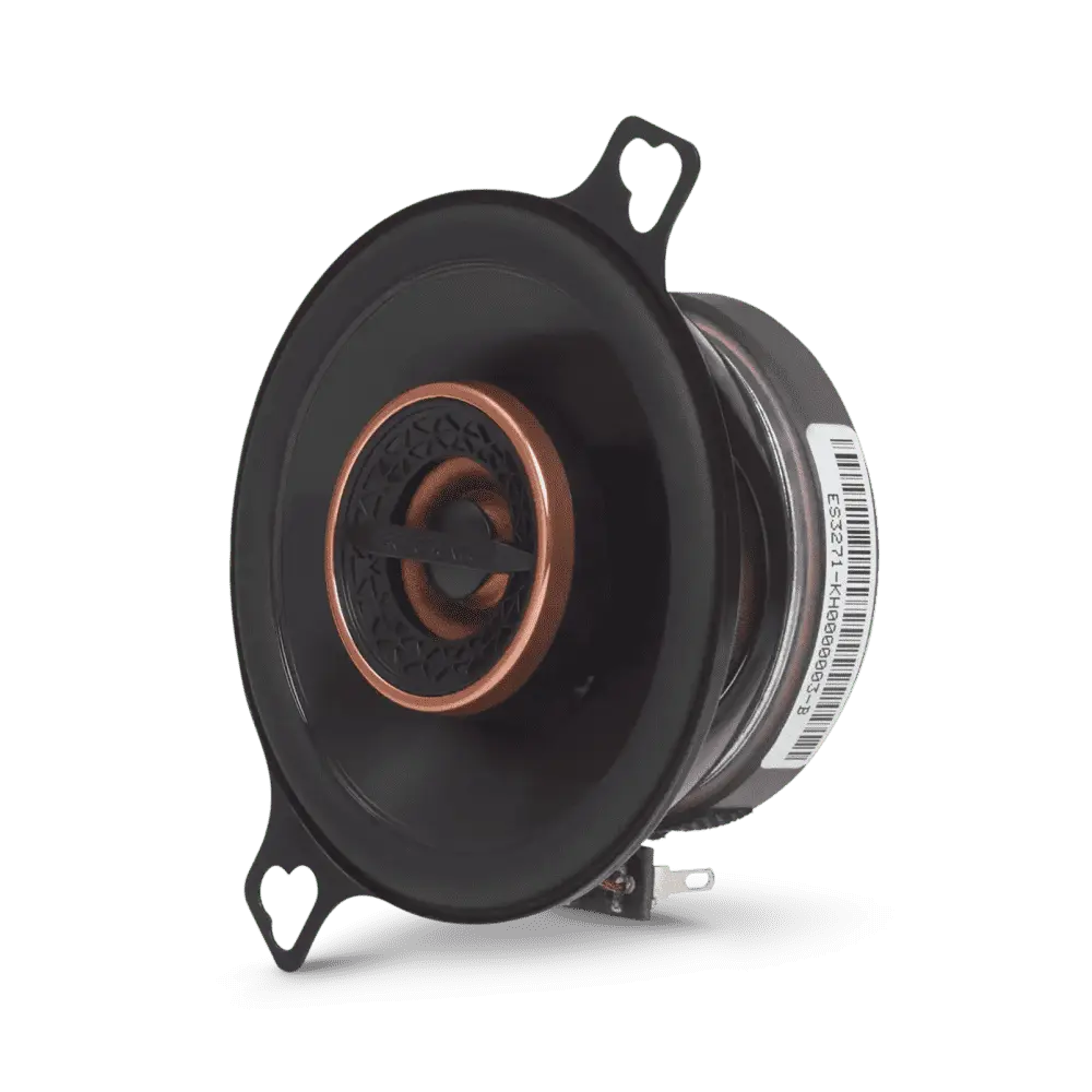

I bought some Infinity Reference 3032cfx to replace the corner dash speakers after a Bose tweeter went out. I cut the wires to the Infinity tweeter and bi wired them to the factory Bose amp. The sound was not as good as the factory Bose speakers. Not sure if it was a sensitivity issue or power issue with the Infinity speakers but the mid range was quieter and the tweeters were lacking definition.

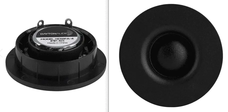

I decided to find some replacement tweeters and install the Bose 3.5's back into their original locations. The factory tweeters are about 35mm in diameter. I found some Dayton Audio ND16FA-4 tweeters that when modified fit into the factory location perfectly. I had to trim the flange off. I then added a Dayton Audio DMPC-6.8 Capacitor.
The sound from the mid range is better now, I sealed up the speaker locations and added better foam rings on the front side of the mid. The tweeters are a lot better than the factory Bose tweeters. The sound is much improved now.
