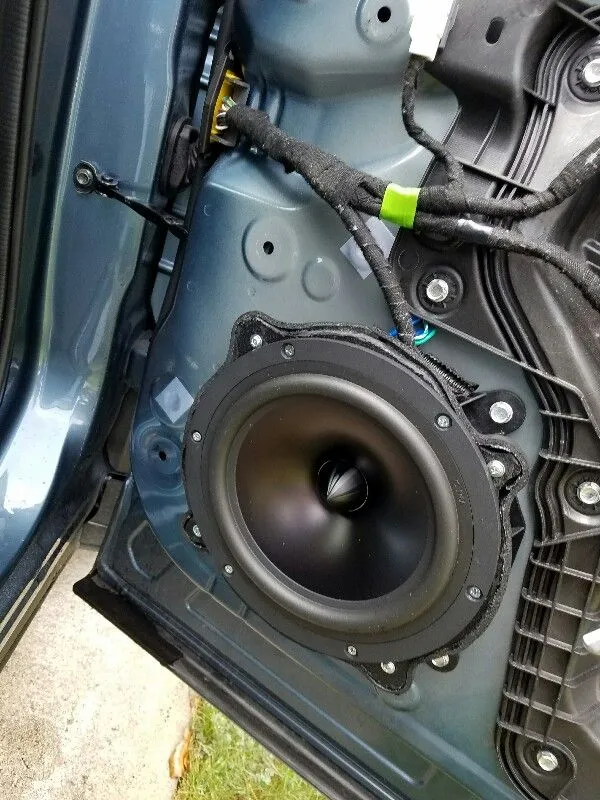

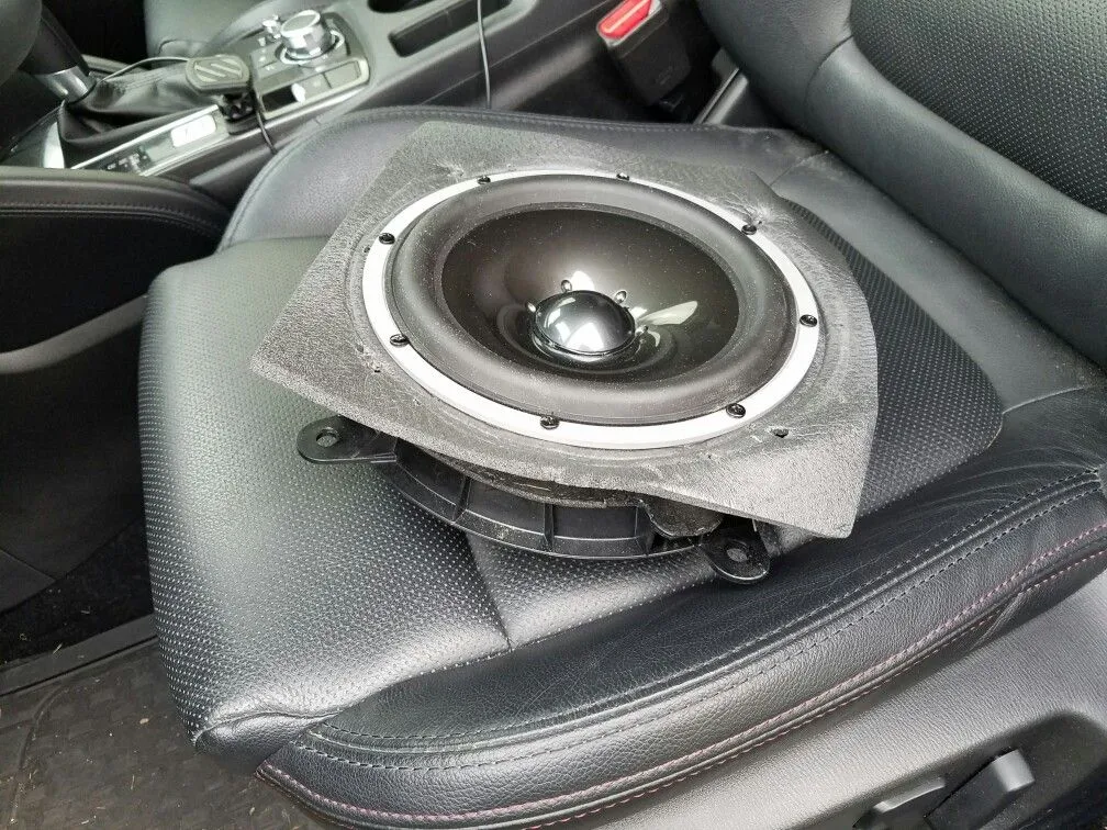

I have auditioned two speakers so far to replace the factory 8 inch speakers. I know they are listed as 9's, but they arent. I hadn't posted about it yet because I wanted to find what I liked best first. So of the two I've tried I'll get into what each does best and why. But also I'll say if anyone is looking for an actual all around upgrade from the factory Bose woofers, you will need an external amp. In the 2016 with bose, the speaker is running at 1ohm getting 44 watts. The only 8's I could find to run at 1ohm require much more that 44 watts. If you run a 2 or 4ohm speaker off the factory amp, you will be significantly lowering the power output. I used a 4 channel amp and bridged the channels to get 150watts into 2 channels @4ohms.
Audition #1 Dayton Audio rs-225-4
80 watts rms
6mm xmax
33hz fs
Pro's : very clean sound. No distortion up until the point of failure. Very nice sound, clean mid bass, and will play pretty low to an extent. (Low fs)
Con's : these speakers will go from playing clean, to straight failure. Stick to the rms rating. If you feed these more than 80watts, even by a little, they will begin to fail. These speakers have good xmax rating. While that's good for bass, it's bad for your door panel. ALOT of vibrations.
I'd recommend these to anyone who listens at volume level 40 or less. Set amp at volume level 45, then when listening to music at max volume of 40, you will never run into problems with these speakers.

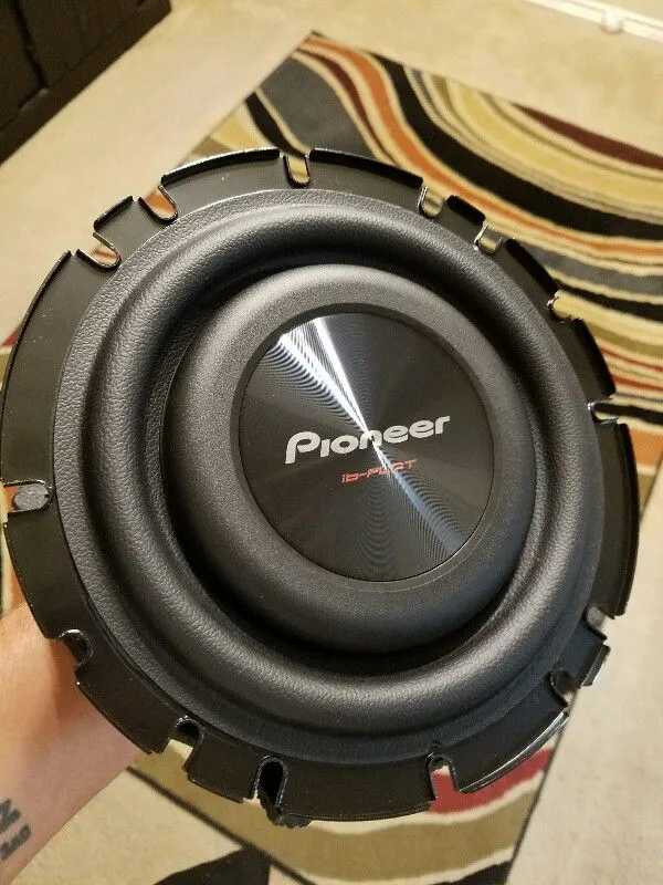

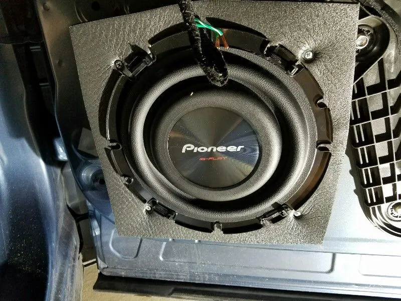

Audition #2 Pioneer TS-SW2002d2 shallow mount 8 inch subwoofer
150 watts rms
2mm xmax
65hz fs
Pro's : mounting depth, push terminals, power handling, good punch, great performance from 50hz to 200hz
Con's : wont do a lot below 50hz. very little xmax. This is sort of a pro and con in this case. Xmax is going to help the lower you go in the frequency range. But the fact that I have these in a door, the low xmax means less door vibrations. Combine that with a very stiff suspension, the speaker is always going to be under control. So just depends how you look at it and what sound you like...
Comparison : The Pioneers sound much different from the Daytons. The Pioneers have better punch and they can handle all of the 150 watts. Daytons have a warmer sound a different will play lower, but that being said they don't do it well enough to leave out a dedicated subwoofer.
Both of these speakers will benefit from a dedicated subwoofer to help with the lower notes. After all, they are only 8's. I ended up leaving the pioneers in, and they are playing down to 50hz, that's where my 12's pick up and play from 50hz down to 25hz.

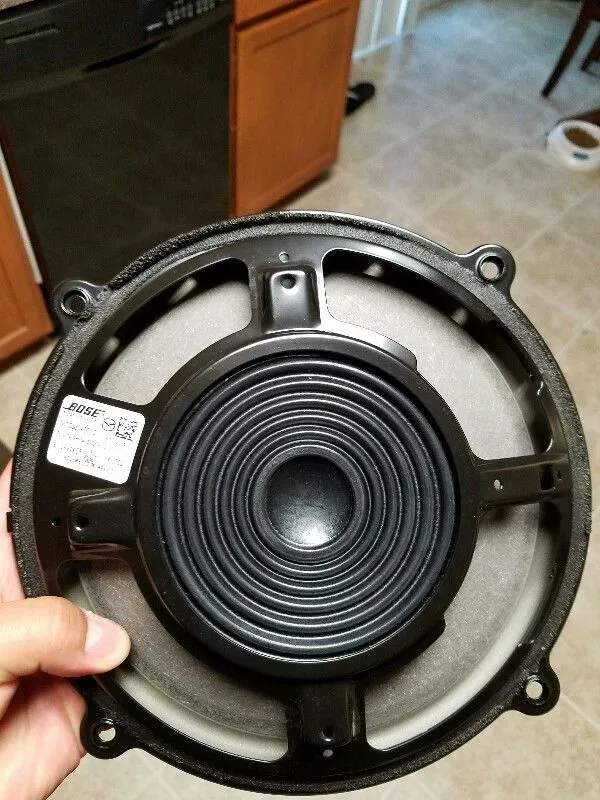

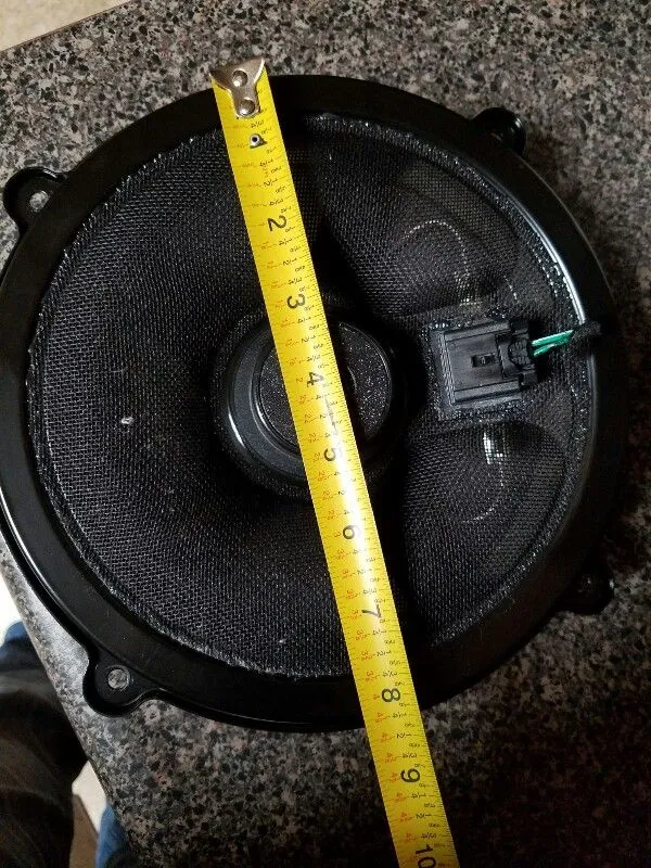

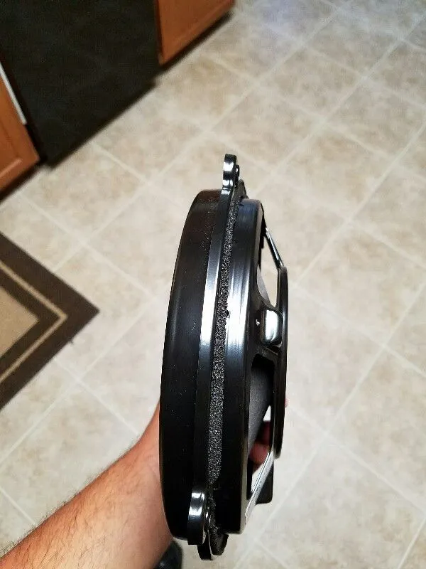

Thanks again for your very informative report! I didn't know the listed 9" OEM Bose front door "woofers" are actually 8" speakers! Do you mind to post some pictures of OEM Bose 9" speakers?

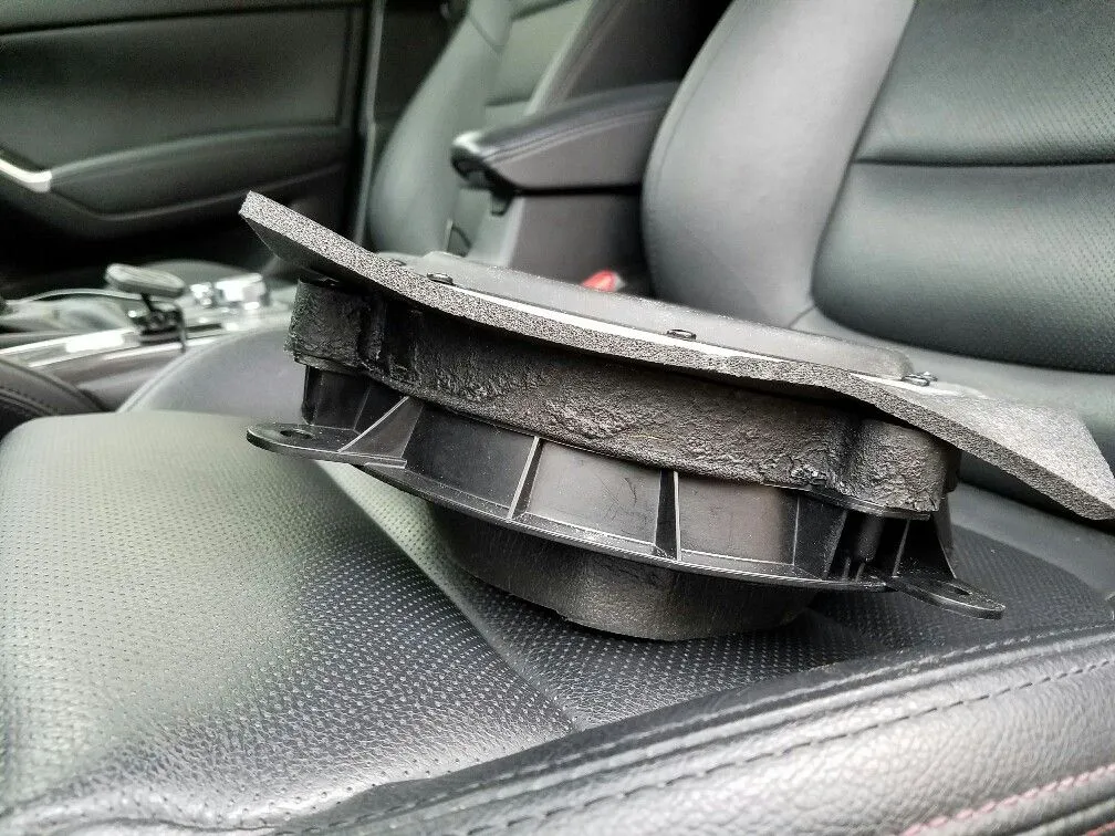

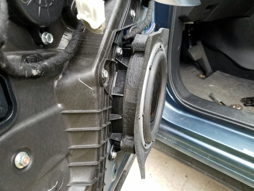

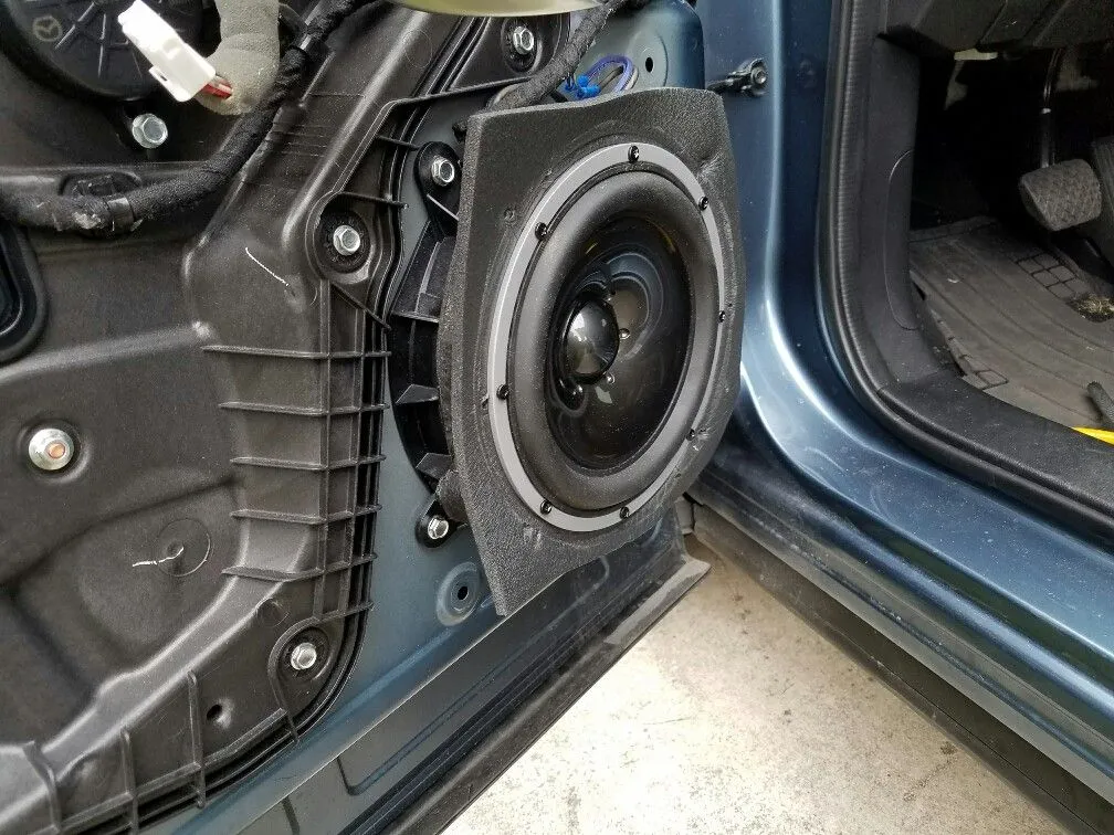

Sure. I'll snap a few pics tonight when I get home. The outer measurement is 9 inch. But the cone itself is more like 8inch. There is also a ring on the inside of the door panel that ends up going around the speaker. That ring also measures 8inches. I really should have taken more photos, but my installs are very time sensitive. Gotta get that family time in too. I also want to add that this does require some minor modifications to the factory bracket. Also, I had to make an adapter ring as well. And I'd highly recommend speaker baffles to protect from water/moisture that gets in the door panel. That gray foam you see around the Pioneer speaker is the baffle. I used XTC 8inch speaker baffle from partsexpress.com. basically the baffle extends around the speaker and into the door protecting the speaker. You cut the back of the baffle out to get the desired length you need it to extend.
So the baffle goes around the speaker, and then the adapter ring goes around the baffle. I secured everything together with 4 zip ties. Then the adapter ring attaches to the factory bracket just like the factory speaker does.

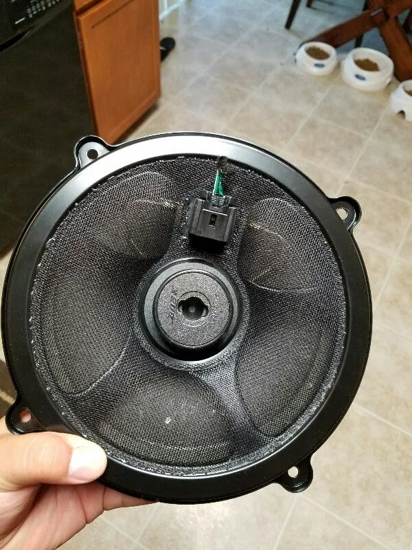

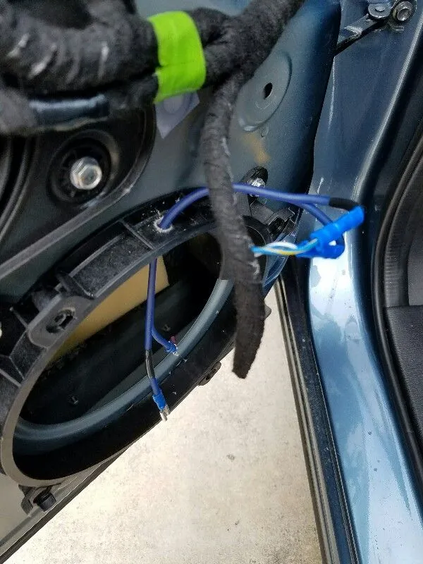

As requested, here is some pics of the Bose 9" woofer. I still can't seem to upload the pics so that they show. Maybe because I'm doing it on my phone??. Anyhow, hope the pics are helpful.
So this weird-looking、super-thin、cheap paper-cone door speaker is OEM Bose 9" "woofer"? Thanks for posting the photos!

Ahhhh. Ok. I see how you did it. Thanks again. And ya the speakers do look a little funny. Small neo magnet on the front of the speaker. The Surround looks to be foam, which really wont hold up over time. I will say that it performs well enough to most likely keep the masses happy. And I doubt that Bose is worried about the relatively small group of us who know enough to question them lol. Oh well.

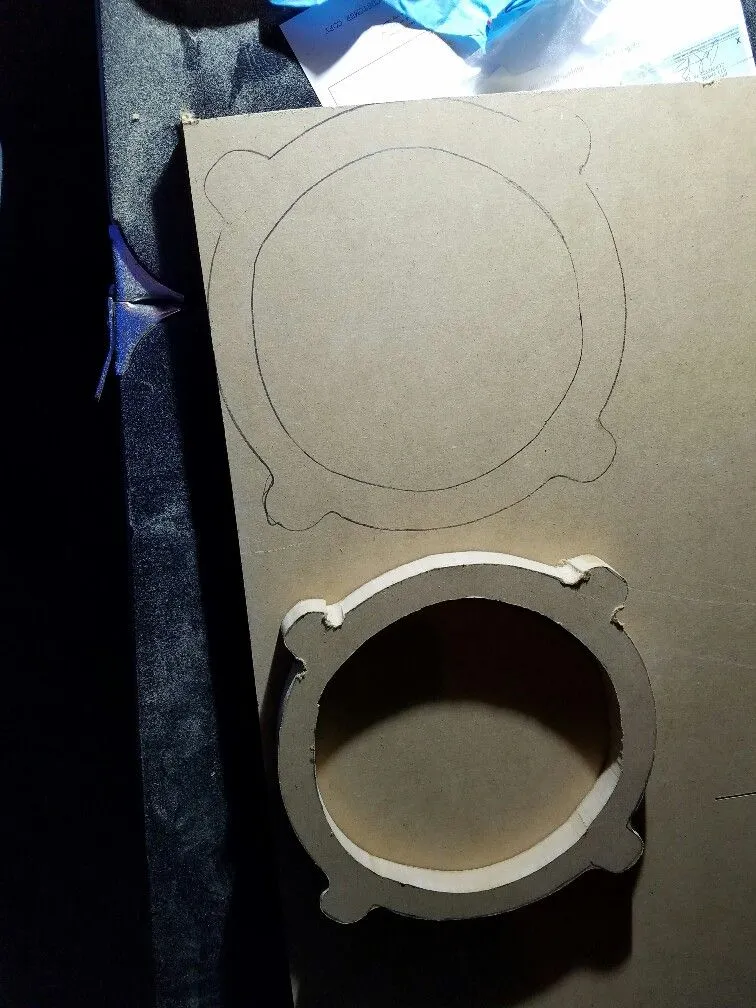

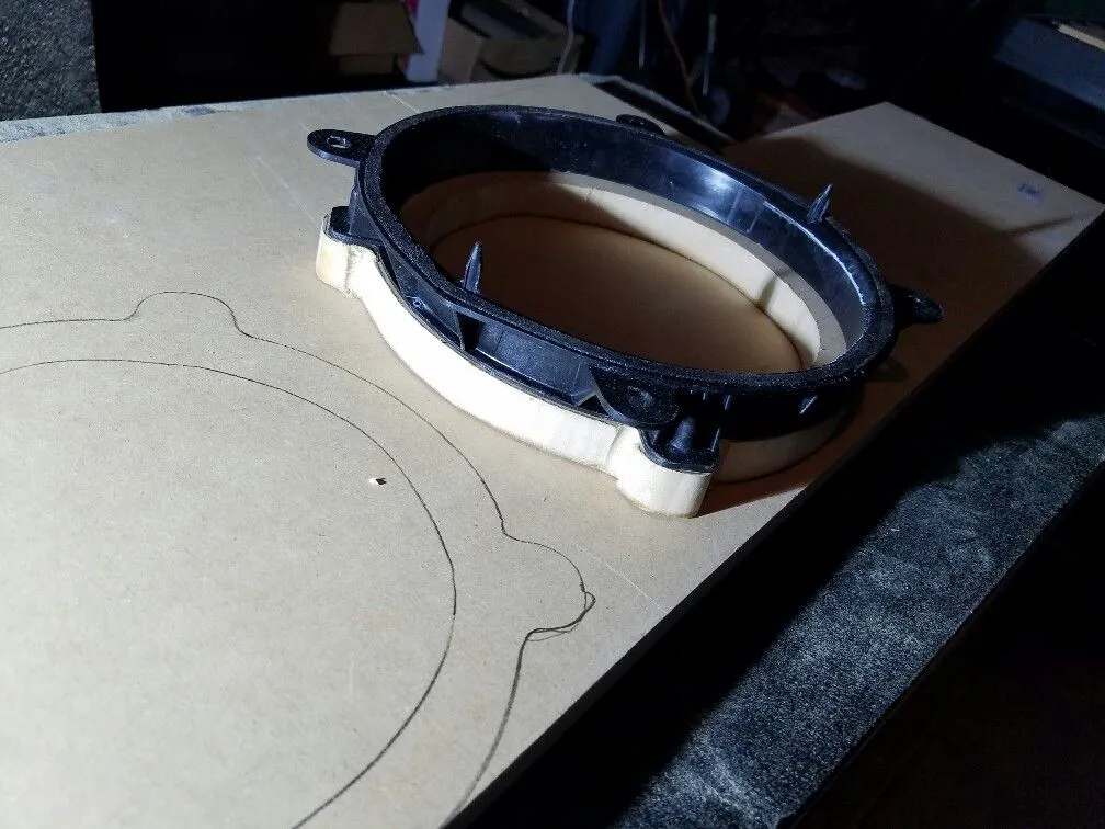

What did you use for the center channel?? You won't need an amp if you replace dash speakers. With just a little modifications I was able to get Dayton nd91's in all 3 dash locations. Added a passive crossovers and tweeters to left and right channels. Quality is REALLY on point. You will need an amp for the doors though

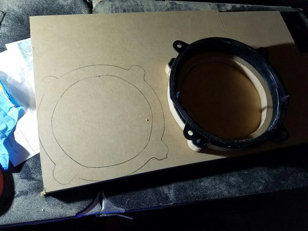

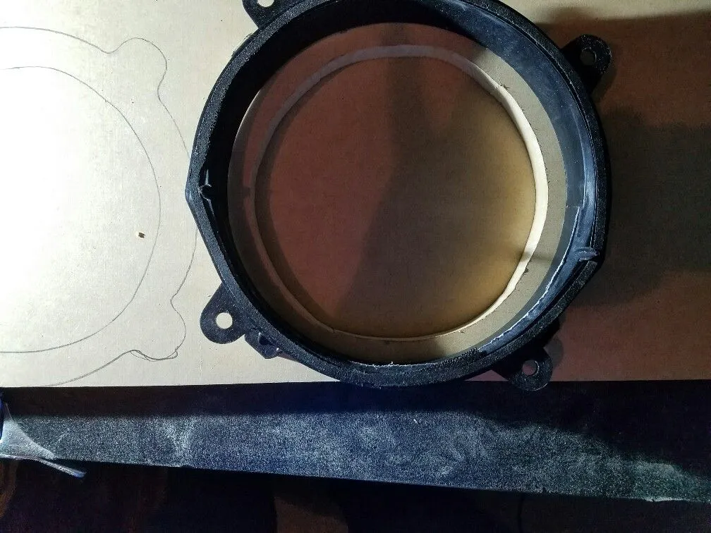

3/4 inch mdf adapter rings
