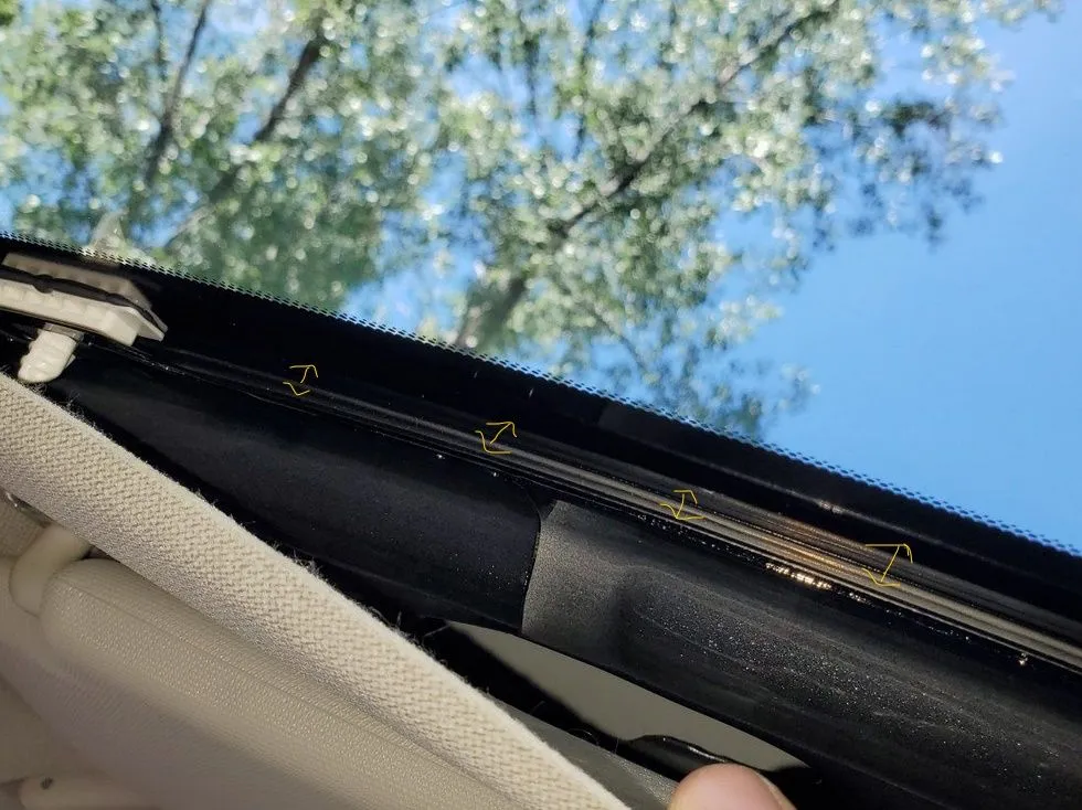

I had this noise on my 2018 CX-5. The noise is coming from the area where the windshield makes contact with the roof inside the cabinet. The noise went away after I placed a rubber weatherstrip in between.

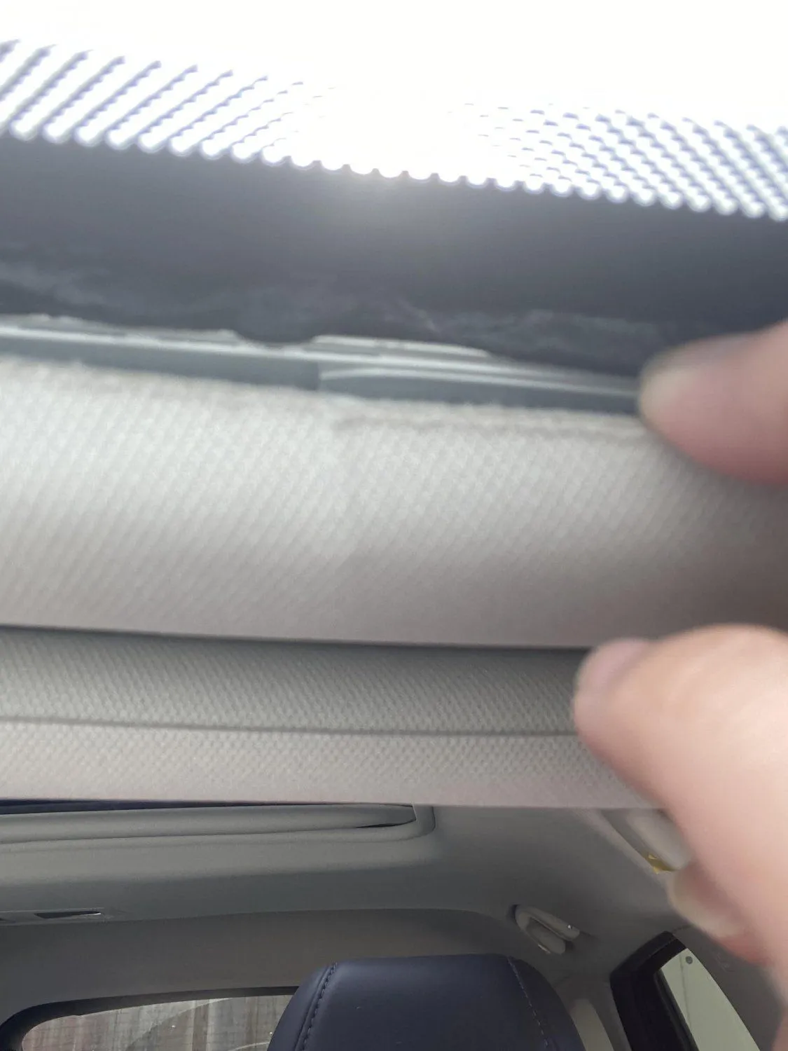

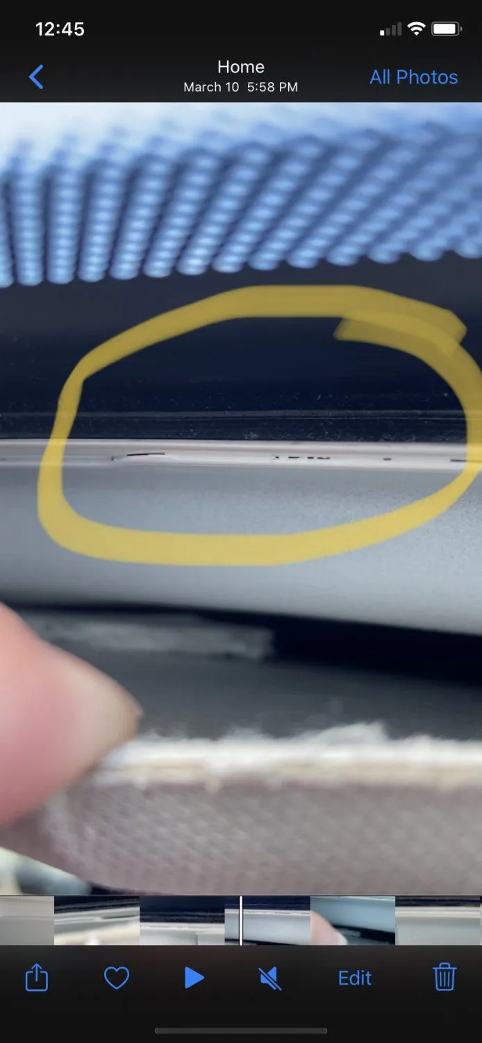

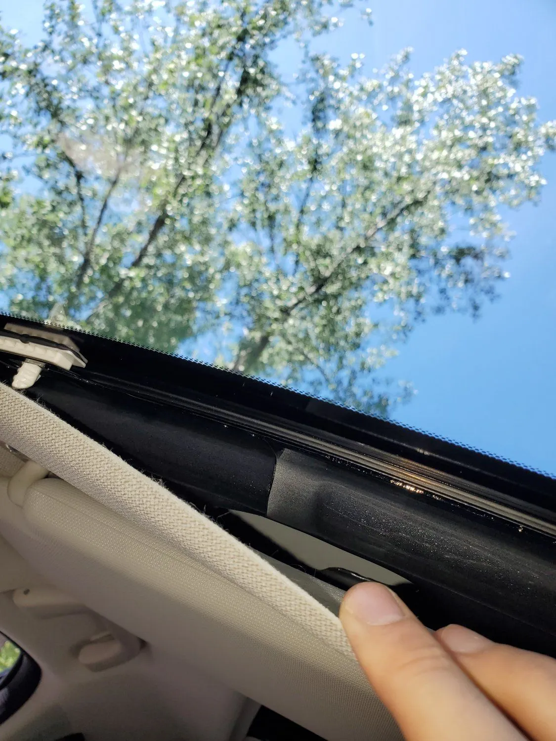

Thanks so much for replying! I took a look inside mine, and I did not quite get what you did to stop the noise. I took a few pictures, could you please guide me a bit? Thanks again for your time and help, I appreciate it!

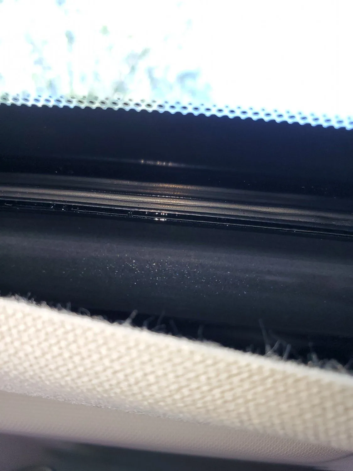

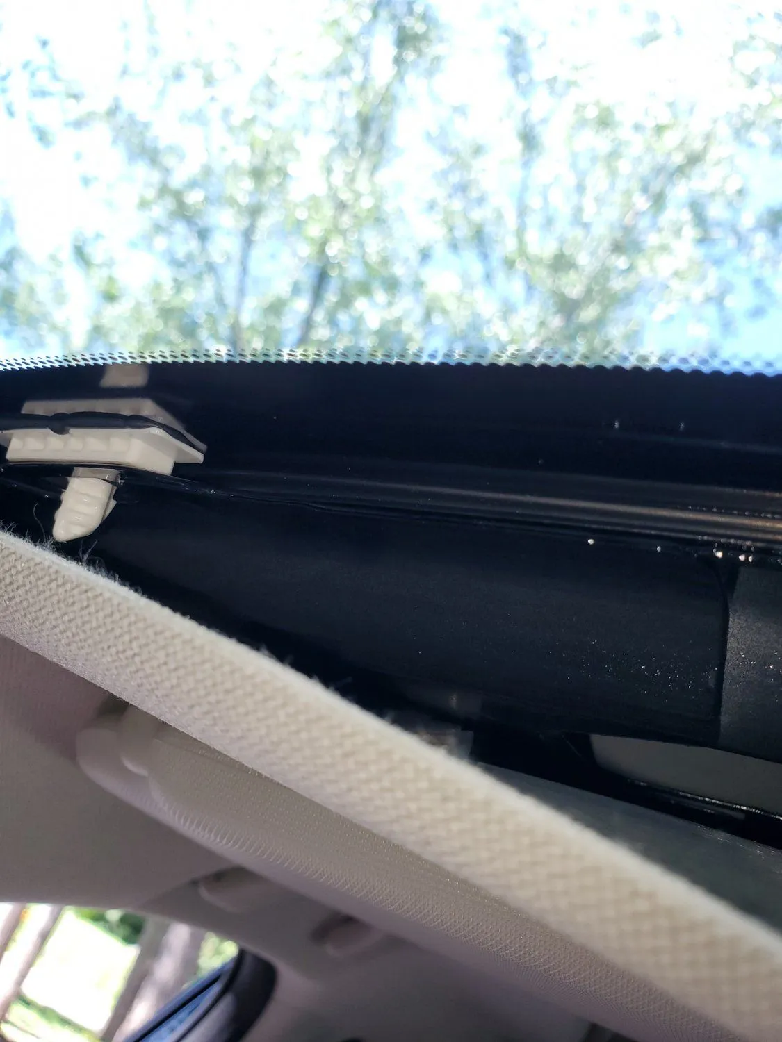

No problem! There should be a gap where the windshield makes contact with the metal frame. You need to fill in the gap with a rubber weatherstrip. THIS was the material I used in the photo attachment.

Oh ok! So it's like the windshield "ticking' on the metal frame? So you just jammed the weather strip in there, right?
Yes, when driving you can also try pressing your hand firmly against the upper portion of your wind shield and see if the noise goes away. You can pinpoint if the noise is coming from the driver or passenger side before filling in the gap with the weatherstrip. I only did the driver side and noise hasn't come back in 5 months.
Yes, when driving you can also try pressing your hand against the wind shield to see if the noise goes away. That was how I found out where the noise came from :).
