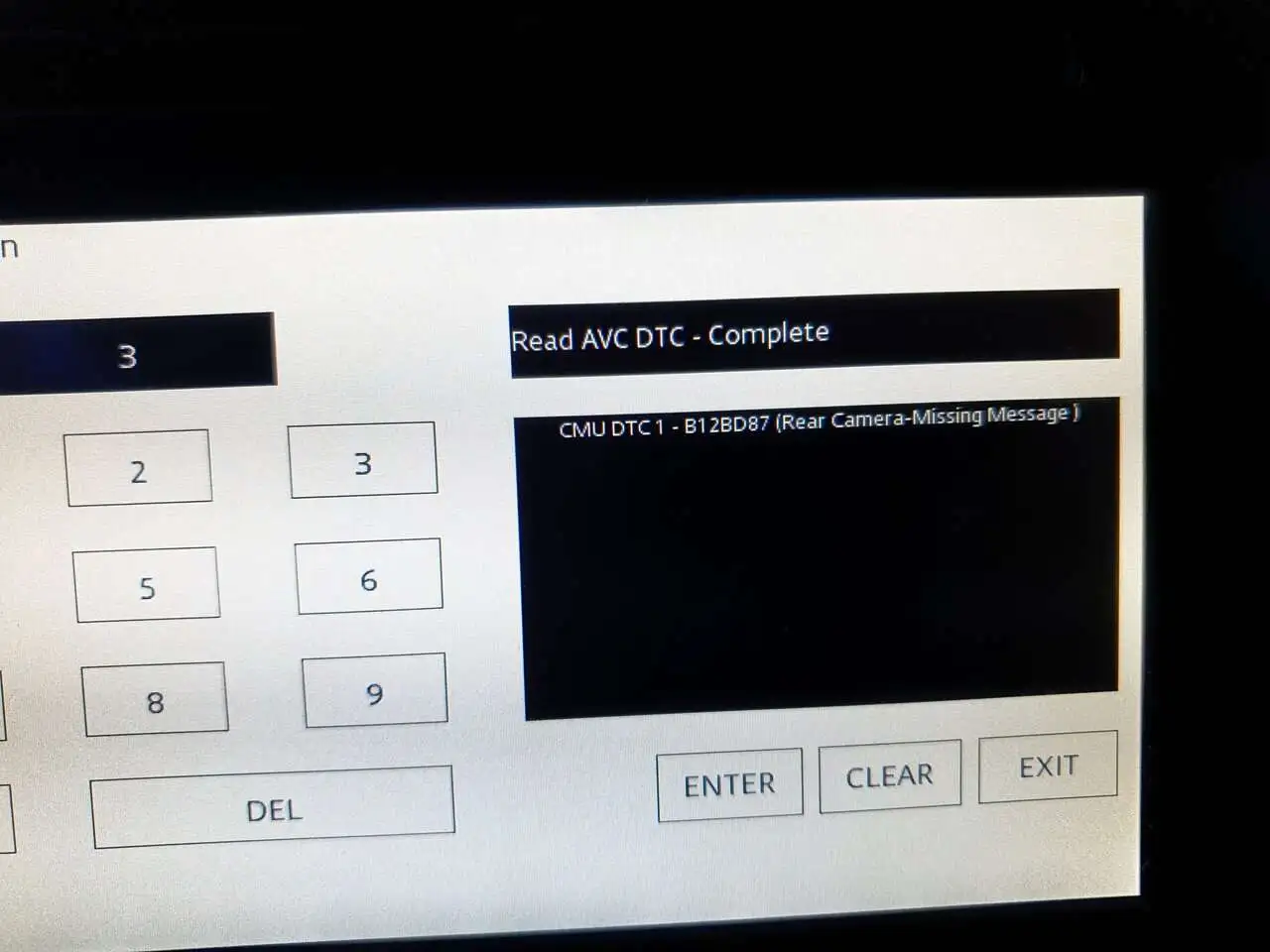

I attach pic of the fault
hi
2012 cx5 uk my camera has blue screen couldnt get the reset to work changed the camera no no blue screen and the camera still not working
how do you get to the screen in the above message
