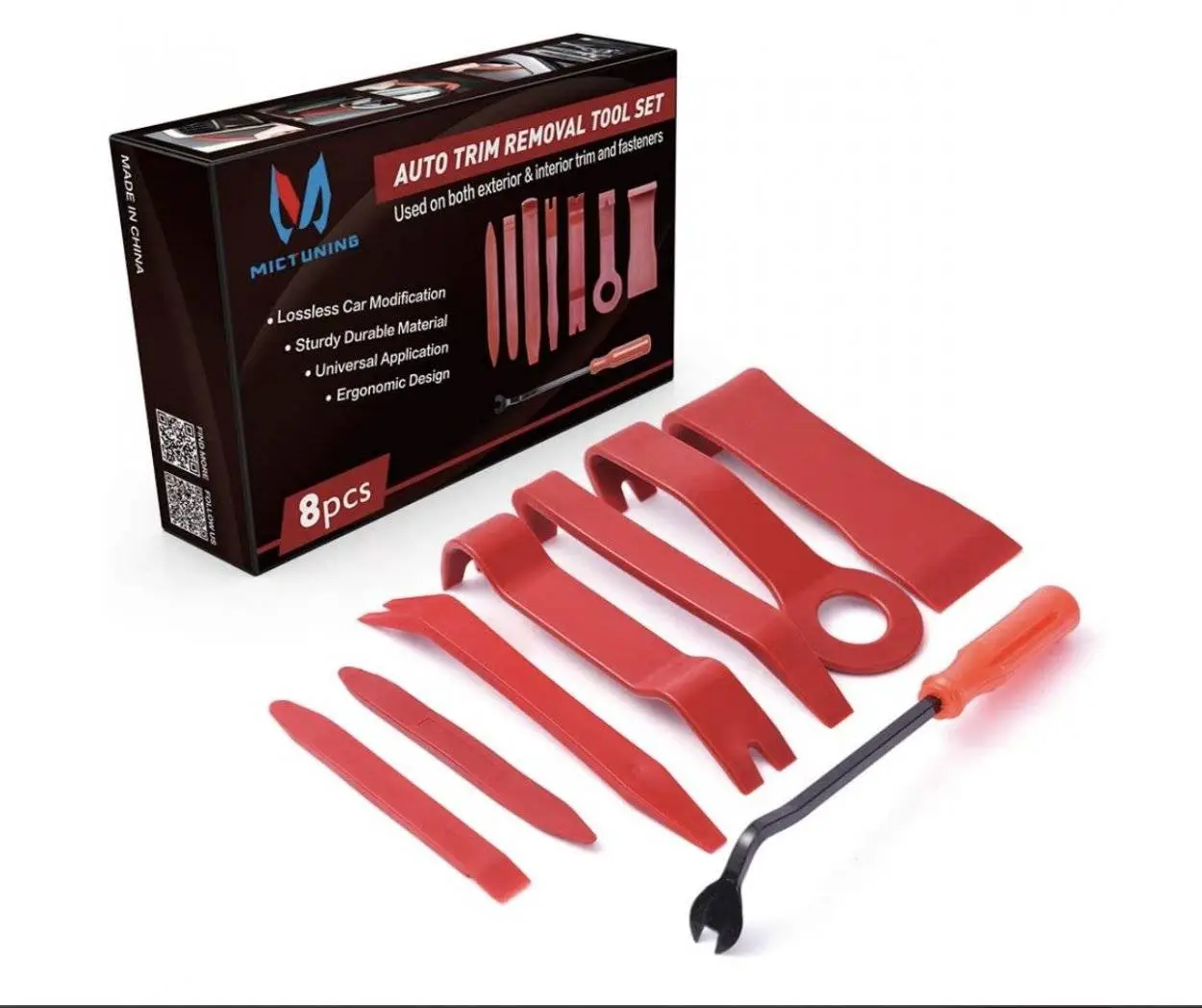

For goodness sakes, never use a screw driver! Use something like these special tools:
Upvote 0
I was going to put tape on the tip like they indicate in the service manual :)
.. but I can’t figure out how to lift it anyways, there’s no visible edge.
Upvote 0
and I'm afraid to stick a screwdriver in there to try and pop it, don't want to mark the trim :)
I hear ya, I'm the same way haha. I've scuffed and scratched many plastic trims on my older cars trying to figure out how things are removed lol.
Those trim removal tools are a good suggestion. If its an option, I would also try stopping by a specialty automotive A/V install shop and just ask them for their opinion on how to remove it. With any luck, they may have worked on a CX-5 in the past and can give you some tips.
