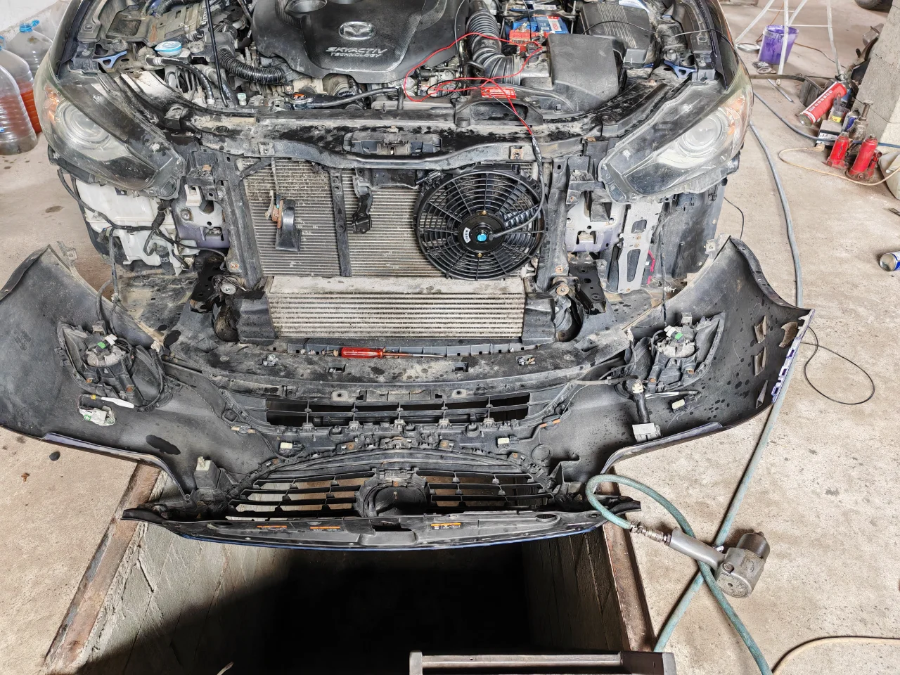

@Mazda_6III Hello we are having the same exact issue, 2016 Mazda 6 2.2 skyactiv d new head, skimmed engine block new headgasket,new termostat, waterpump and radiator cap...the car still overheats on long uphill runs, have you resolved your issue?
I put a fan before engine radiator who starts at 92 C and stops at 87C. Before that a had 105 Mac the max coolant temperature. Now the max it is 95. Engine 2.2 diesel skyactive
