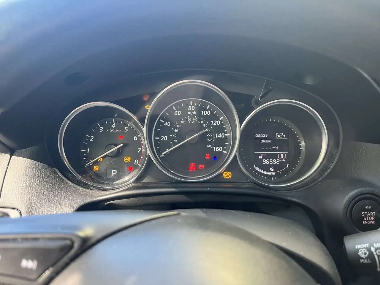

Hello guys. Last month, I had an Air Bag code 14 show up on my dashboard intermittently. It probably occurred 2-3 times, before the car blew the 7.5 A SRS1 fuse and went into complete limp mode. The power steering doesn’t work, and see picture attached for all the lights illuminated on the dash. When I replace the fuse, sometimes when I start the car the fuse doesn’t blow and the car runs perfectly fine. However, after driving the car 2-3 times (always randomly), the fuse blows again on start up.
To be clear, car starts and stops, drives and shifts perfectly every time no matter if the SRS1 fuse is blown.
As per the wiring diagrams, EPS, ABS (DSC), SAS and Traction Control modules are all connected to the SRS1 Fuse.
