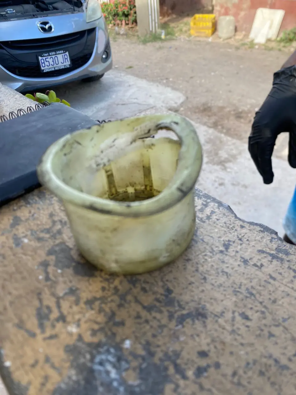

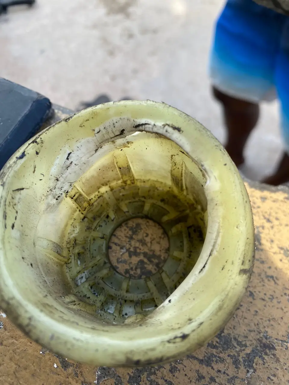

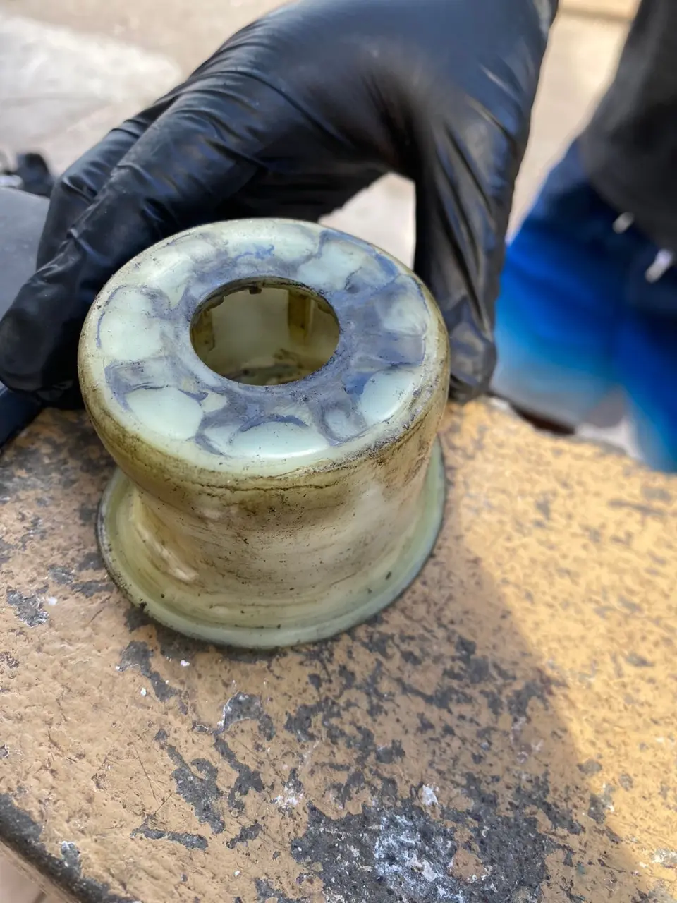

Good day, i recently replaced my front strut on my 2014 mazda 5but saw this between under the bump stops between the boot can anyone tell me what it is i searched everywhere and i can’t find it

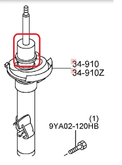

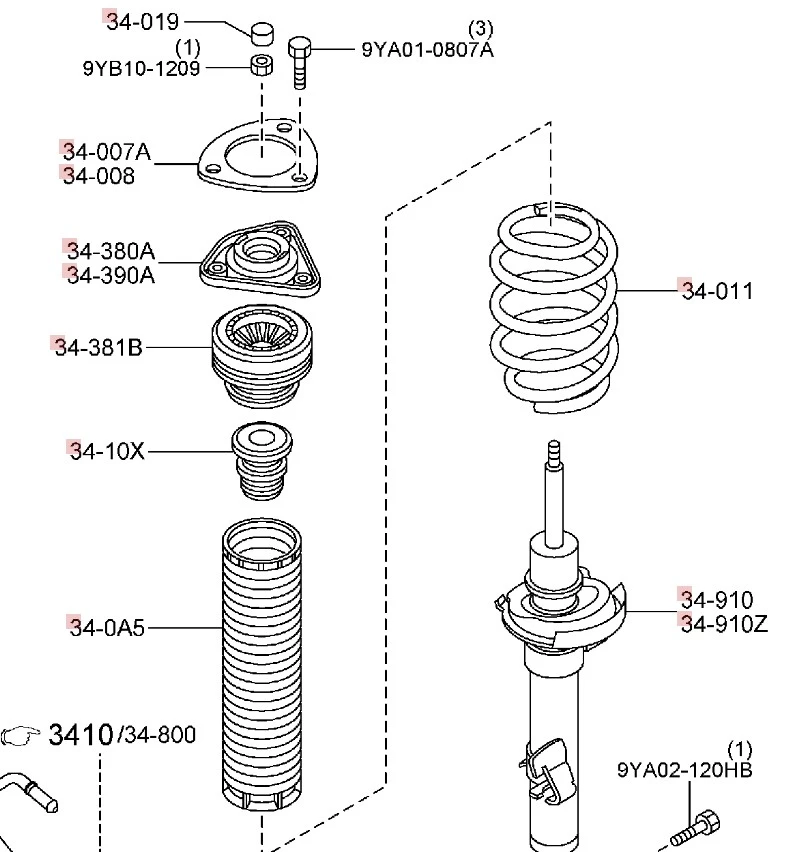

Thanks the response, but 34-10x is the bump stop and the part I’m searching for sits below it in the groves of 34-0A5
Not sure how the original part got destroyed like that!?...
What you are looking for seems to be sold as part of the strut assembly. It has tight friction fit into the strut base and the OD servers to hold the bottom of the dust boot in place.
I have Bilstein B4 replacements, which came with a new whatchamacallit part. Note, the Bilstein part OD does not fit the OEM boots but OEM's part ID did not fit the Bilstein base.

Thanks alot, i’ve been searching all over for it is it possible to state the name for it or the part number
