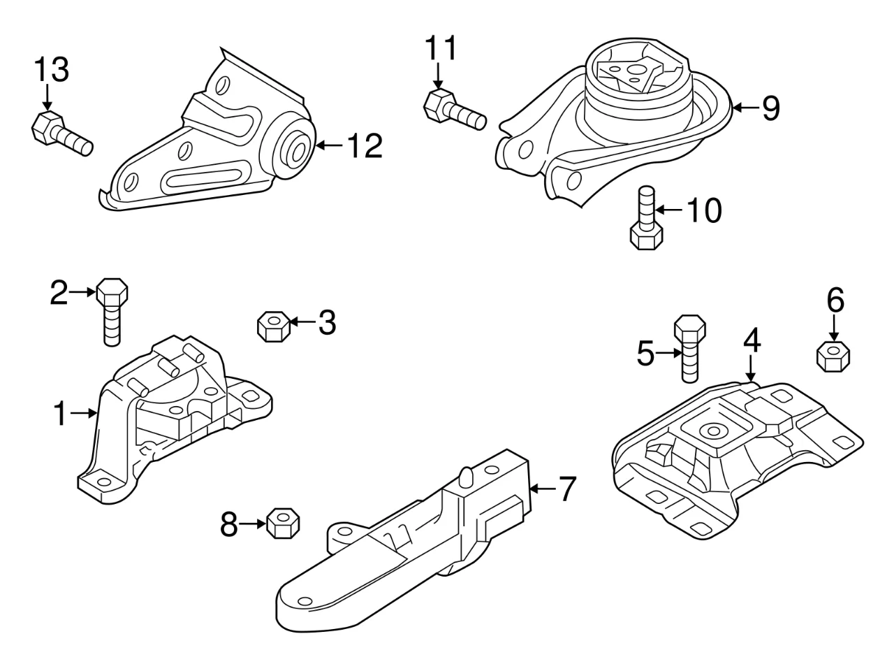

Guys, while we're at it, can you please help me find the torque specs for 3 bolts mounting the bracket to the engine, it's #13 on this diagram.
So far, what I've done:
2 - 65 lb-ft
3 - 50 lb-ft
5 - 85 lb-ft
6 - 50 lb-ft
10 - 75 lb-ft
11 - 75 lb-ft
13 - ??? (I put 50 lb-ft)

Hello again, I am back with the same issue but with my friend's 2007 mazda 5 - vibration, mounts are not good, etc. Where can one find this documentation with diagrams and torque specs? Gotta subscribe to some online knowledgebase to be sure?

The post above have toque specs. Google "Mazda 5 FSM" to find download link to the Factory Service Manual.
