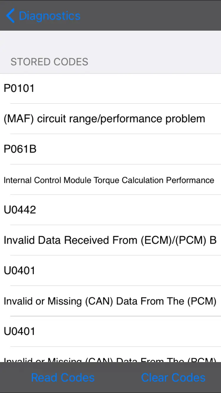

Last July/August had check engine light, traction control and tire pressure MIL on. Car was shuddering during any press on the gas pedal and I could only coast to side of road. An engine restart cleared everything except check engine light which went away after 2-3 starts. Problem recurred a few weeks later and dealer replaced the MAF. No issues.
Fast forward to today (approx 7 months, maybe 5K miles later) I am getting the same problem, and got a few codes (same as last time) which seems to indicate the MAF again (?)
The codes are:
  • P0101 MAF circuit range performance problem
  • P061B Internal Control Module Torque Calculation Performance
  • U0442 Invalid data ECM/PCM
  • U0401 Invalid or missing CAN data from the PCM
Does it seem reasonable that the new MAF could fail so soon? I have barely put 5K miles on it and its only been 7 months. Car is driven almost exclusively in city, but not in stop and go traffic (mostly doing around 30 Mph most of my trip which is only about 8-9 miles one way. I usually fill up at one of two stations (Chevron) and haven't noticed any other driveability issues with the car. Car only has about 50,000 miles on it. Engine air filter is about 2 years old and appears clean.
I'm wondering if there is anything else that could be wrong, other sensors, spark plugs, etc. that could confuse the computer into throwing a code for the MAF? In other words, is the MAF the problem or a symptom of something else? Anyone have a similar experience.
Extremely frustrated with this issue as I don't think this should be coming up again so soon!

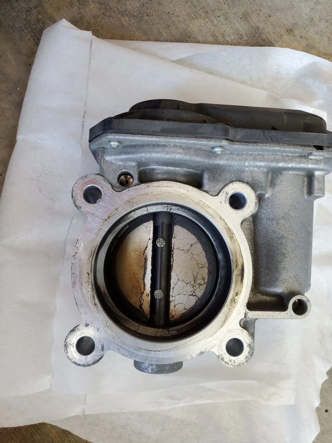

With my CX-5, I just had the same issue.
Turns out it is what is described in Mazda service bulletin SA-060/17 that affects some 2013-2015 CX-5s that experience the Check Engine Light ON with DTC P0101 and/or P061B with a possible drivability problem :
https://static.nhtsa.gov/odi/tsbs/2017/MC-10111035-9999.pdf
As described on that page, the repair procedures is:
  1. Disconnect the negative battery terminal.
    NOTE: In order to reset ECM/PCM learning of the value of throttle valve, do not skip this step.
  2. Remove the throttle valve from intake-manifold and remove any carbon on it by using a throttle body cleaner.
    NOTE: DO NOT spray any cleaner directly on the throttle valve to protect it. Spray the cleaner on a cloth and gently wipe off the carbon on both side of the throttle valve.
  3. Install the throttle valve and connect the negative battery terminal.
  4. Clear the ODB DTCs.
  5. Test drive the vehicle, including sufficient acceleration and deceleration.
The following is a good video on how to remove and clean a CX-5's throttle valve (note: the service bulletin recommends not spraying any TB cleaner directly on the throttle valve to protect it. Not sure if it is to protect the throttle valve shaft seal or lubricant? ) :
It was a pretty simple fix and if I'm not imagining things, my CX-5 now idles better and throttle response is smother.
So looks like some versions of the ECM/PCM firmware have a bug which results in the U0442 Invalid data ECM/PCM as it can't handle the throttle valve reading if there is a carbon build up. The latest ECM/PCM version 106.02 firmware is able to compensate for the carbon build-up. But I think it is a good thing that the Check Engine Light went on to let me know I should clean the throttle valve.
Doug, thanks for the motivation to rip into the TB. I was lazy and bought a MAF hoping that was the issue, then failed to continue on to clean the throttle body. Thing was gross with 110k miles under her belt. There was significant blockage while sitting at idle or low throttle. Now that I realize how badly the TB was, it makes sense that this is the cause of the low speed throttle response issues as well.
For those future folks searching and not sure about tackling the job, its super easy. Cleaning TB is much cheaper and faster than ordering a MAF. As doug said, I would much rather have cleaned the TB to increase performance than have the dealership update the software to ignore the blockage.
