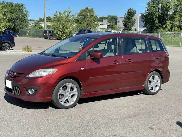

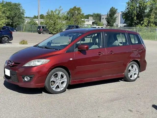

I've attached a picture of my 09 Mazda 5 GT just for fun!
