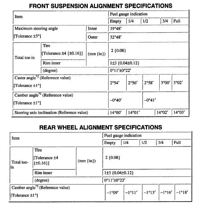

A little different from the regular 3
I was surfing and found that the finishline website has the instruction manuals for most accesories and mazdaspeed parts online. The attached is a copy of the alignment specs for a Mazda 3 with the Mazdaspeed coilover kit installed. I thought it would be the same but it is not.
Just some information for those that want it.
Cheers
Peter

Mazdaspeed Alignment Specs
Ok, I got bored - I like things orderly so I took the Mazda layout and applied mcb's numbers with a little interpolation for different gas gauge indications.
If I made a mistake - let me know - I'll fix it.
Cheers!
Peter
i got the sheet from shop manual and its not the same as the standard 3. I checked pmeilakjr number and they seem pretty accurate. I dont have the sheet with me so i cant tell for sure. I'll come back to you soon.
