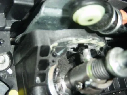

I noticed recently when shifting to 1st-2nd that the shifter was hanging up 1/2 way between like it wanted to go into R without pushing down on the knob. I pulled off the gearshift cover and found out why. The shift lever has a metal pin on the left-hand side that's designed to prevent you from going into R without pushing down. This pins rides up against the greased portion of the gearshift lever holder and should only allow you go into reverse if pushed down. Unfortunately, if you don't make a really deliberate effort to push all the way down, the metal pin will dig into the plastic and grind it away until you have a vertical channel worn into the plastic. And if you push to the left too hard when shifting into 1st-2nd, it will grind a horizontal channel into the plastic. I now have lots of shredded plastic down around the ball socket which I suppose could mix in with the lubricant and screw things up there too eventually.
The attached pic is pretty blurry, but if you look hard you can see the shiny pin and the channels that have been worn away. You can also see the pile of plastic dust that results, sitting on the ball socket.
Long story short is make sure you depress the gearshift knob fully before attempting to moving the gearshift over into R and be careful not to pull the lever to the left too hard when shifting to 1st-2nd. Personally, I think this mechanism needed to be designed to take a little more force without tearing up. This is a 6-speed, after all people will have a tendency to want to pull the gearshift to the left with authority to make sure they're not going into 3rd-4th.

I noticed this when I recurved my shift lever forward and to the left. Now I take care to push the shifter down and THEN to the left to enter Reverse slot so that I do not unnecessarily wear this area. I agree, one would think this mechanism would have been designed a little more robust. I would also like to see separate springs for left and right of center instead of the scissor spring that provides the same force in both directions. Having a lighter spring on the right side of center would sure make the 5-6 shift easier.

Yeah, plastic is taking over everything. I go to the dealer on Friday so we'll see what they say. Betelgeuse on M3forums says that he has 27k or some such on his, doesn't take much care to push down or be easy on the 1-2-R shifts, and it still looks pristine where the pin contacts the side of the shifter base. I then took another look at mine and the pin has kind of a rough surface on the end. I'm starting to think this is a defect instead of design flaw and mine should have a rounded or at least smooth end.

Stanyl may be a very good idea. Got the new shifter assembly installed and I don't think that my original shift assembly was defective. It's just a bad design. The tip of the metal pin on the side of the shift lever is machined flat. This means that with any substantial sideways pressure while shifting between 1-2, you'll be scraping into the plastic surface of the shifter base. The only thing preventing this is a little grease which should be quickly scraped off. Once out of the warranty the cost of repair should be in the $300-$400 range. I'm curious whether the short shifters out there do anything differently. Just rounding off the end of the pin a little would probably make a big difference in terms of avoiding wear.
