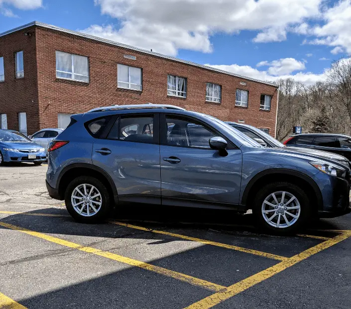

got my miata out of storage and finally and its warming up here in Mass. Put the NC rims on the cx-5 all seasons and they work great. No issues at all and same stance as the CX5 rims, which are now mounted on my winters for the long term.
They look good on the CX-5, a nice subtle change.

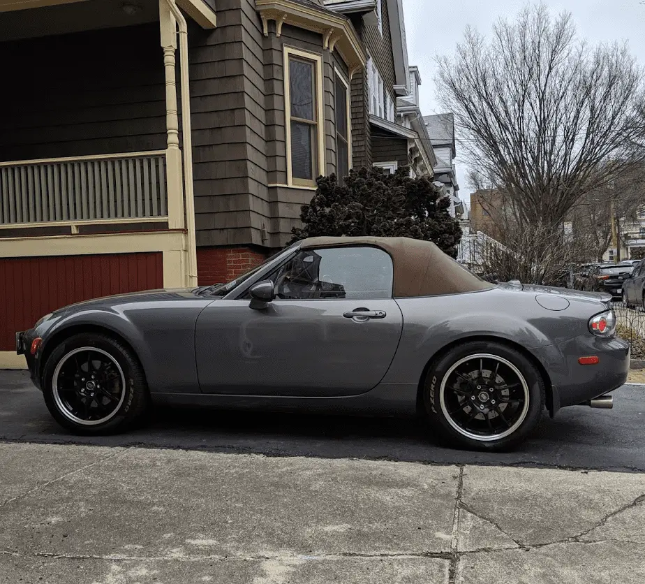

What wheels did you get for the Miata?
