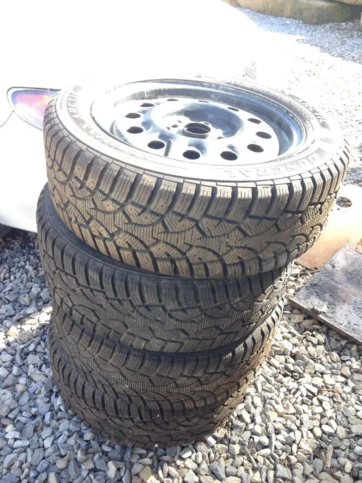

I found a set of 4 pretty much brand new MOUNTED and BALANCED on steelies with the general altimax arctic... 100 bucks... what are your thoughts on those I think that it is a really good price. especially since they are mounted and balaced already.

$100 for a set of wheels with new tires? I'd be all over them
Oh I am, its a 4 hour drive but it is worth it I think. wheels and tires mounted and balanced for 100. He said he only used them once. They look brand new.
The General Altimax Artic is actually a very good snow tire for the price. That price for the tires and wheels seems hard to believe, though, but you can get them, do it.
Thats what i thouht a first. I guess he has been sitting on em for a while and had em on ebay for starting price of 100 and buy now for 225. I messaged him and said whats te best deal you can do if i drive all the way to get em. he said throw him 100 and cone get em,
He doesnt need them anymore becuase the car he had them on (2003 protege dx sedan, same as me) the engine blew and got rid of it.
Congrats on an excellent find. Luck was definitely with you.(2thumbs)
I like to think so! I think the are OEM Protege Wheels as well.
