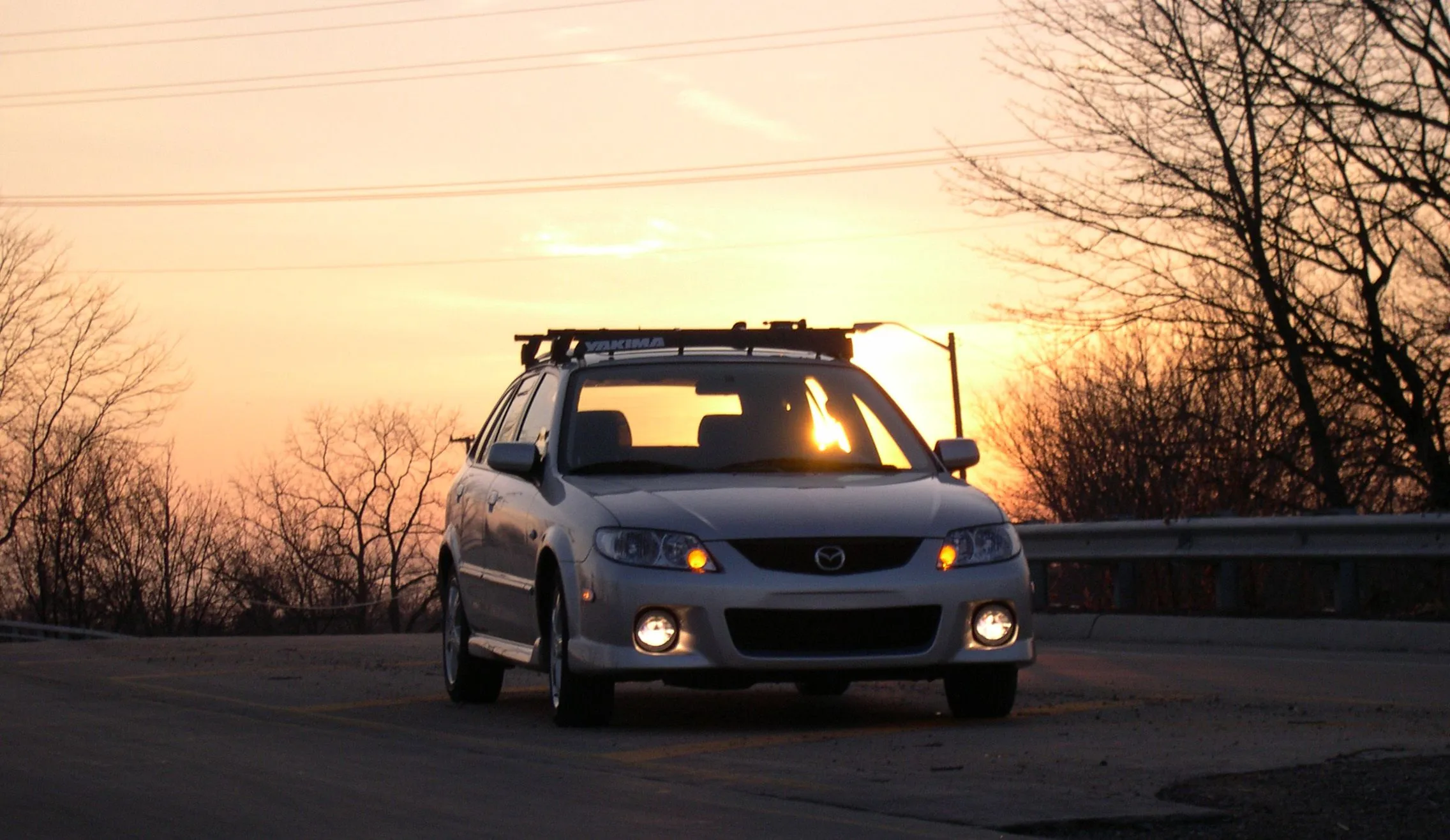

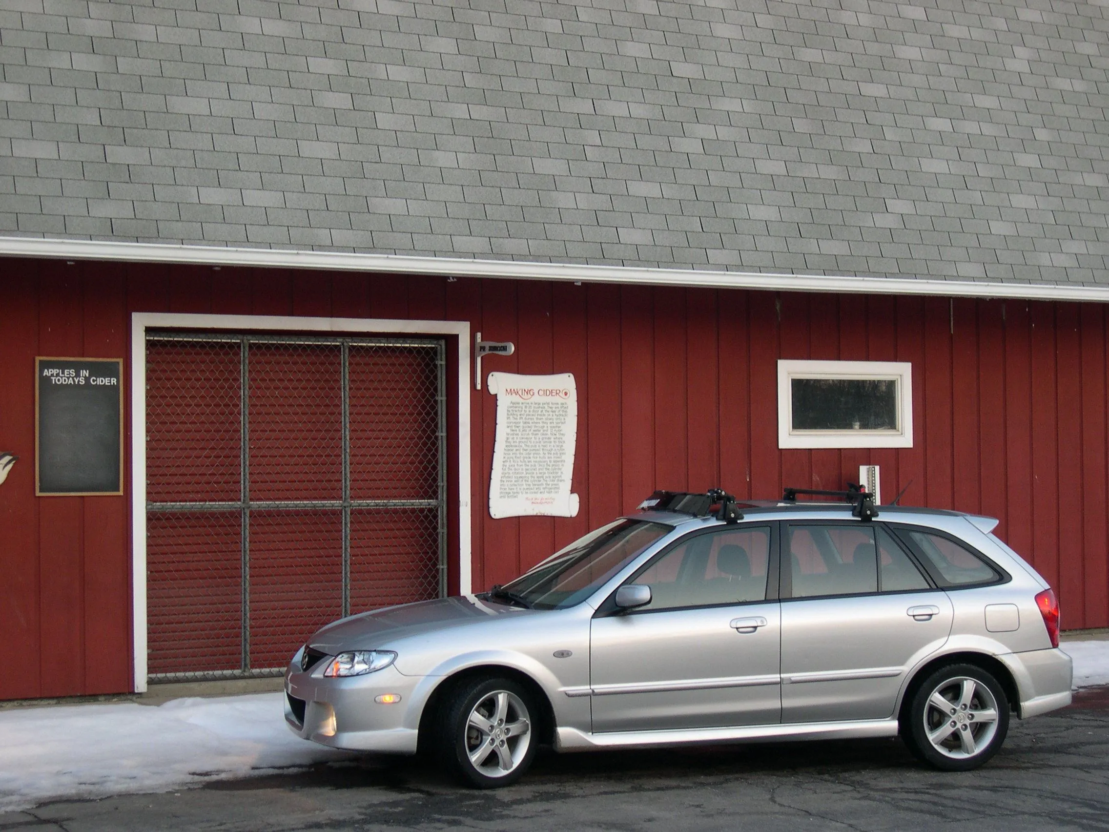

Here are some pics of my rack with the bike mounts. I don't have any with the kayak rack on.

There, that's what I'm talkin about in that picture above. Haul 2 like on the yellow car with hullaports & a single like on the other car. I also have an abs aero cargo box for 2 sets of golf clubs or actual cargo & the xport bike racks for on top & the saris bones strap on bike rack for the back if hauling boats at same time & pads/straps for surfboards. All for less than the yakimas. The kayak racks also come in handy for carrying other items. Some of these can even be combined to carry lots at same time.......

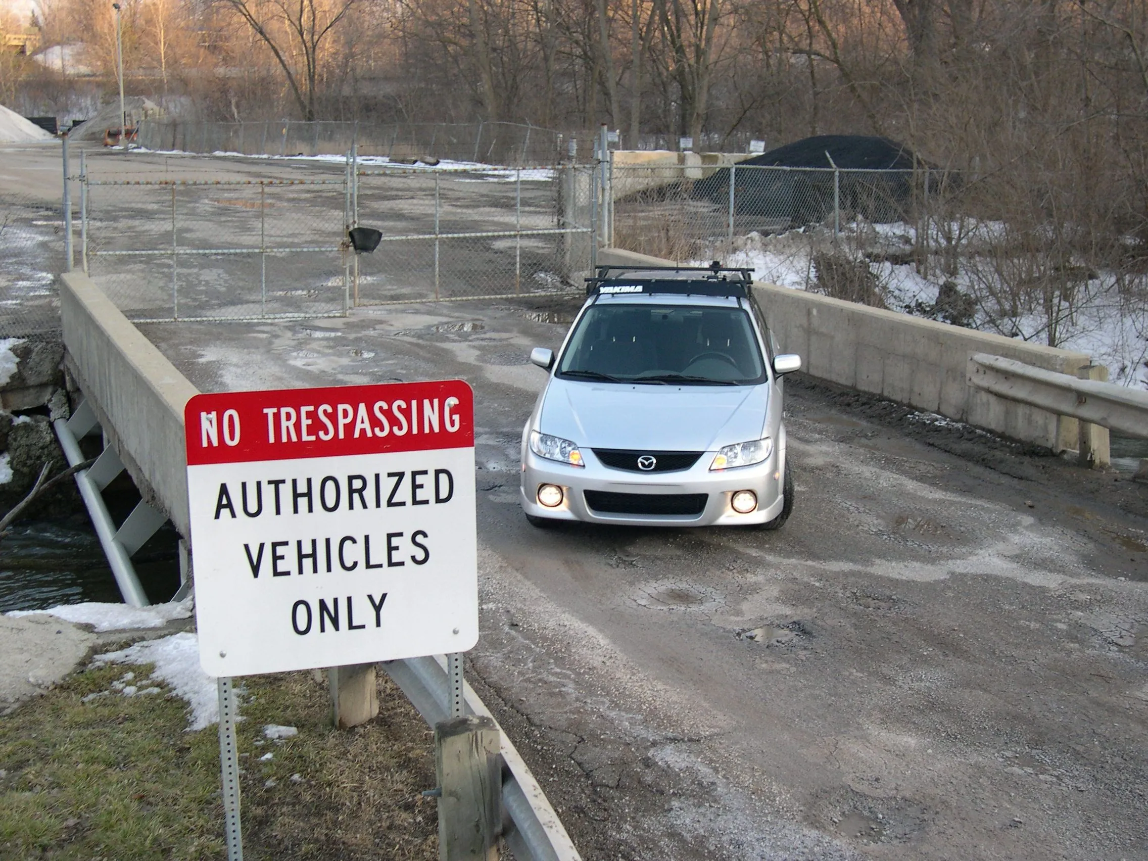

I thought I would post some pics of my P5 with my rack on.

the tortoise said:
^^^ Damn, that must have been fun!! And maybe a tad scary ^^^
Yeah it was fun!! not too scary cause I am from here and I grew up on that particular lake so I knew that I was going to be ok. Plus the ice was like 1 1/2ft thick.
