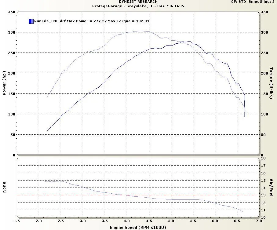

Stephanie, now that Compact Car is reporting a 20 hp increase with just the air box cover off (which is how the BEGI Exede dyno run was made), will BEGI be offering a dyno graph and hp increases of the Exede only, without the effect of airbox removal? Seems like the right thing to do.
we did a dyno of the car down in hawaii with the stock airbox fully intact, i'll try and make time to post it tonight

ha ha sorry - with the air box cover on we dynoed at 277whp and 302 lb/ft tq. i am surprised playing around with the stock airbox like that has not caused a CEL code.
Thanks for the chart, Captain. That's a LOT of power. Nutari posted some more elsewhere and says regarding the baseline: "i lost the file. Base run was about 240whp and 260~tq." So, looking at "about" a 35whp/40tq gain, with the stock airbox on. Stephanie posted elsewhere that their baseline dyno was "... 240 hp ... with the Air Box lid off [and] ... 231 hp ... with the lid on." So, it looks like taking the air box out of the equation yields about 10 hp. It'll be interesting to see what adding a CAI into the mix does.

So that 277whp and 302wtq are with the xede and the ETS TMIC?
Or is that the xede on an otherwise bone stock car?
XEDE and ETS. intercooler alone showed about 10whp gain to stock car as it was dynoed and XEDE alone showed 271whp gain. keep in mind these dynos were done back to back and also done in a climate 40 degrees warmer than when the BEGi dynos were done. to see if climate, etc really is a factor, we are scheduling a dyno for our customer up near Rhode Island who has the XEDE now and a TMIC on order.

Assuming 15% drivetrain loss, that's like 320hp at the crank?
I agree completely. We had to remove the lid so the car has some air flow. The cover for the IC also came off so we could place fans on it. However, I was not there while they were tuning it and I cannot identify which run was what. If I knew, I would be happy to post it.
Next time the car is on the dyno, I can do a few runs with lid on an Xede only.
