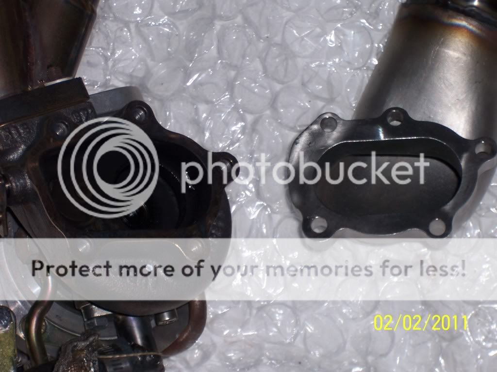

i dont think it is. i just looked at the garrett website, both the GT2871 and the GT2554 have three of the five bolts on the bottom.

no its not the same it does have the 5bolts but it does not line up at all and i got the stock spipe beside the turbo to make sure it forsure does not fit

Edit: Hmm.....looks like he was correct in saying it wouldn't work.
yurp told ya. just get the flange and misc. pipes and any half way decent muffler shop or maby a performance shop in your area culd just make u a new downpipe. i was quoted at 50 bucks to fabricate it if i had the pipes and the flange (which shouldnt cost you more than 100 bucks total)
OH WHAT THE ****! does this mean its going to be longer for me to install my gt28r? i just matched it up and i have the same bolt pattern as in the picture, and that aftermarket down pipe wont fit it, but is that same bolt pattern as stocker?
it look like the stock pattern just turned 180 its the first time i've seen one like that. Post a pic of your's i dont think you should have a problem my 28rs has the stock bolt pattern and so should yours its the standard 5 bolt t2 discharge pattern
ya i see what 2003 speed is sayin it does have a 5 bolt pattern but the pattern does not line up its almost like the bolts are slightly closer together
i think its the right flange but it needs to be flipped which means ur gonna pay for the appropriate housing or buy the flange and have a dp made(both previously stated).
word well probabley gonna just order that new peice cuz im thinkin to get somthin custom made is gonna be really expensive
