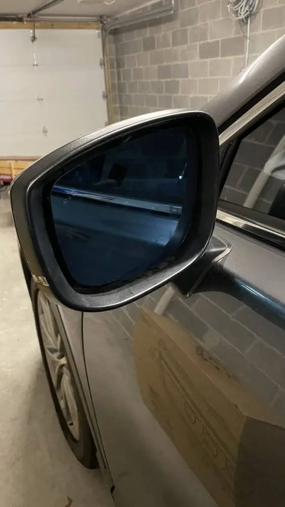

They aren't cheap but they are of good quality with all of the extras available such as heating and BSM, plus, both sides are blue tinted, making them excellent for day time use and much better for night driving than our current auto dimming, drivers side only, mirrors. They totally reduce glare while still allowing for perfect sight at night.
As I've said before, I have had them on my MX-5 for a couple of years and am a real believer. I am looking forward to installing them on my 2018, CX-5.

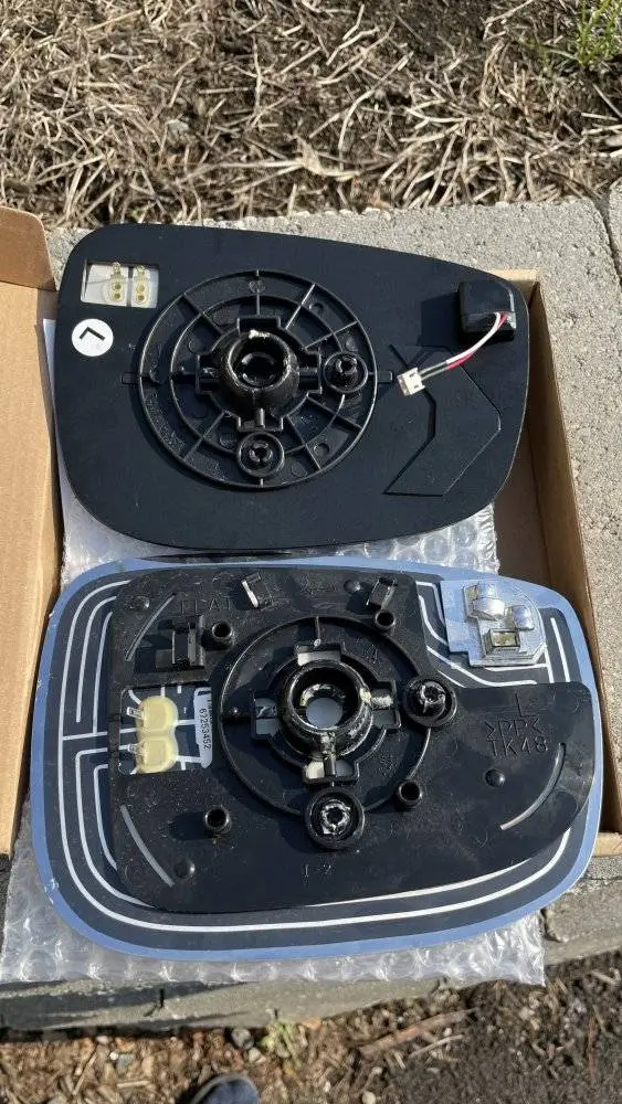

Following up on this, it seems that a few CX-5 owners and at least one CX-9 owner have received the wrong mirrors. See below:
Still no one doing business with Suma have gotten the right or wrong mirrors for their 2nd gen CX-5/CX-9?
I really would like some feedback on a positive or negative note.
It is my assumption that Eddy never got the mirrors for the 2nd generation CX-5 or CX-9 models. The ones he sent out were only for the 1st generation CX-5 models.
Can anyone verify or deny my assumption?
I am very surprised that there isn't a big flurry of anger right now. Or, perhaps everyone has gotten their refunds already.:) Or better yet, there were only 2 of us who got disappointed with Suma.

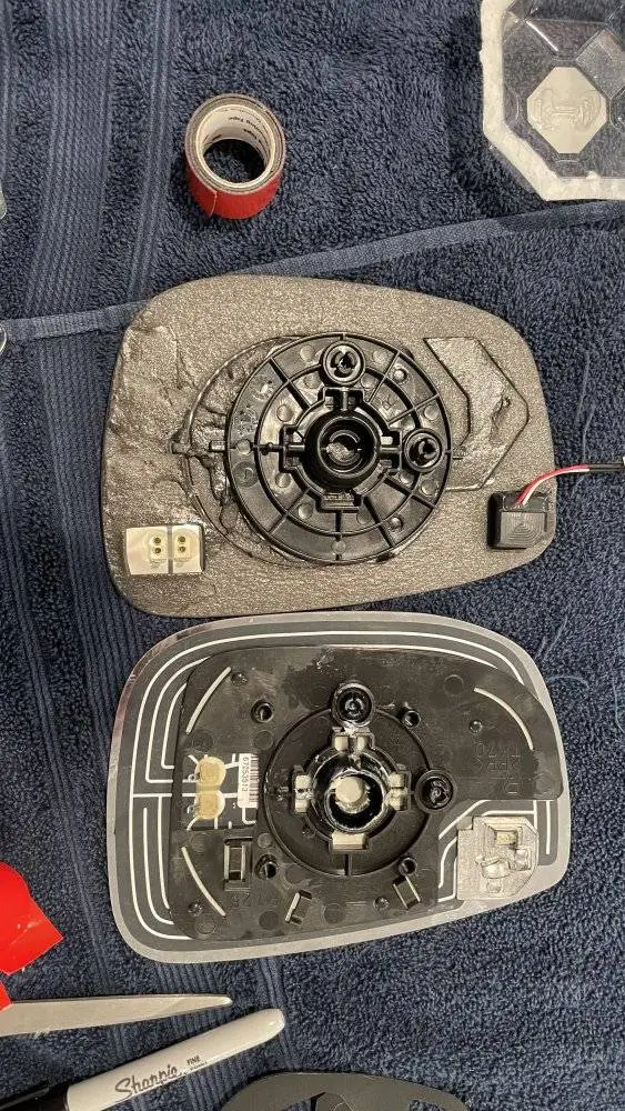

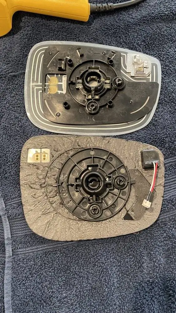

I am in no way condoning the way Eddy does business, nor am I suggesting that anyone be content with an incorrect product being sent out. Eddy has been very unprofessional and unresponsive in his handling of this whole debacle and I would advise anyone who chooses to do business with him to expect something to go wrong. This is the second set of mirrors I have ordered from him and this is the second set of mirrors that were sent incorrectly. He doesn’t seem to even understand what went wrong despite multiple people sending him pictures. I doubt he will ever be able to produce the correct mirrors because he refuses to admit there was a problem. However, I had a broken mirror and like the added visibility and glare reduction these offer.
After doing some comparison, the gen 1 CX-5 mirrors are ever so slightly smaller than the 2nd gen CX-9 mirrors. The biggest difference is the mounting bracket is about a half inch off on the horizontal axis.
The bracket, as well the plastic surround, is held on with VHB tape. With a sharp knife and a little heat, you can remove the plastic and the bracket. The plastic doesn’t need to go back on as far as I know. I used some VHB tape I had already and stuck the bracket back on but in the same spot the stock one is. Added a little heat to make sure it was really stuck and then installed them.
