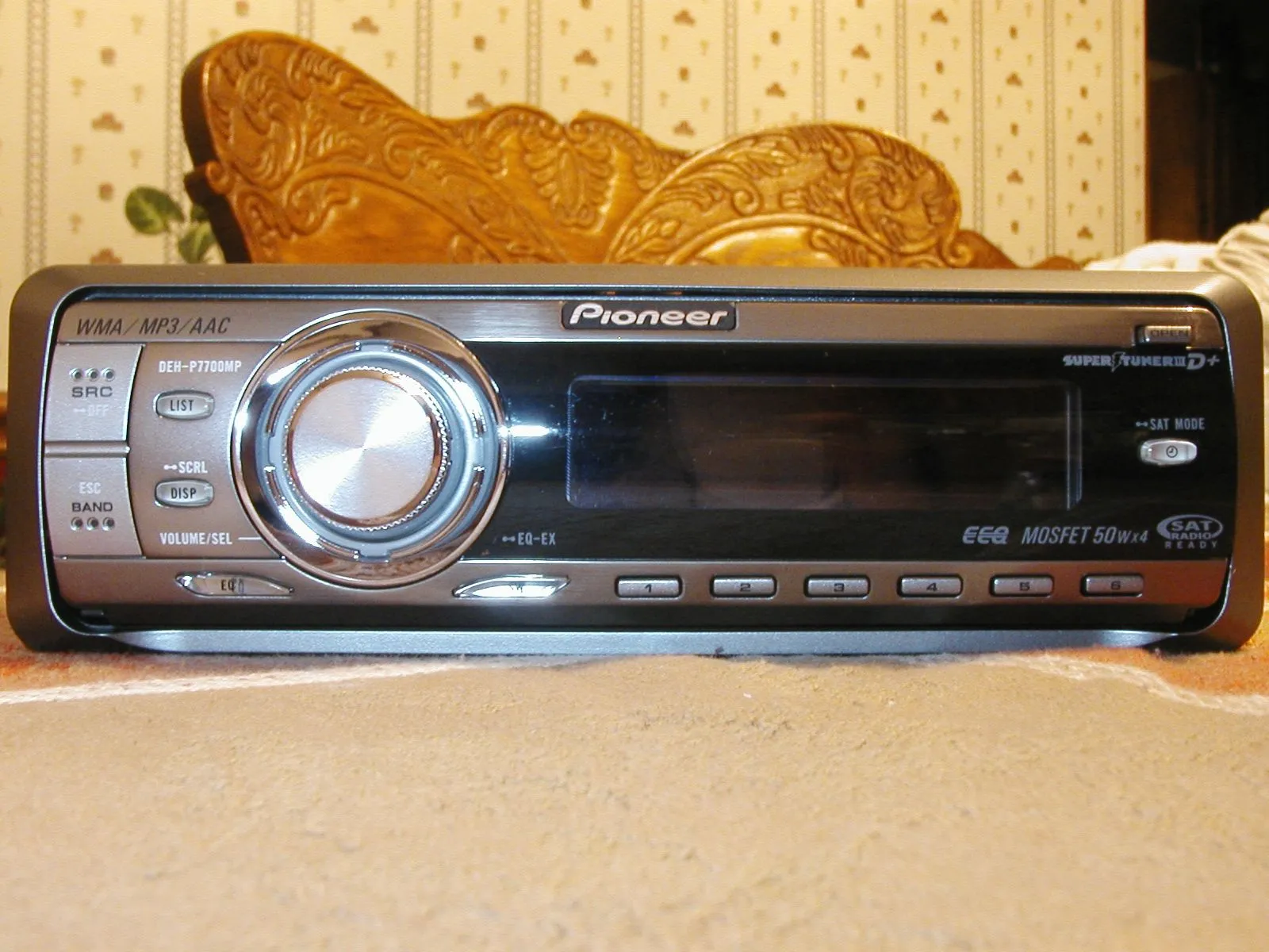

Well the pioneer premium DEH-P7700MP is ordered sounddomain had a killer deal i had to get it. They had it for $209 at best buy its $269 plus I got the free install kit,free harness, and free connectors which is more then 40 dollars at best buy. To my door it was $220 so thats a great deal if anyone else is looking for a new head unit.
This thing looks even better in person I love it cant wait to hook it up.

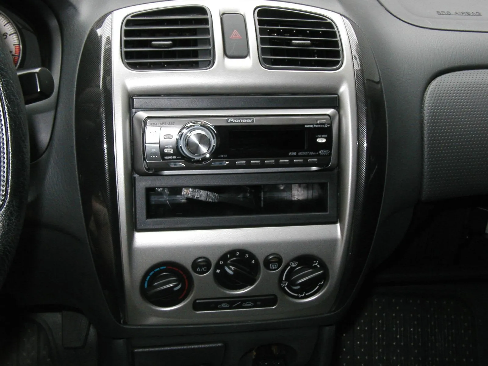

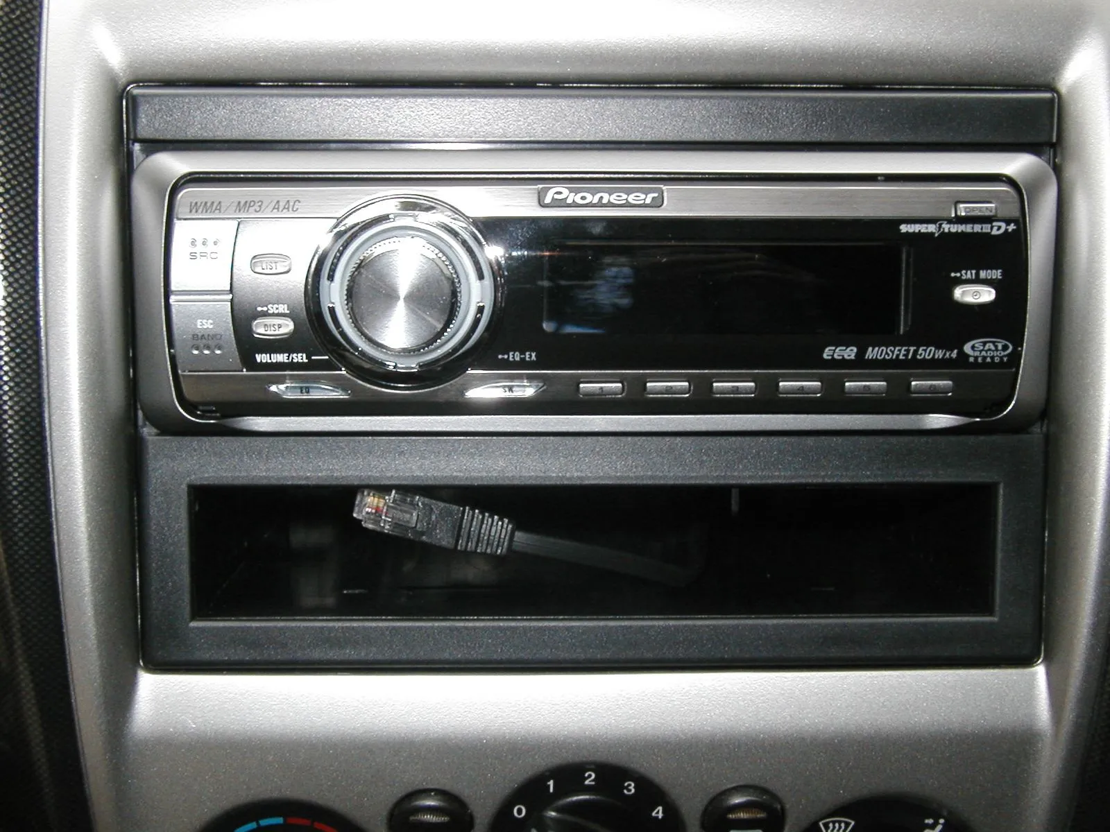

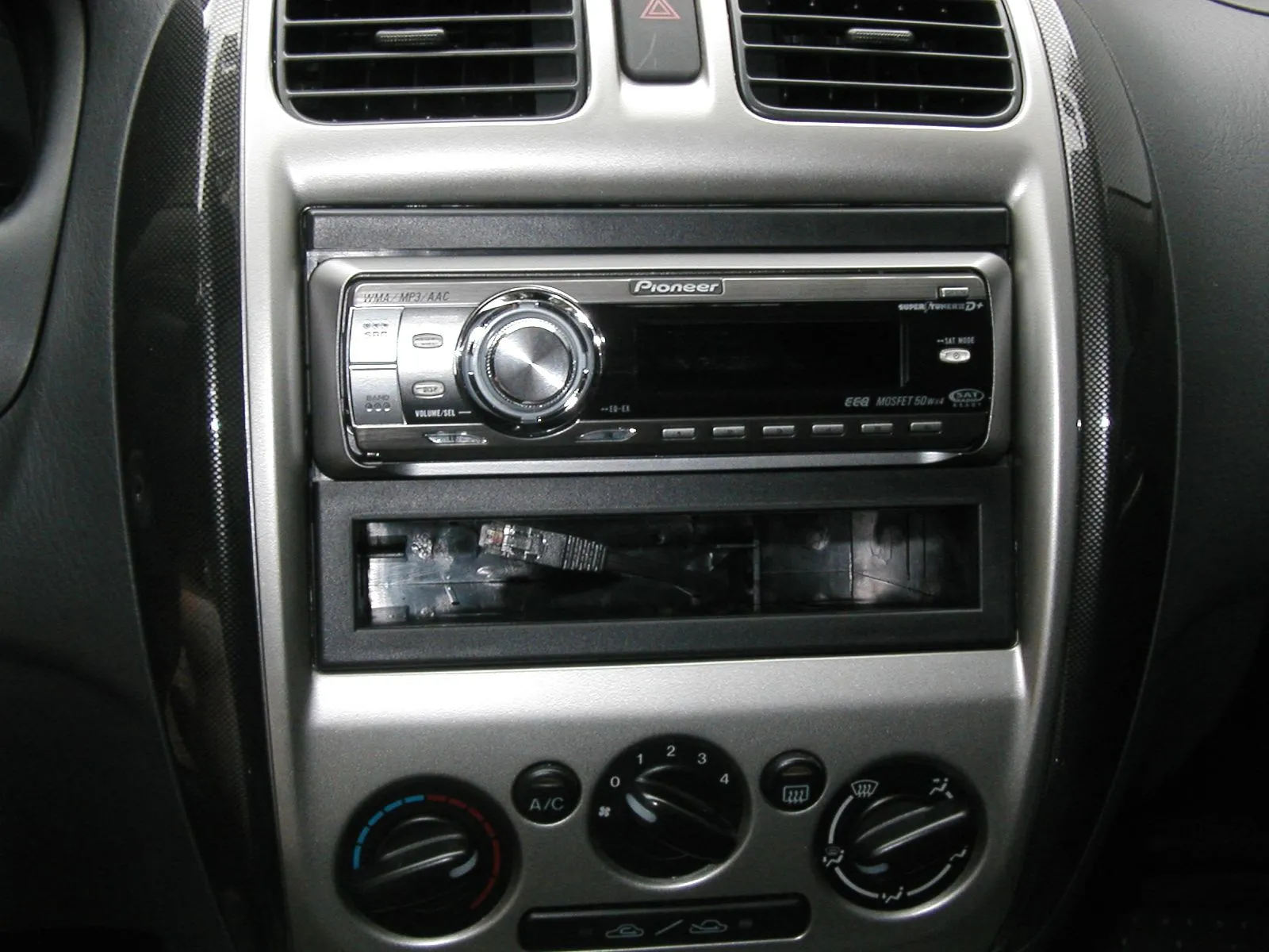

Here it is installed but i still have to hook up the harness waiting to get it on tuesday.
