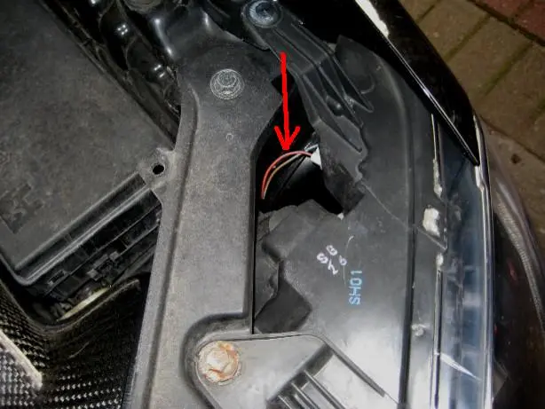

So I just recieved the predator chromium angel eyes from umnitza but I have a quick question about wiring before I start taking apart my headlamps and stuff...

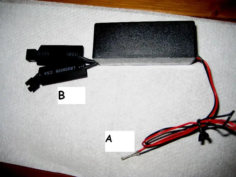

If I want to wire them to the parking lights, then should I take the wires from the ballasts (A) and t-splice them into the parking light wires indicated in the pictures, or do I have to connect them somewhere else?
Also, it says to shrink wrap the connection between the rings and the ballasts at (B) but does that involve the silicone gel? and how do I shrink wrap it? with a hairdrier??

Yes if you want them on with the parking lights then you'd tap off of the wiring from the parking lights. Alternately you could use a relay and make the parking light wire the signal wire and have the DDE's draw power directly from the battery.
Shrink wrap is purchased in different sized tubes. You slip it over the connection you're making, for instance two soldered together wires, and then you heat it up (hairdryer, heatgun, lighter, etc.). When heated it shrinks down and molds itself around the wire. For example here's where I soldered together wires for my LED puddle lamps in my mirrors and then covered it with shrink wrap. Each connection is covered and then I put another piece over the whole thing.
