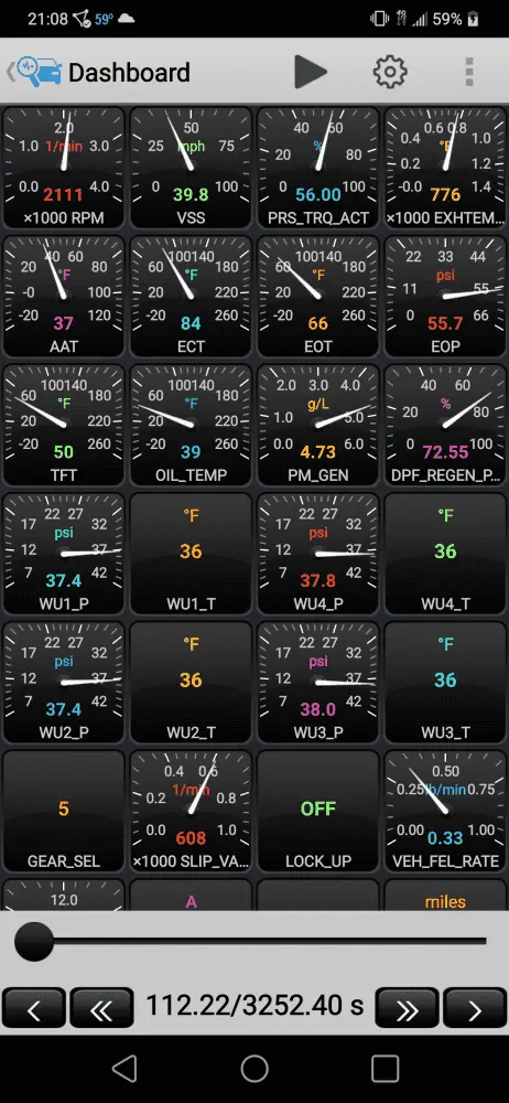

Here's a screenshot, as an example, of the page I run. There's another row or two of data below what's in the screen shot.

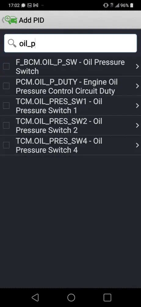

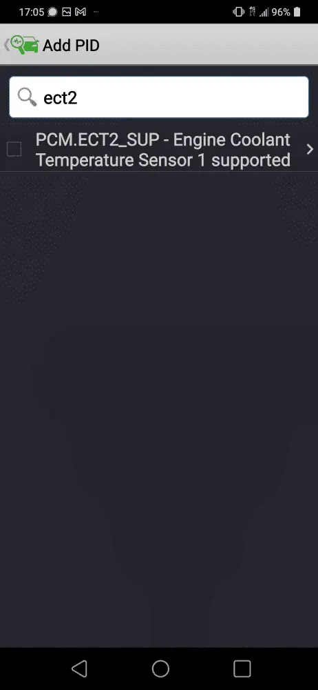

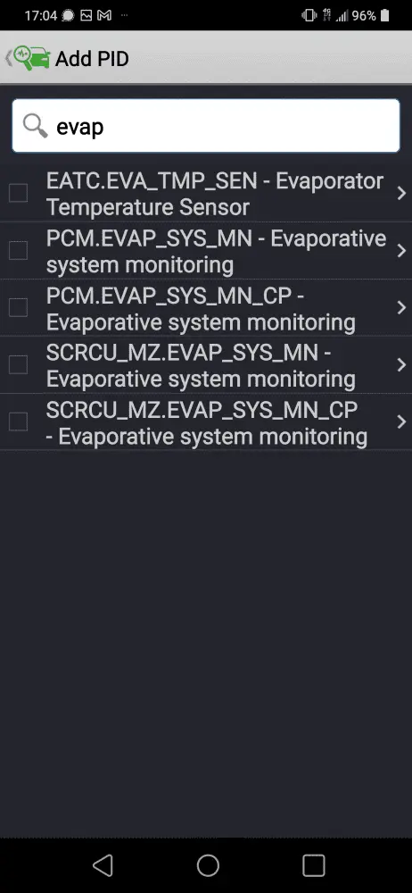

OIL_P_SOL; OIL_PRES; VT_IN_DES; VT_IN_ACT; VT_EX_DES; VT_EX_ACT; ETC_DSD; ETC_ACT; EVAPCP; EVAPCV; FUELPW; ENG_CL_V_POS; ECT2_V
@edmaz , no trouble at all. I did a PID search by entering the first few letters of your requested examples. Didn't come up with any of them specifically. I wonder if those are specific to a gas engine? My FORScan lite appy won't show any PID's unless I'm actually hooked up to the vehicle and communicating making me think it gives me the list of available PID's to choose from based on the vehicle. (Mine being a 2019 cx5 diesel).
My Dad has a 2021 cx5 GT (whatever they call that trim now) I could try hooking up to next time he's around to see if I come up with those PID's on his newer gas powered (NA 2.5) model.
A couple screen shots for you ...
