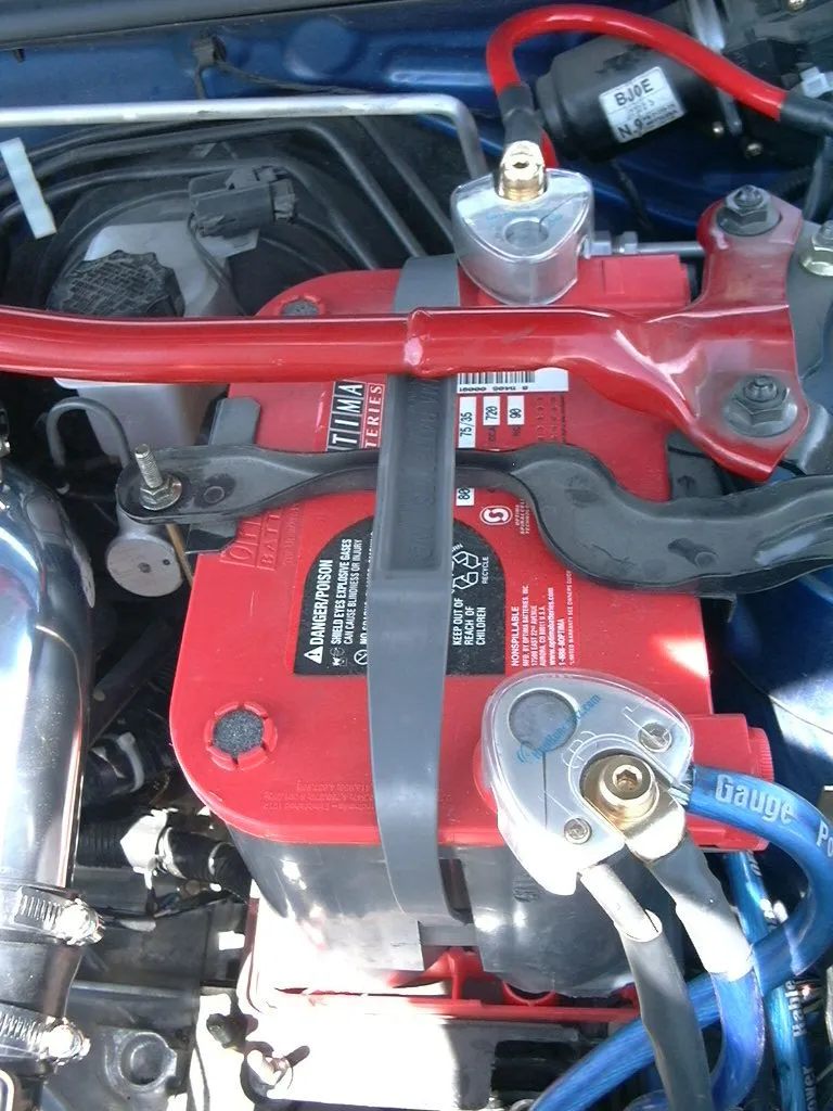

  • Positive Battery Terminal -- how do you get this thing on? Is it easy? Anyone have pics? How does it connect to existing car's positive battery terminals? Or did I waste my money on that terminal?

Not sure exactly what you're asking about the batt terminal bit, but here's what mine looks like. Basically you just cut off the stock terminal as close to the end as you can. I've got the full 1sty groundwire kit that also upgraded my power wire to the fusebox, That's the large blue one that's on the screw-terminal. Prior to that, I had both that and my alternator cable in the left side hole.
BTW, that's a nice picture, thanks! It appears that you tighten the terminal around the post with the screw, I wasn't sure whether that was the case.
I guess I'll see what I can do with the current connections. Right now, in addition to stock wires, I am running my 4ga audio cable (fat ring terminal), and a 12ga connection for my air horn.

As for the terminals. they're all metric allenbolts. There's a 5mm on the side that clamps it onto the battery post. If you don't have metric allens, get some.
And I really wouldn't worry about fitting all of your wires. The right side's designed to fit 0/1g, and the left side's 4g I believe. LIke I said, I HAD both of my stock wires inthere with room to spare. It'll likely fit your airhorn wire too. You can always "stack" ring terminals if you run outta space.
