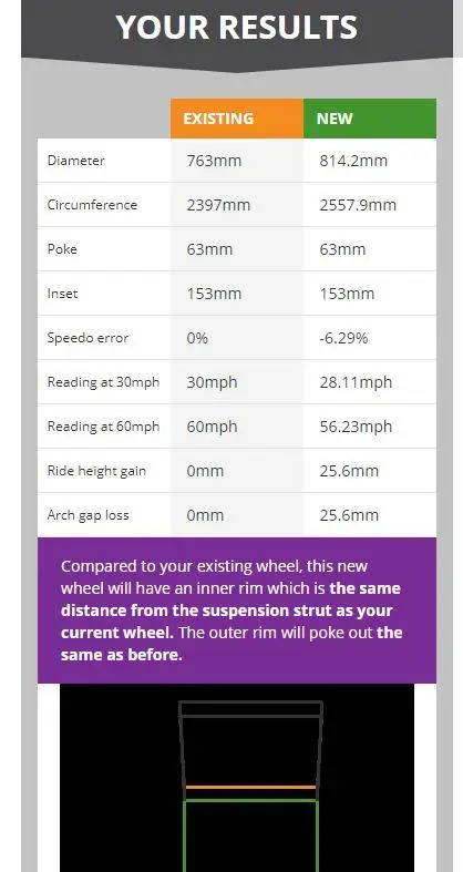

Hi all, just wonder if 255/70/R18 winter tires will fit a 2021 CX 9 Signature trim? The factory tires are 255/50/R20. Right now all 255/65/R18 and 255/60/R18 are hard to source. Thx in advance!!!
Hi @DavidYen, 255/70/18 should fit just fine. Assuming that wheel width and offset are the same as the OEM wheels, the only difference would be the overall wheel diameter.
The last four stats detailed are what you need to be aware of. The arch gap loss means that the tire will be 25.6mm closer to the fender liners than the OEM setup, but again, as long as the rim's width and offset are the same as the OEM wheel, there is plenty of space to work with.
One other consideration might be a slight loss in acceleration. I've never moved to larger overall wheels so I'm not sure how noticeable the difference may be, but maybe others can chime in.

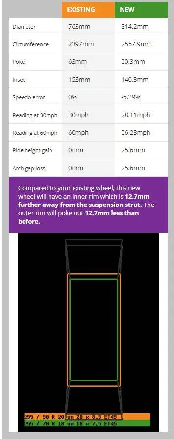

Thx sm1ke for prompt response. I have gotten an used set of wheel from a CX 9 for winiter tires and the dimension is 18x7.5.
Ok, those wheels have an offset of 45, which is the same as the OEM wheels from your 2021. If you test-fit the wheel, make sure the spokes clear the brake calipers, but I think you should be okay.
Here is a comparison between your existing set and the new set:
