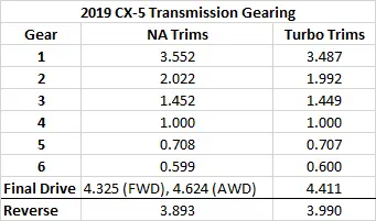

Just to add some chit-chat data to that observation (because I love winding this car out in 3rd gear...it shoves me back in the seat and makes my mileage suck):
