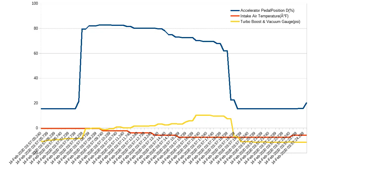

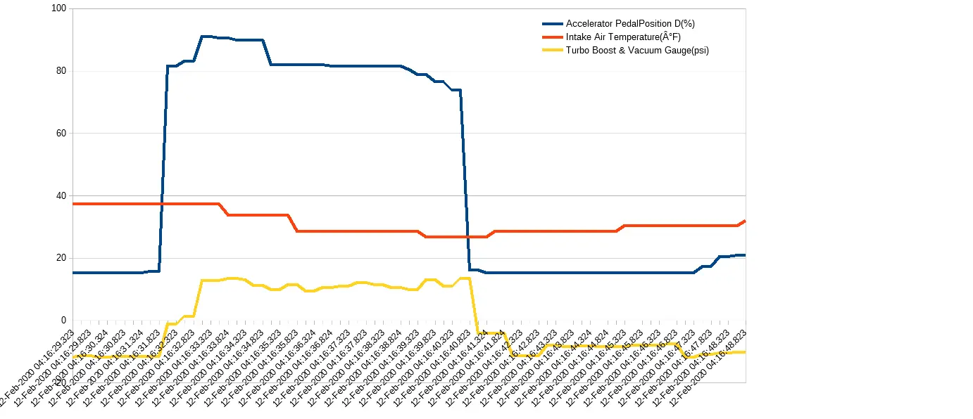

No, I didn't set anything vehicle specific in Torque. Maybe some OBD Bluetooth adapters only read certain sensors? And thanks, I'll try that for the graph, though I use libreoffice rather than Microsoft office. Should be similar.
And the first graph was wide open throttle, I know it doesn't go up to 100, but I had the pedal pushed past the detent. There are 5 or 6 sensors related to throttle/accelerator.

I'll have to look at my TorquePro app again.
My reader is a higher-end one...ScanTool. It should read everything that's available. I've said before I also grabbed the ScanTool app, and they offer an extra-cost add-on for Mazda-specific PIDs. They're still futzing with the 2019 PIDs.
Which throttle position did you log?
Do you have PID Throttle Position (Manifold) as an option? That should be throttle blade position on the intake.

Are there oil temp sensors on these cars that an OBD2 reader could see? I know that there's a transmission temp sensor, but not many OBD2 reader software programs have that PID.
Yes there are oil sensors that can be read. But this morning was probably the last cold day I'll get and I didn't log that sensor.
