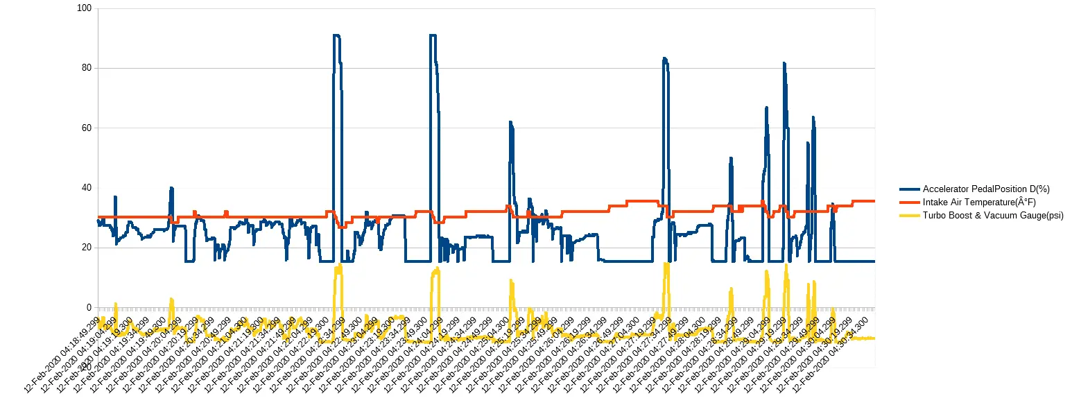

Graphed a log from my OBD during a short drive I took today. Ambient temp was 30 degrees. I'll log my trip into work tomorrow morning when there's no traffic. Temps should be a bit above 20. Thursday morning temps are supposed to be well below 20. We'll see if theres any difference.
Red = Intake temp
Blue = Throttle position
Yellow = Boost
Red = Intake temp
Yellow = BoostView attachment 222758

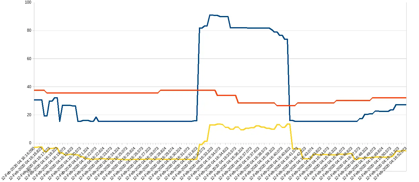

Software I'm using is Torque Pro on my Android phone. This is from a stretch of road where speed limit is 70 so I can gun it. Just for reference. Again, Blue is throttle, Red is intake temp. Yellow is boost/vacuum. Max boost was 13.49psi, though graph makes it look higher, not sure why.

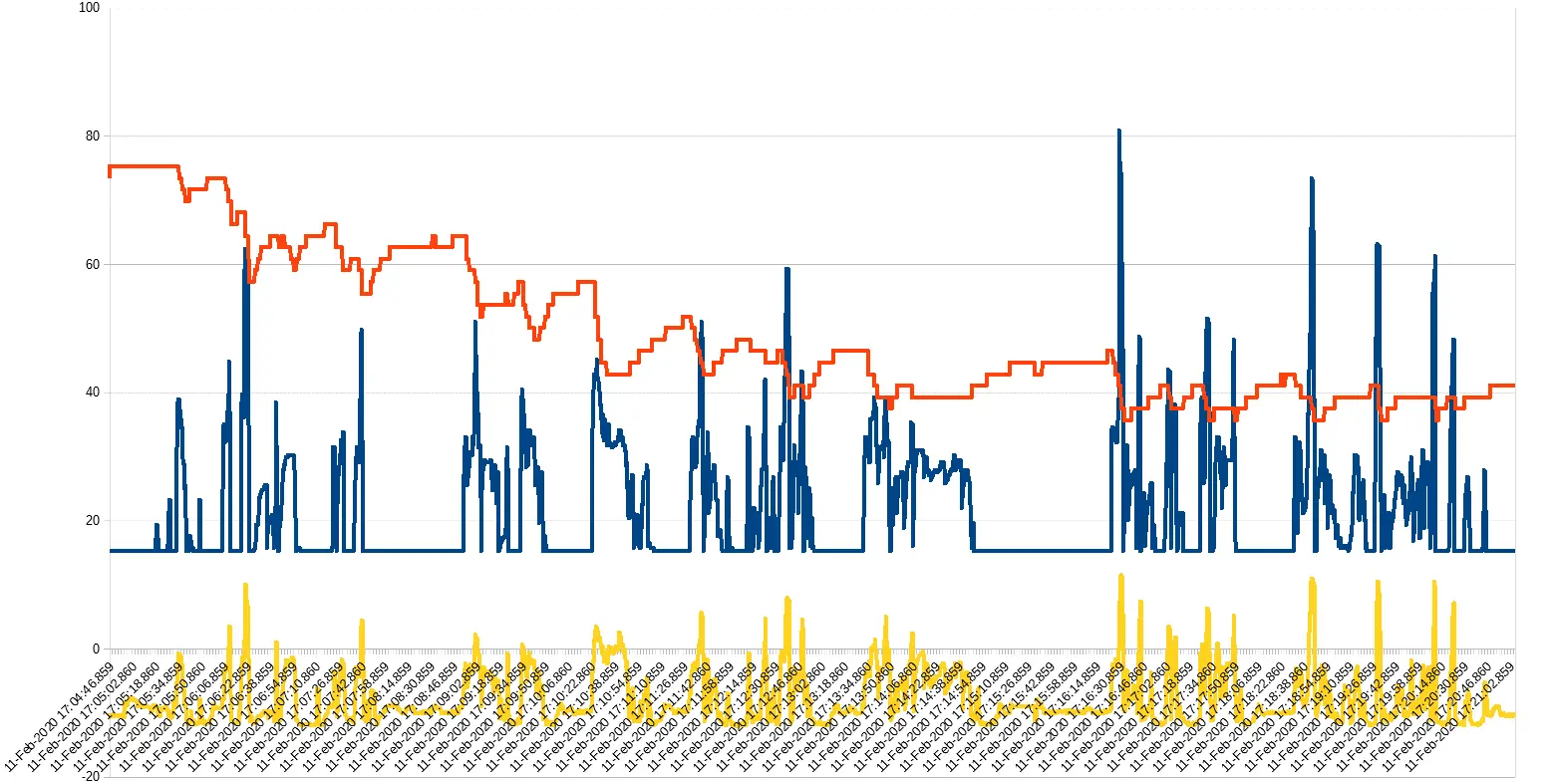

This is the rest of the drive to work this morning. Punched it here and there.

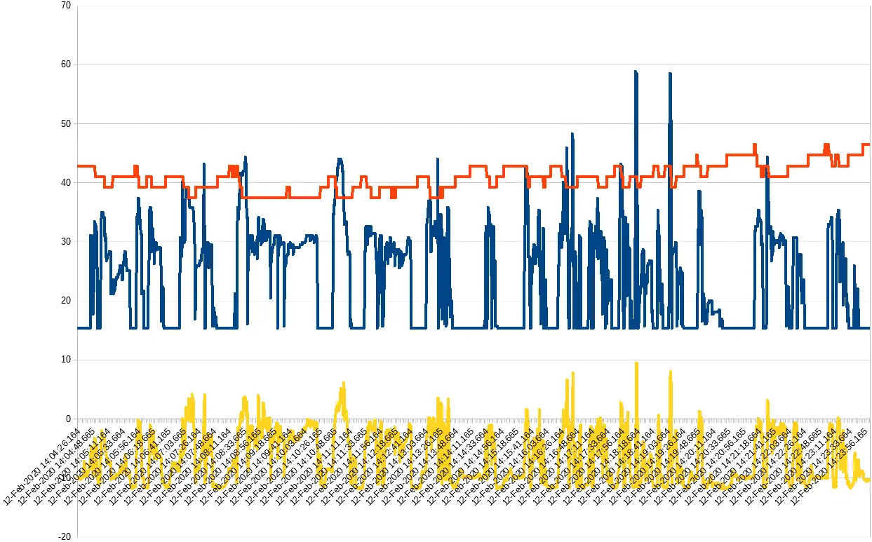

And finally my drive home, just driving regularly.
I can graph just areas around acceleration if needed. And there also all kinds of other sensors, but it can throw the scale off and I'm not good enough with spreadsheets to know how to do that, lol. Like if I put RPM on there, the others all just look like straight lines, I don't know how to put just that one column on another scale on the other side of the graph.

I would just log the WOT acceleration runs. Actually, if you can datalog on the same roads at different weather temps, that would very interesting data to look at.
