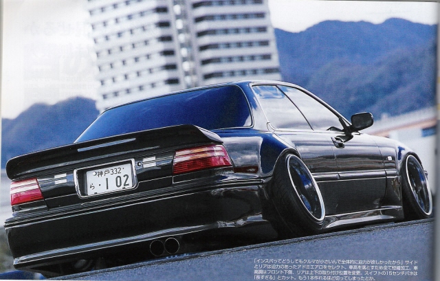

Hell no. Unless you roll with like -10 degrees of camber.
