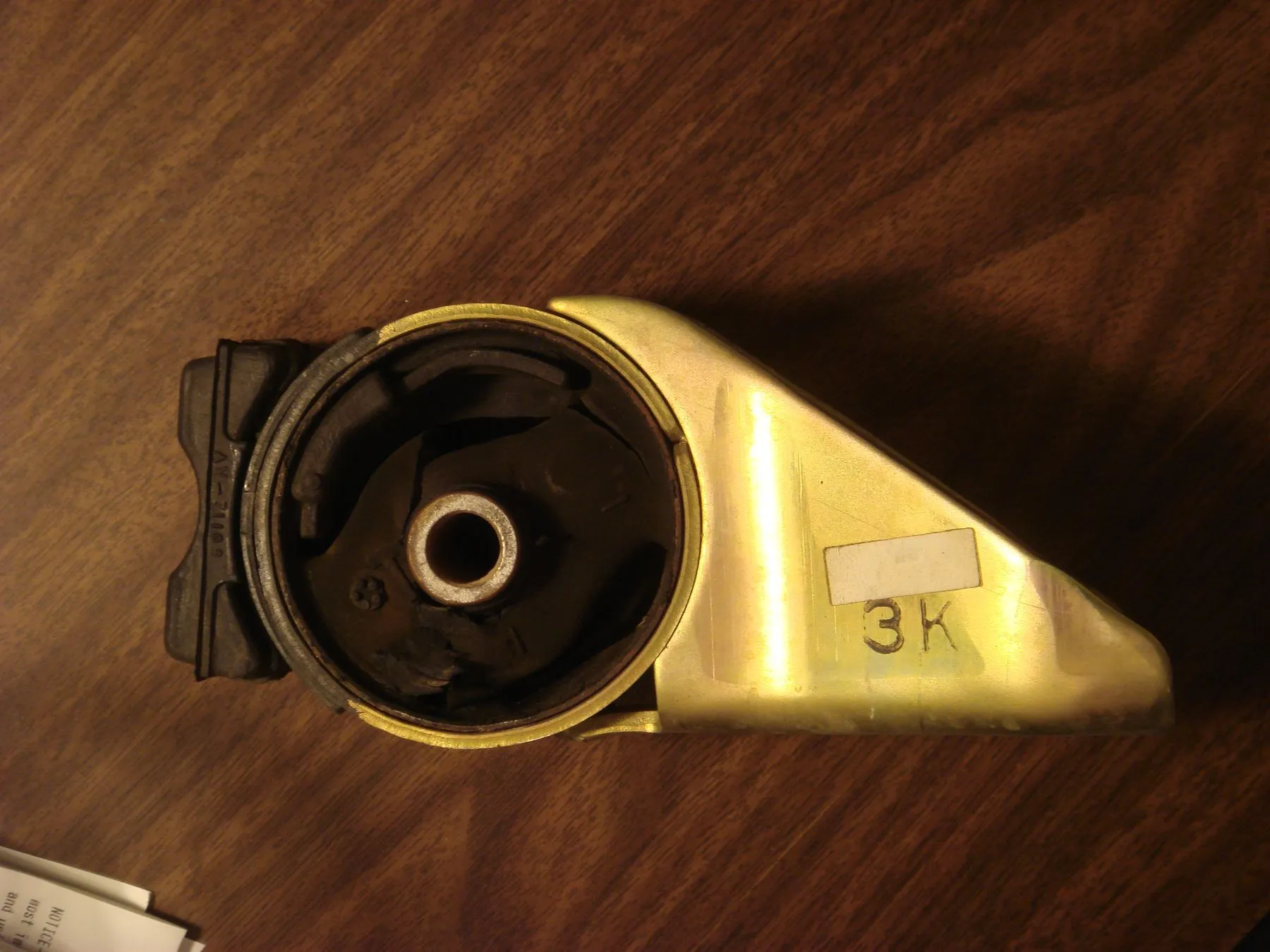

Here is the rear one that came out:
well going from a broken mount to a performance mount is certainly going to take some getting used to.
