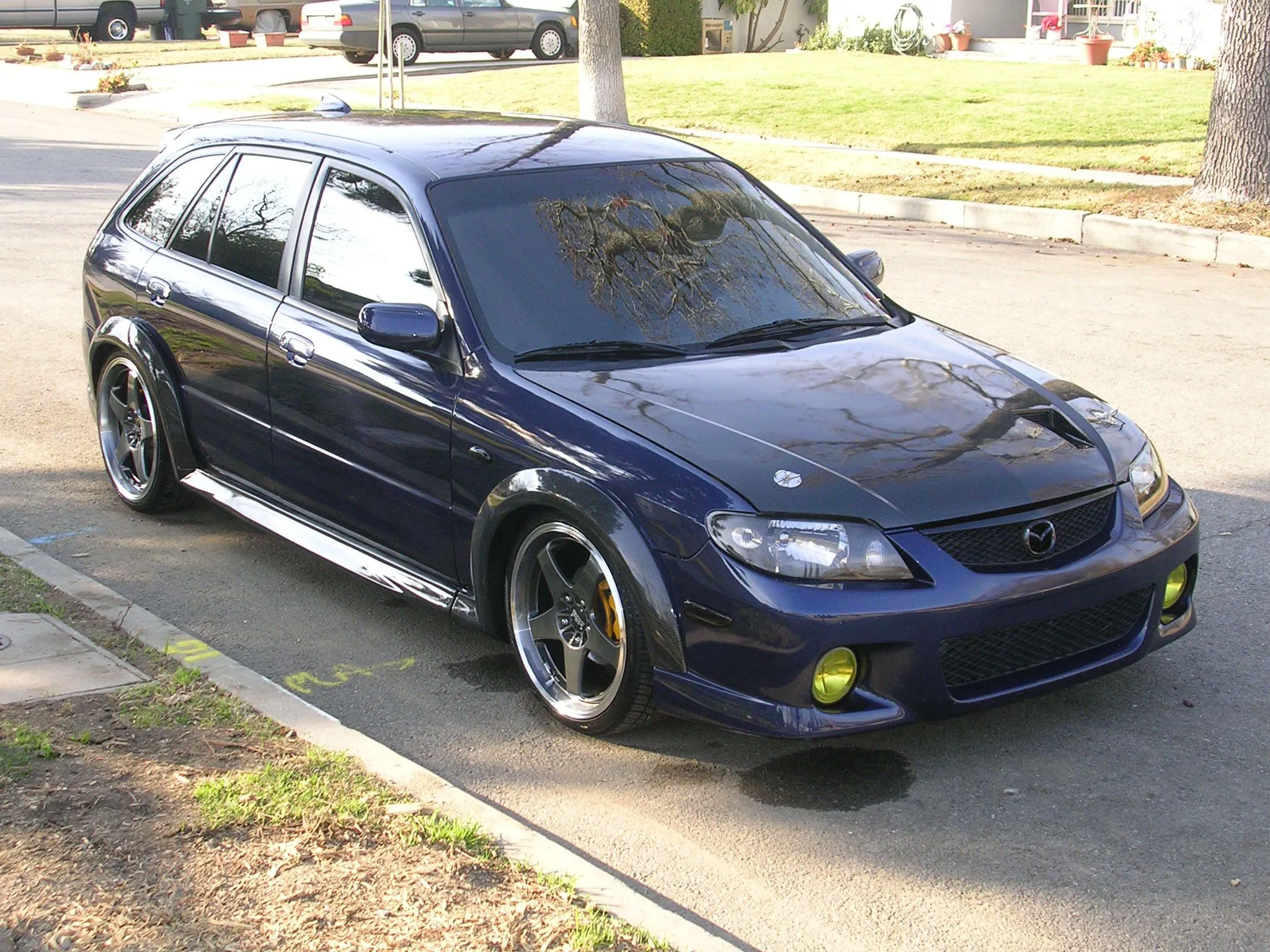

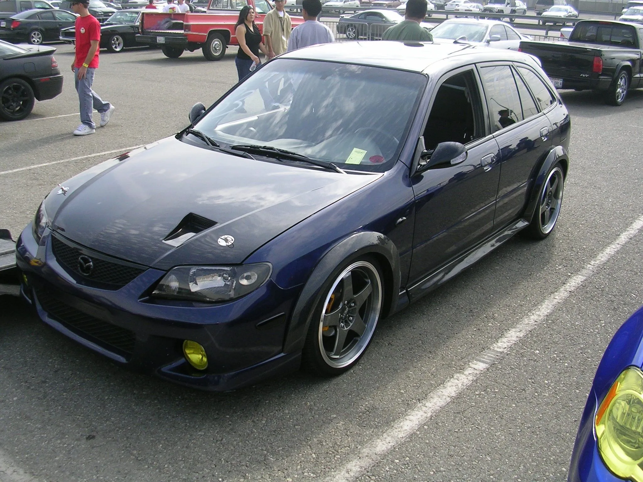

Will ES Headlights fit on a Protege 5????
Yes they will. At Protegefest 04 I saw a green P5 that had sedan headlights in it. They also made a truck out of the P5 as well.

Yes...
