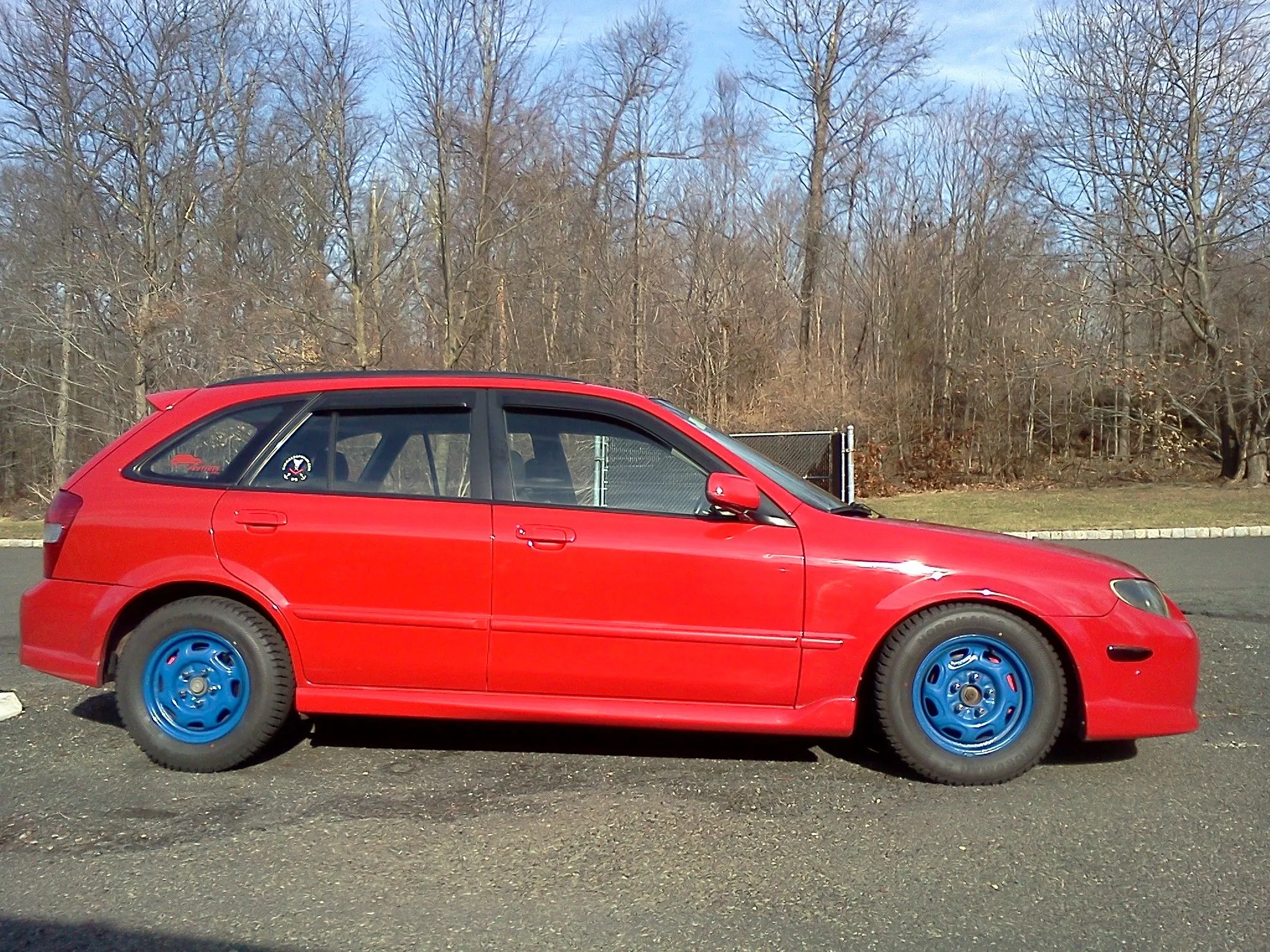

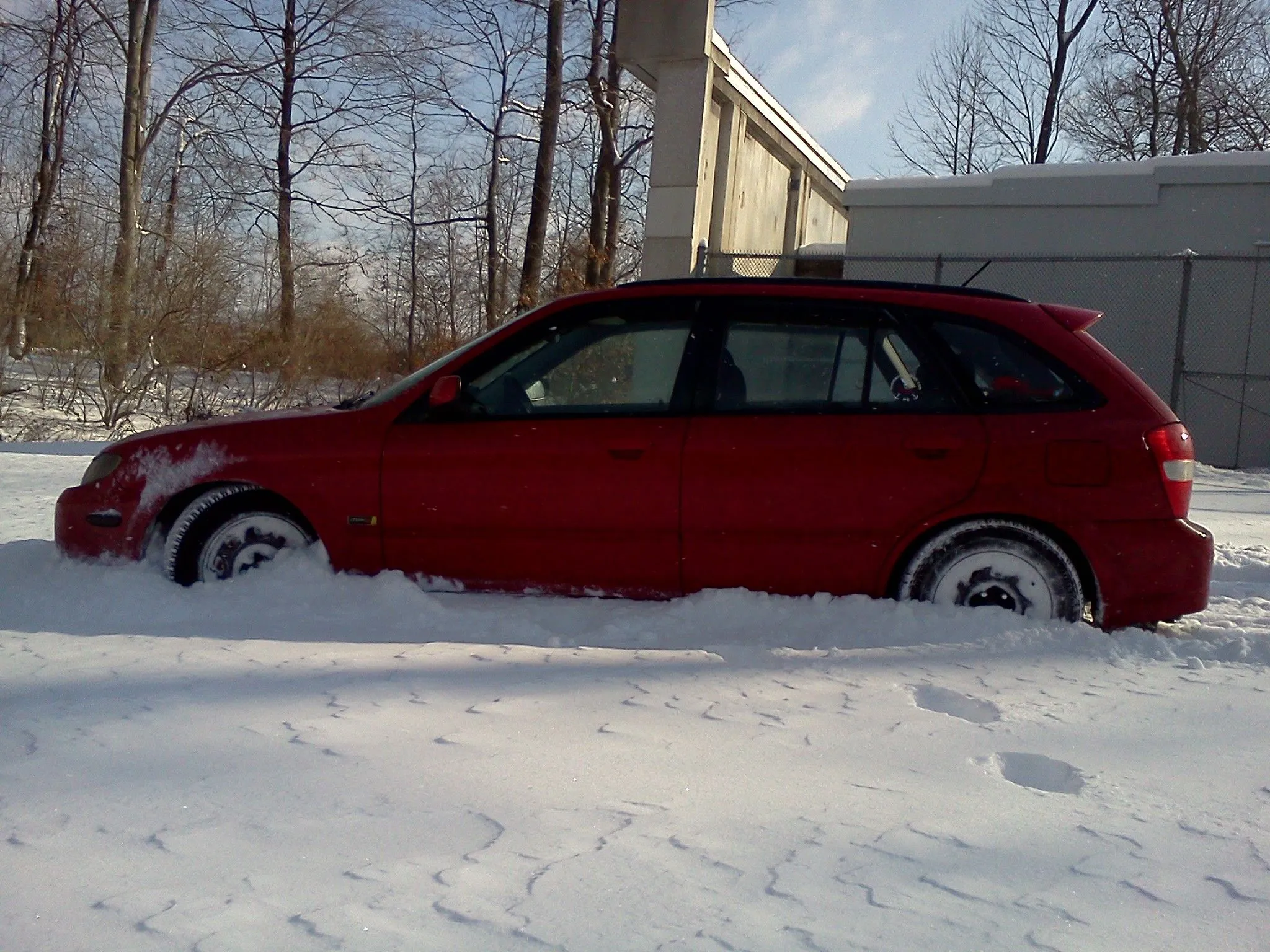

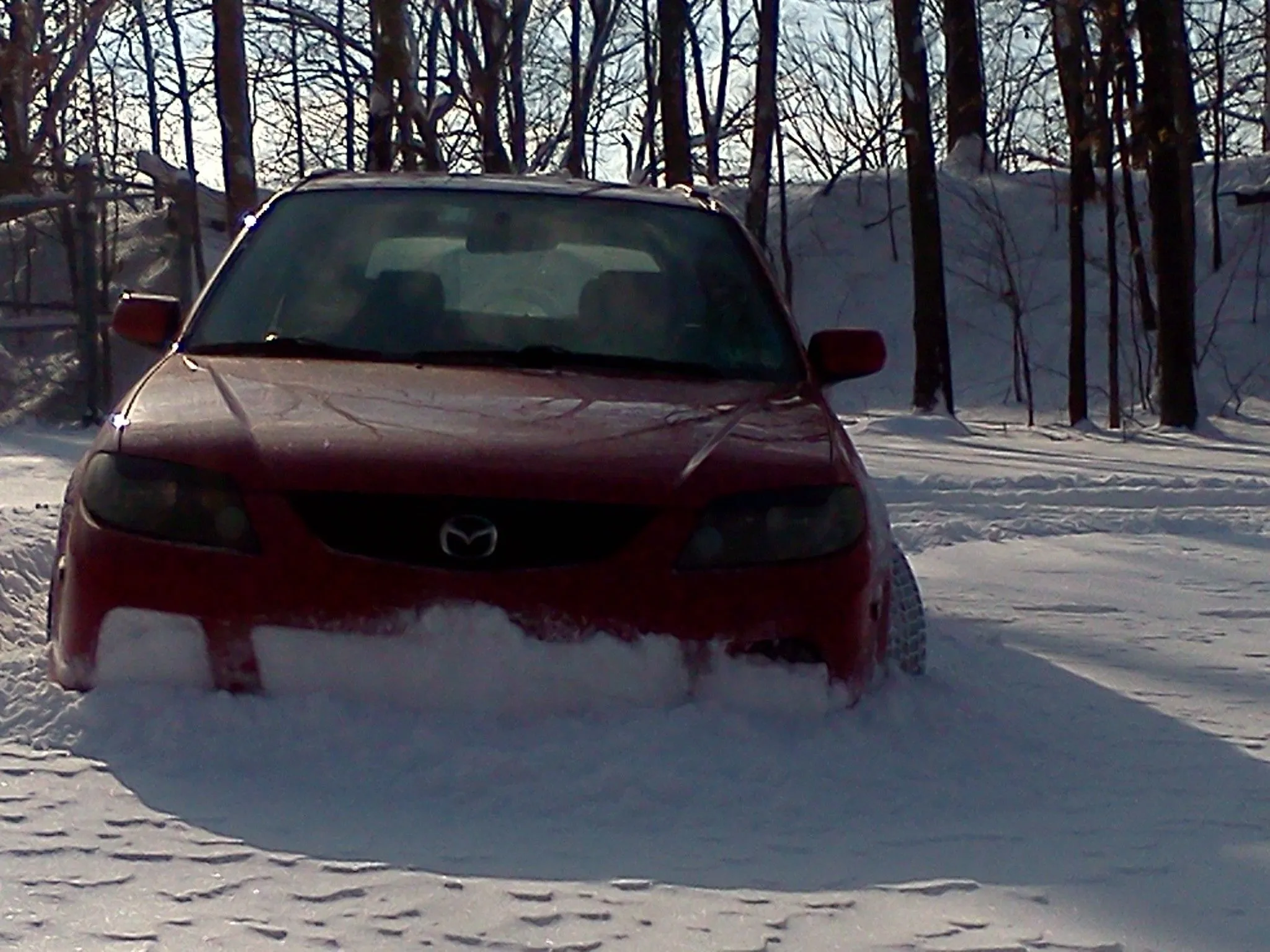

They will, just have to watch the offset to clear the brakes. I'm running steelies from a 1993 Eclipse (14x5.5 +35) that I picked up from a junkyard. 185/65/14 is preferred but you can also run a 185/70/14 with no issues at stock height or lowered. ;) These pics are lowered on Tokico Blues and Tein S-Techs.
attachment.php
attachment.php
attachment.php
