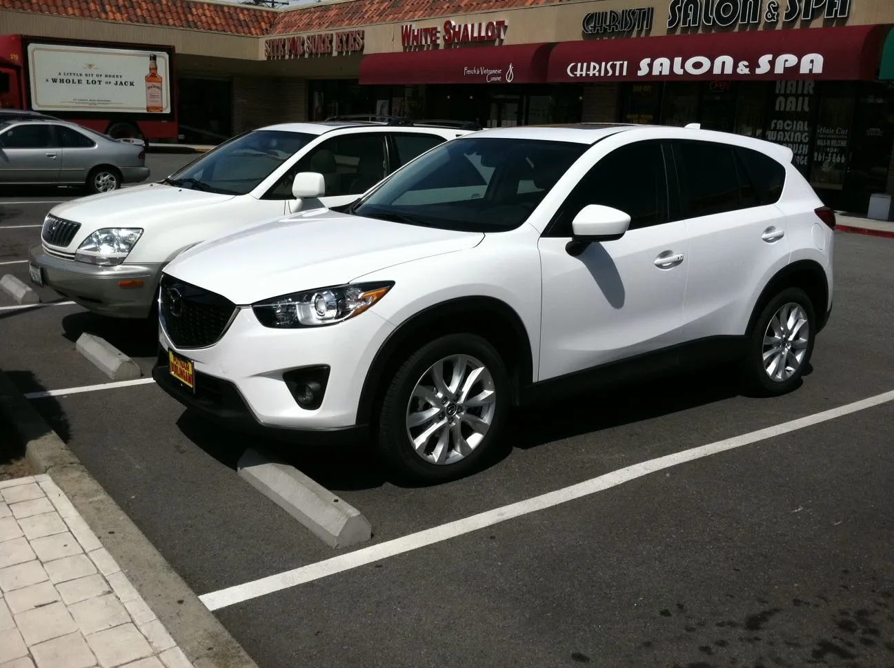

If the diameter of the rim and tire are the same for both for 17 and 19 inch rims how does one size fill the wheel well more? I. Guess I don't get it.
It's just a visual thing, a way of saying that the 19" wheels look better or more proportional on a somewhat large and tall crossover SUV. (The Mazda CX-5 is not really that small and is nearly as large as a mid-sized crossover SUV of 15 years ago). You are right, tire diameter is nearly identical for 17" vs. 19", don't get hung up on the actual measured difference in tire diameter which is insignificant.
I see other reasons why the 19's look better visually to many, not just the larger diameter being more proportional, but also the design of the spokes and wheel itself is a bit more interesting (with curves and some depth). The way the spokes extend nearly all the way out to edge of rim also creates the look of larger diameter (a bit of a visual trick common in wheel business), the 17's spokes do this too.
