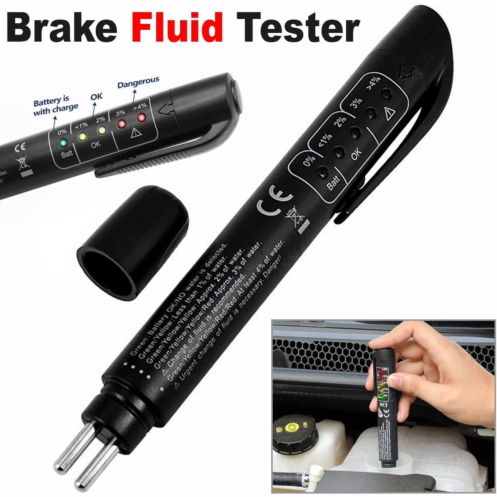

Since car manufactures never specify replacement interval for brake fluid in the US, we can simply get this brake fluid tester (less than $2 from China!) to verify if the brake fluid really needs to be replaced.
Unobtanium's dealer tested his previous 2015 CX-5 at ~100,000 miles and told him his brake fluid needs replacement as the fluid contains 2% of moisture. My 185,000-mile 1998 Honda CR-V was having factory Japanese brake fluid for over 20 years until recent brake pads and shoes replacement, but the fluid flushed out still looked clear, and I have never had any brake fluid related issues before the fluid replacement. (knock on wood)

That brake fluid tester is a joke. Ive used it several times on a brand new unopened bottle and it was giving me a false positive for moisture. Ive thrown it in the bin. The only true tester is a boiling point tester. Just stick to a 2yr interval and youll be alright. I work as a mechanic and thats what I do.
