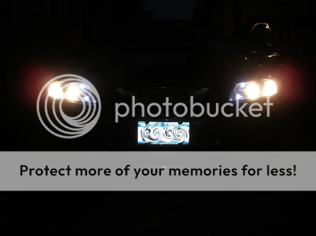

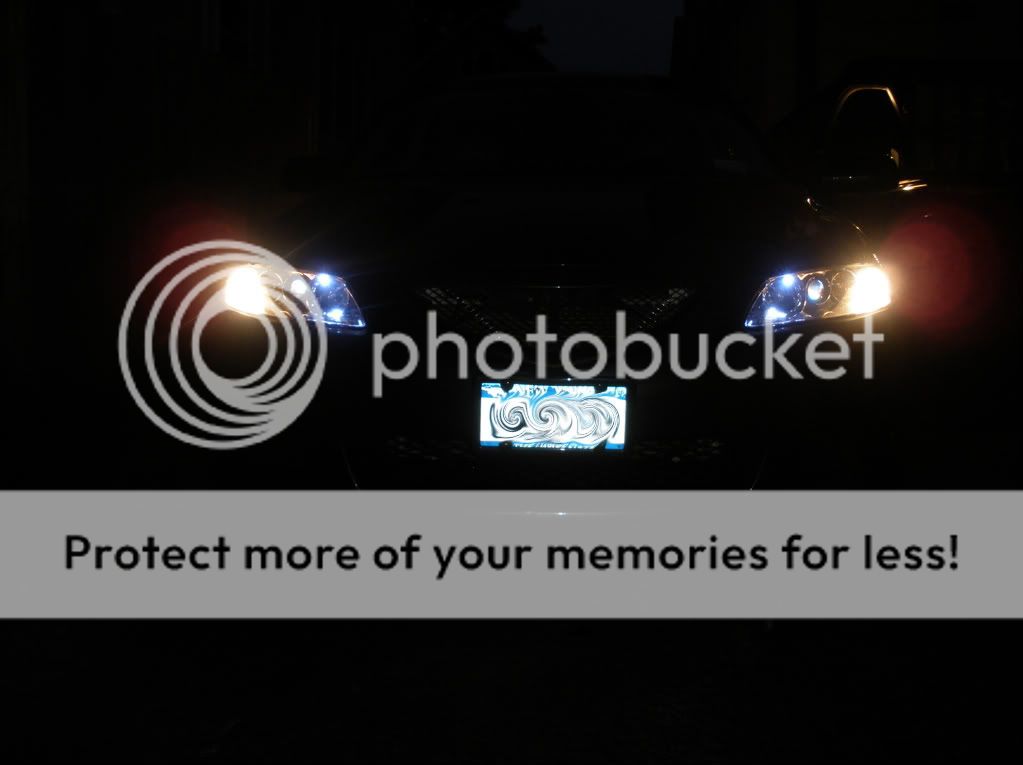

After installing the LED bulbs
I am very satisfied with these and will be replacing a lot more bulbs on the car with them, anyone know which bulbs to get to replace the reverse lights?

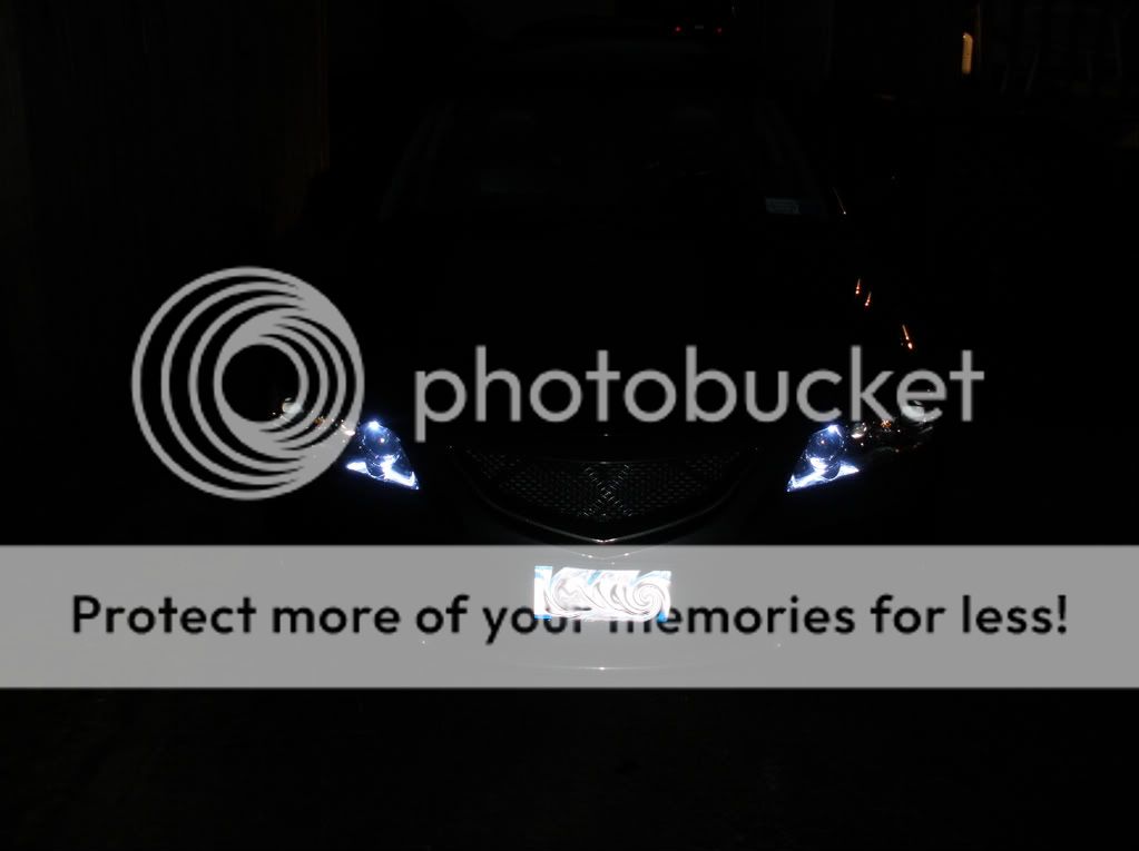

Here's my review thread... I haven't tried the Tower III in my headlights, but the II works GREAT.

Spent a bit on bulbs have we lol Looks great tho, think i'm going to order the same
lol, yeah, I spent a bit more than I needed to, but I really wanted to make sure the ones I was getting looked good. In the first order I just got one of everything to test. :)

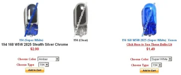

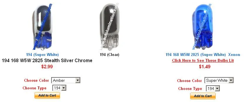

tunersteve, I'm still a little reluctant to try the reverse or tail bulbs. A friend ordered some at the same time I did mine and he tried a few different things, but nothing that worked really well IMO. The reverse ones he got looked great, but they didn't put out as much light as the stock bulbs, and with my tint, that can be a problem. The only thing left I might try is something like the stealth silver or super white standard replacement bulbs from autolumination in the attached pic. It's hard to find an LED bulb that's really bright enough to be practical.
I had some awesome LED reverse bulbs on my Protege, but they were a different bulb base. Even with 5% tint at night, I could still see much better than stock. They were about $20 each, but well worth it.
Hmmm. I just took a quick look and there is a version of the Tower designed to fit our "921" reverse lights. I just don't know if it would put out enough light. The 921 is a wedge type bulb too, so the 194s that I have now may fit, which I'll try to check this week, just to get an idea of the light output.
